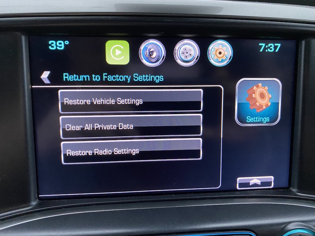

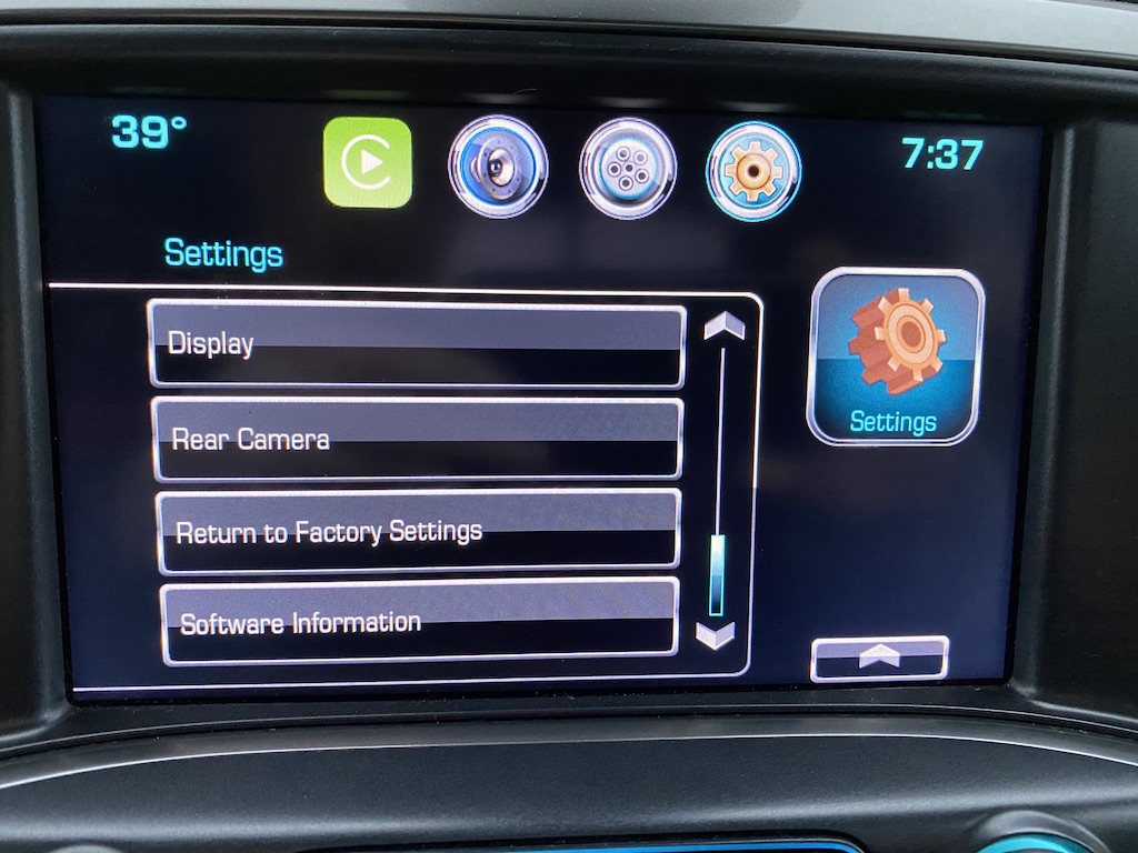

Last week I posted in this thread about having issues with nothing at all happening on a 2016 Silverado, but having it work in 2015 Tahoe (with 2017 infotainment hardware).
The Tahoe always had issues with steering wheel controls totally not working with my wife's iPhone XS, but working with my iPhone 11.

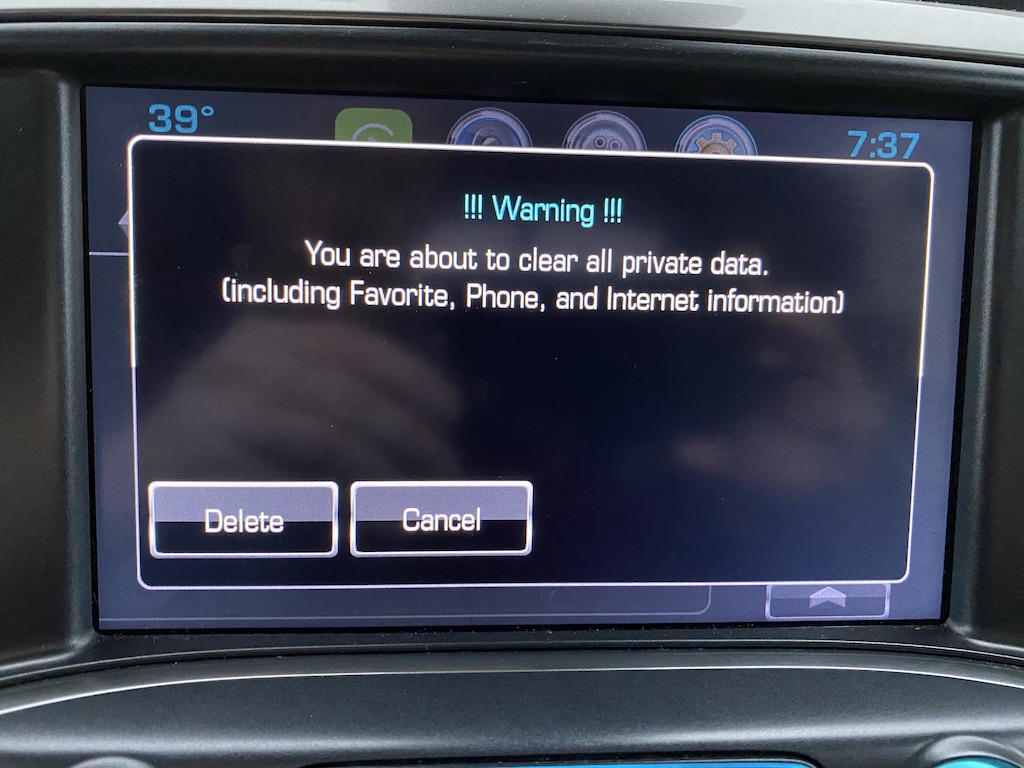

I spent an hour in the Tahoe with her phone, and found "Settings -> Return to Factory Settings -> Clear All Private Data". Suddenly the steering wheel controls started working again with her phone.
So then I figured let me go try this in the Silverado and try the Carplay2air adapter again. Boom, it worked instantaneously!
FWIW, here are the settings screens:
