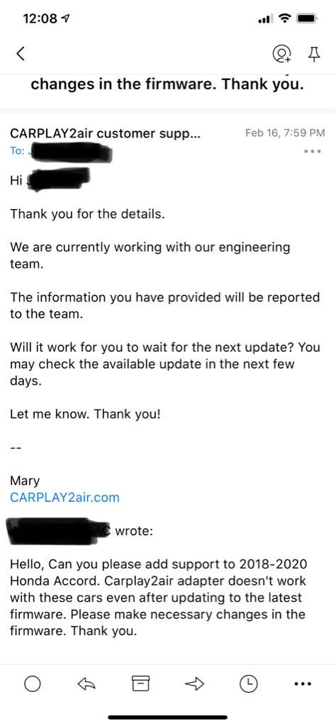

Still no luck with 2018 Honda Accord Touring.

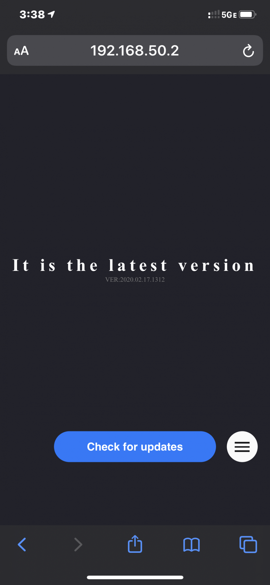

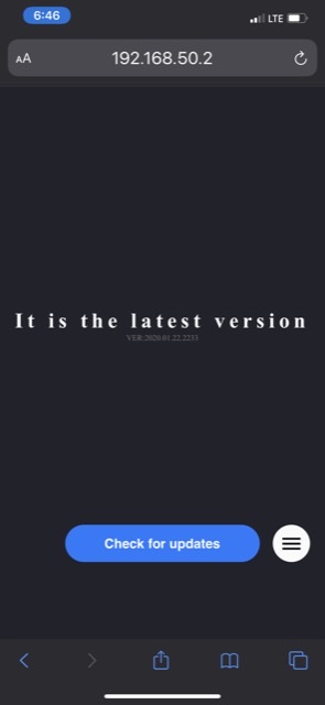

Has anyone been able to update to the 2/17/2020 firmware OTA without using a USB stick? I'm curious what the release notes say has been fixed in the update.
At this time, the actual OTA version is 2020.01.22.2233
the 2020.02.17 Version is an unofficial version without a changelog (current status 😉 )
So I was able to update to 2-17-20 via usb formatted fat32. No OTA updates worked.

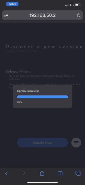

Anyone upgraded Carplay2air to February (February 10th/11th/14th) firmware?
I just did.

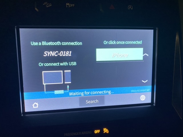

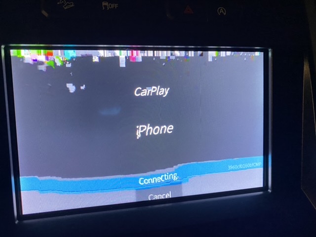

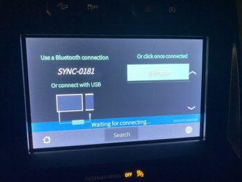

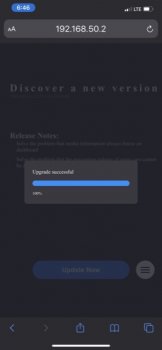

So I finally got it to work in the F150. Pretty much I thought it was freezing on the connecting screen but was getting music to play example attached. I was already in the 2.0 software, so i decided to try the IP address that is in the instructions. Once I did that it said an update was available and it updated and started to work. Steering wheel volume and song changes work with no issue. I have attached the screen shots as I went through everything.
