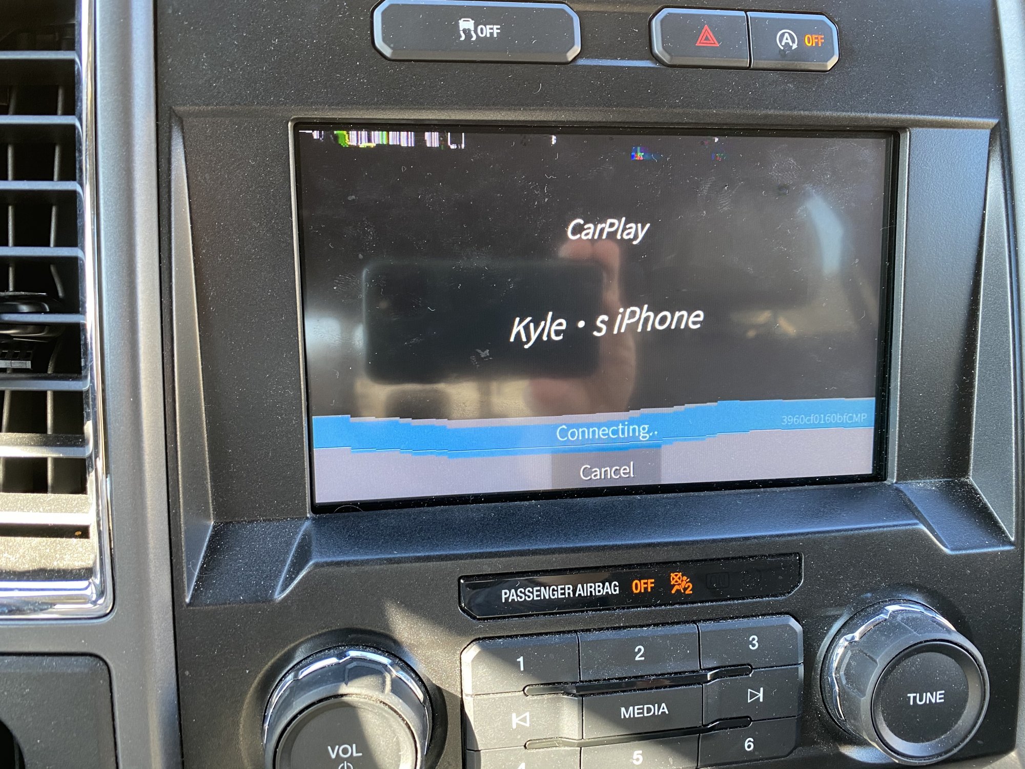

I was able to get my carplay2air unit to be recognized by my infotainment system today after finally updating from Ford Sync 3 v 2.2 to 3.4, but I can’t get further than the initial connection screen (which starts to warp as shown below after a few seconds). Any ideas, anyone?
EDIT: Well, never mind. I updated the adapter to the 2020-02-26 image, "forgot" the SYNC bluetooth connection on my phone, and then the CarPlay screen popped right up almost instantly. Not sure if it was an issue with old firmware, or my bluetooth connection to SYNC interfering with the wireless CarPlay bluetooth/wifi hand-off, or both, but it works now. Have a road trip this weekend, so I'll see what the battery impact of running Waze for 4-5 hours is.

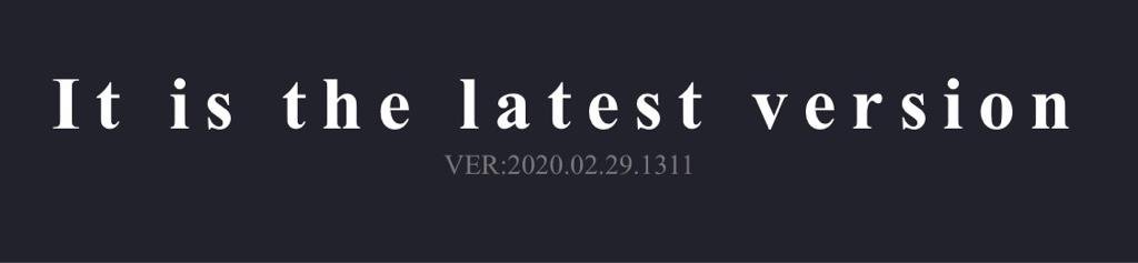

The last OTA update was on 2020-01-22, and you can install the file from 2020-02-29 via USB. What now? Are there no more OTA updates?
Maybe they are having issues with their OTA update server, just as there have been issues with their activation server. Everything worked in late January prior to Chinese New Year. Then, during the holiday the Corona virus thing exploded.
Just a wild guess.
I thought these were possibly beta versions not released yet- is that incorrect? If it is, I am going to flash.
Manual usb update 29-02-2020
In the root Folder there is a file „Auto_Box_Update.img“. The file „U2W_Update.img“ isn‘t there anymore (01.03.2020). Can i update only with auto box file over usb? Or must be U2W img file also in the usb stick?
Seems the file in the dated folder 29.02.20 is gone...
Auto_Box_Update.img files are for older adapters that are on the previous firmware scheme. Once you're on v2, you need to use the U2W_Update.img files.
You're right that Carlinkit removed the U2W_Update.img for 2020-02-29. I didn't download it but I did see that it was there as of yesterday. I have to assume they pulled it because it caused some sort of problem. So probably a good thing that you didn't flash it. If you already have the previous update installed (either 2020-01-22 or 2020-02-17) then it's probably best to just wait for them to post another U2W_Update.img file.
