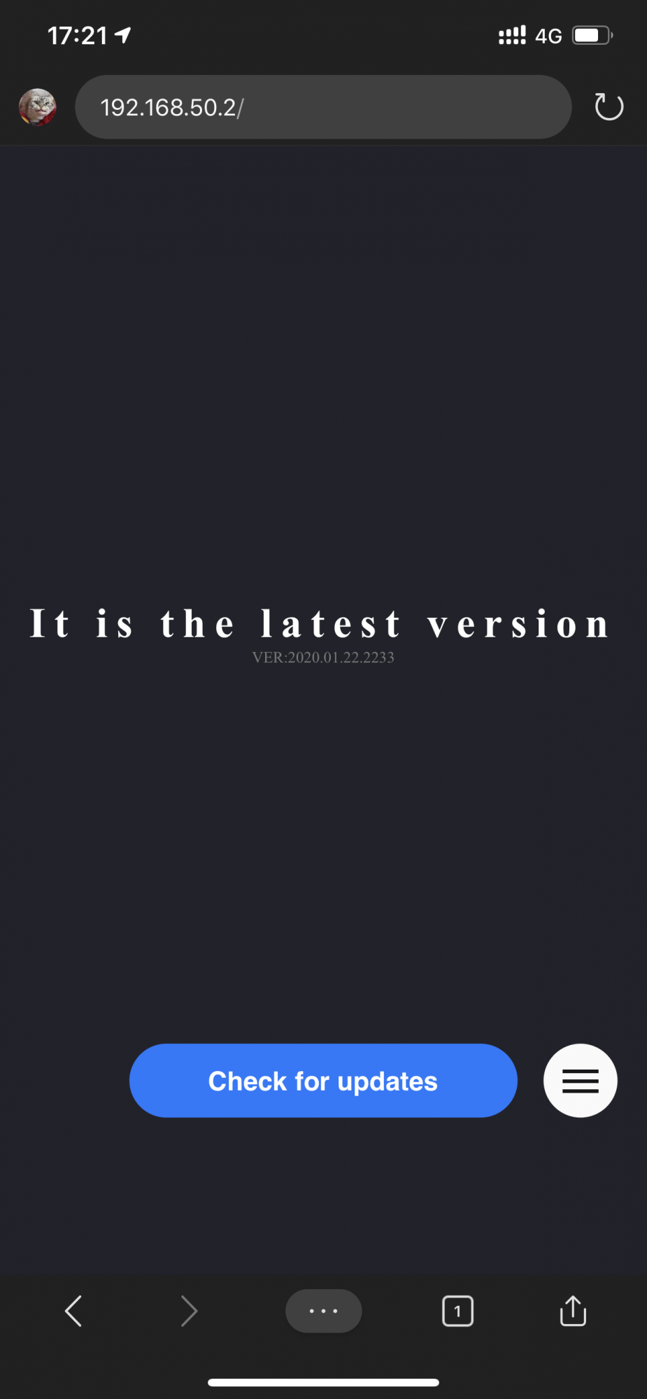

Its running the most up to date OTA which AFAIR was 22 Jan.

It's definitely not as I have a V1 dongle on the same latest OTA firmware and the buttons dont work. I did some diagnosis with D3ggy and confirmed the newer dongle is definitely different somehow.

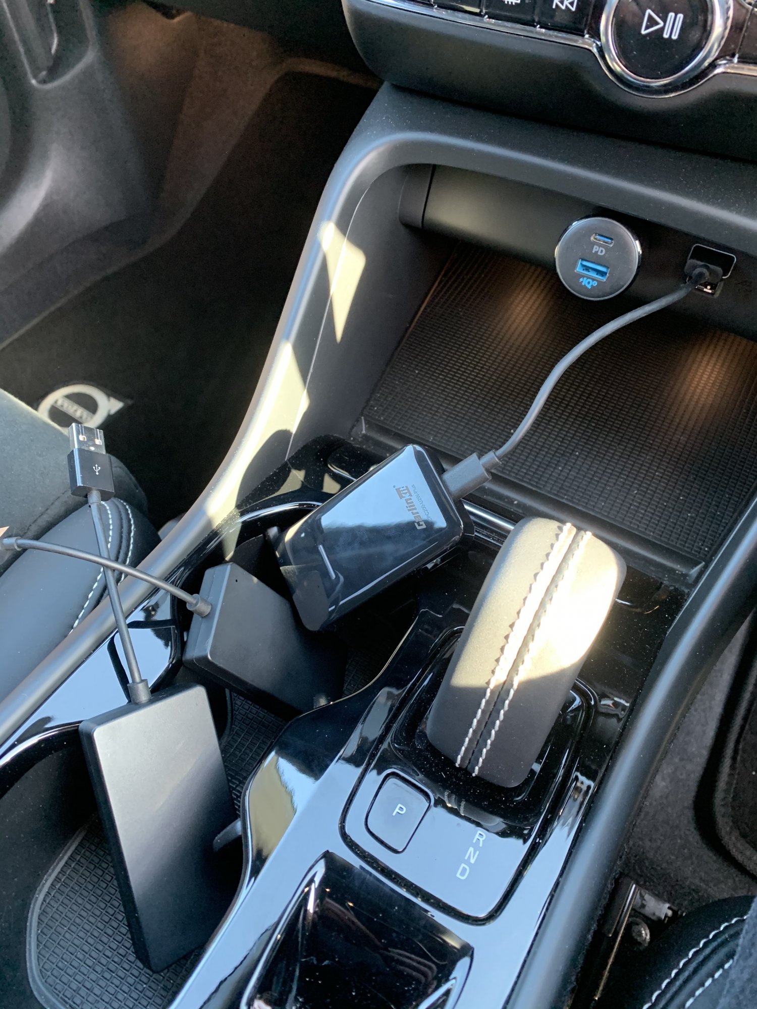

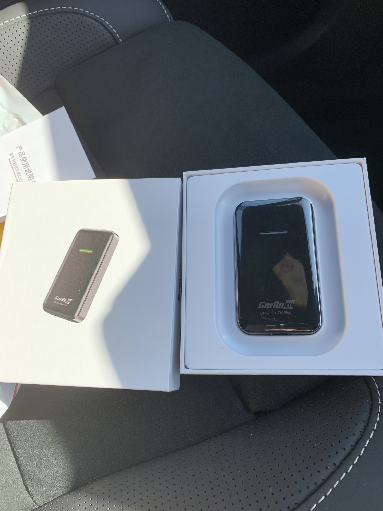

Photo of it
[automerge]1586880592[/automerge]
And another
Reactions: phantom25

Thanks for this. Interesting for sure. From the pics, it looks like the new one is actually bigger than the old?
