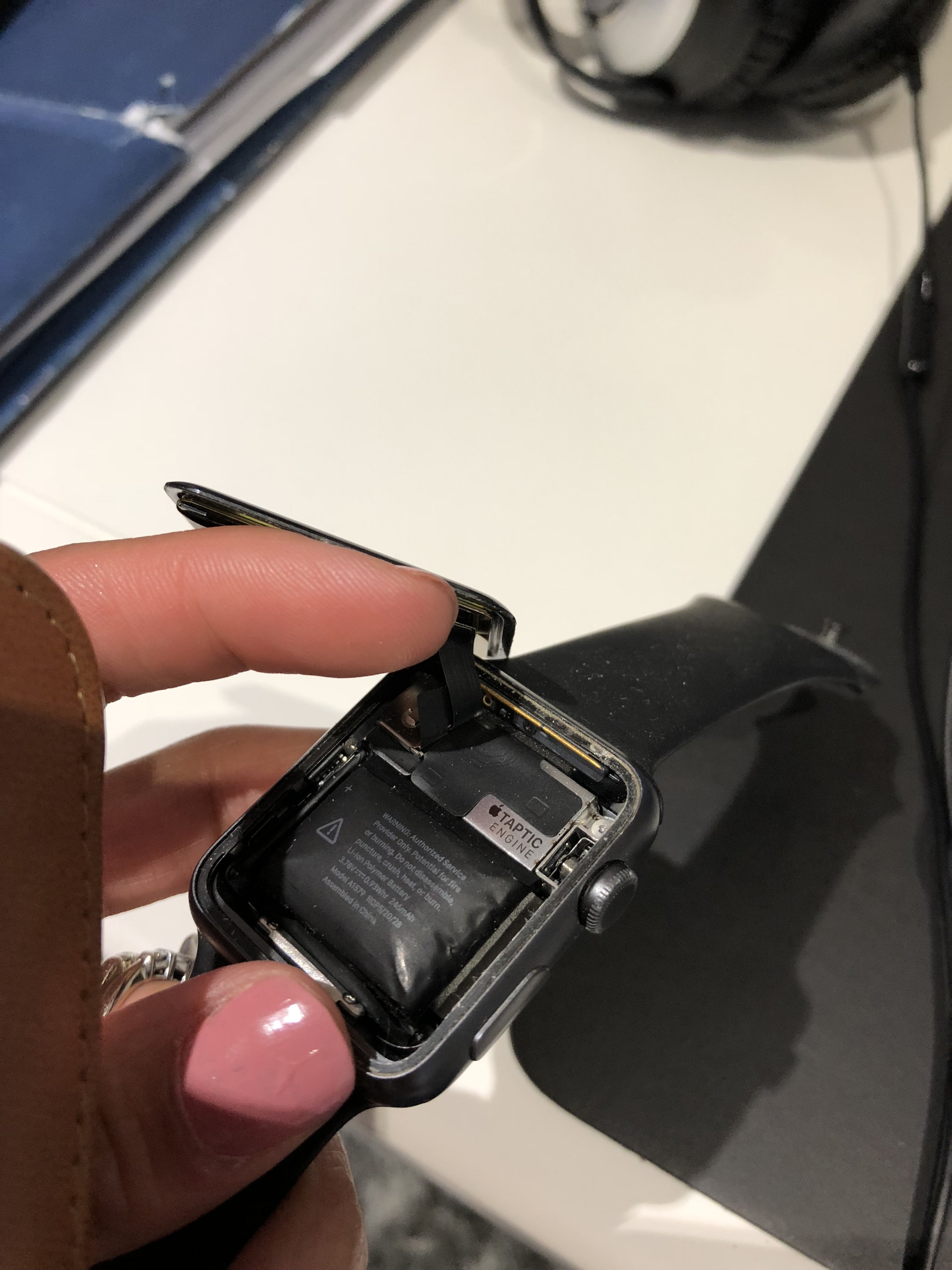

My wife’s original 38mm SS did this last year. Owned since launch so out of warranty. Took it to local Apple store (Newcastle UK) who were superb, took a good look at it, determined a swollen battery to be the cause, explained that it’s out of warranty and then give her a replacement unit free of charge. Said it’s out of warranty but clearly a manufacturing defect and that was that. If Apple are willing to replace them like this then why the law suit?

The main reason that these watches have 'self detaching' faces is from the use of glue. Glue holds the watch face to the metal housing and when the watch is charging it produces enough heat to warm the metal housing and evenly soften the glue around the edge of the face, and the right amount of forward movement will cause the face to simply fall off. (I have personally seen it happen/ and have been able to re-create the issue)
The other reason it can detach is from an expanding internal battery, which can apply just enough pressure to force the face off.
Either way, it shouldn't be happening.

Apple has acknowledged issues with swollen batteries in select original and Series 2 models, which can cause the display to pop off, and offered free repairs up to three years after purchase, according to internal guidelines previously obtained by MacRumors. However, the complaint alleges that Apple refuses to extend the free repairs to watches with detached displays but no swollen battery.

They still can try to deny the swollen battery issue too. They did with my second watch. It took me quite a bit of effort and multiple people on different levels at Apple.There was also glue strip failure, which happened to mine. They just fall right off. Apple doesn't give a rip unless you're John Gruber's girlfriend.

They acknowledge the swollen battery issue reason now. They still do not acknowledge the fell off for no good reason issue.
