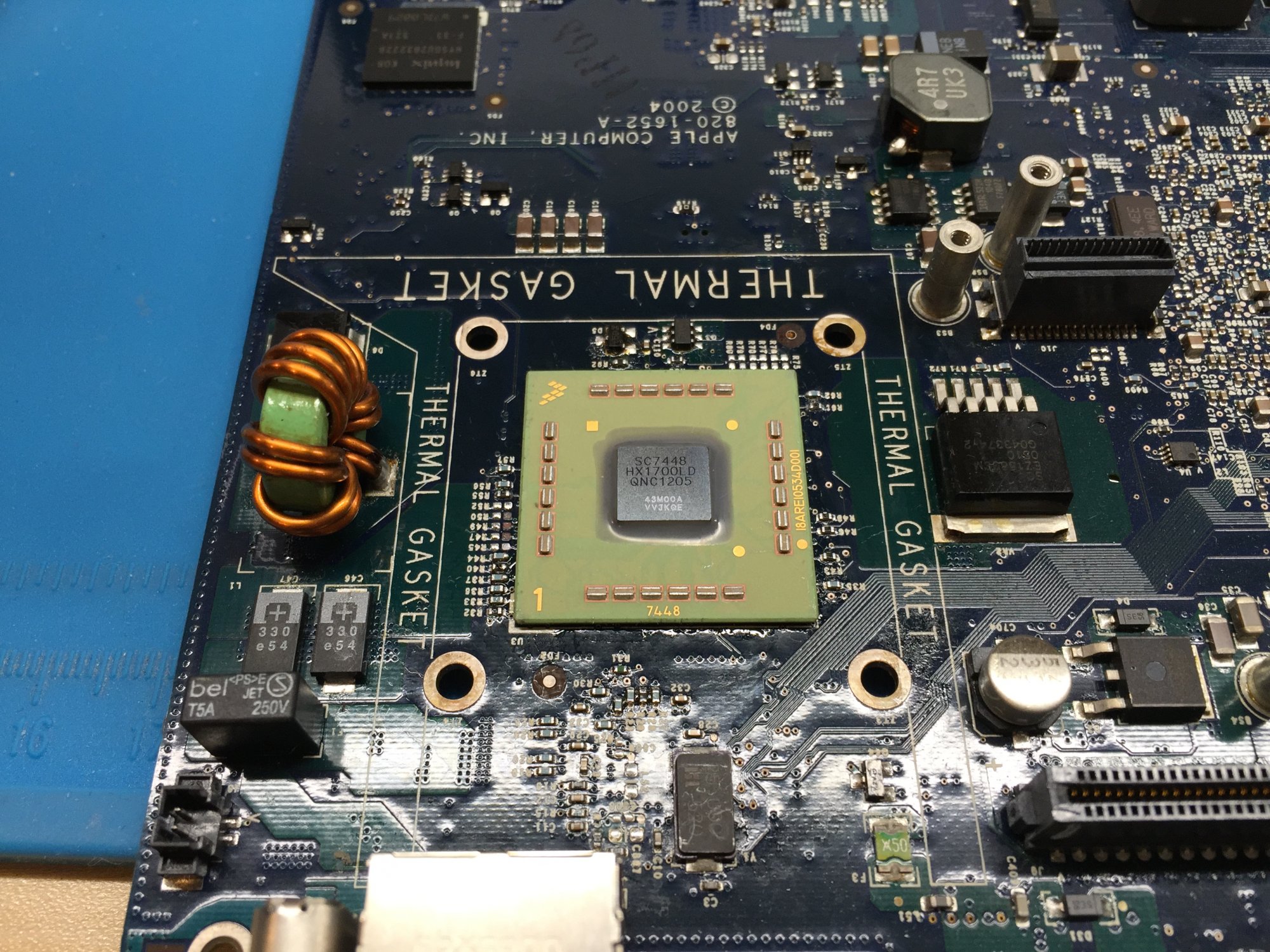

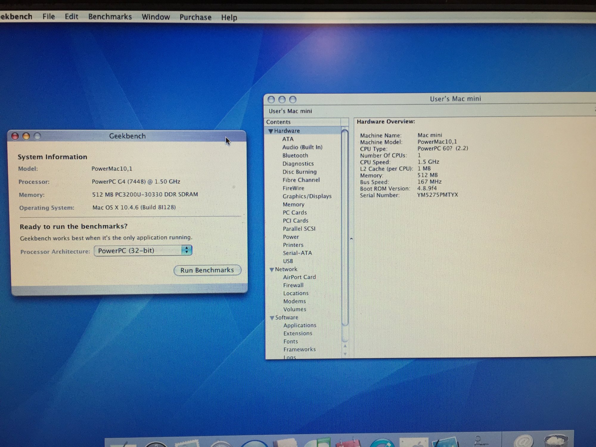

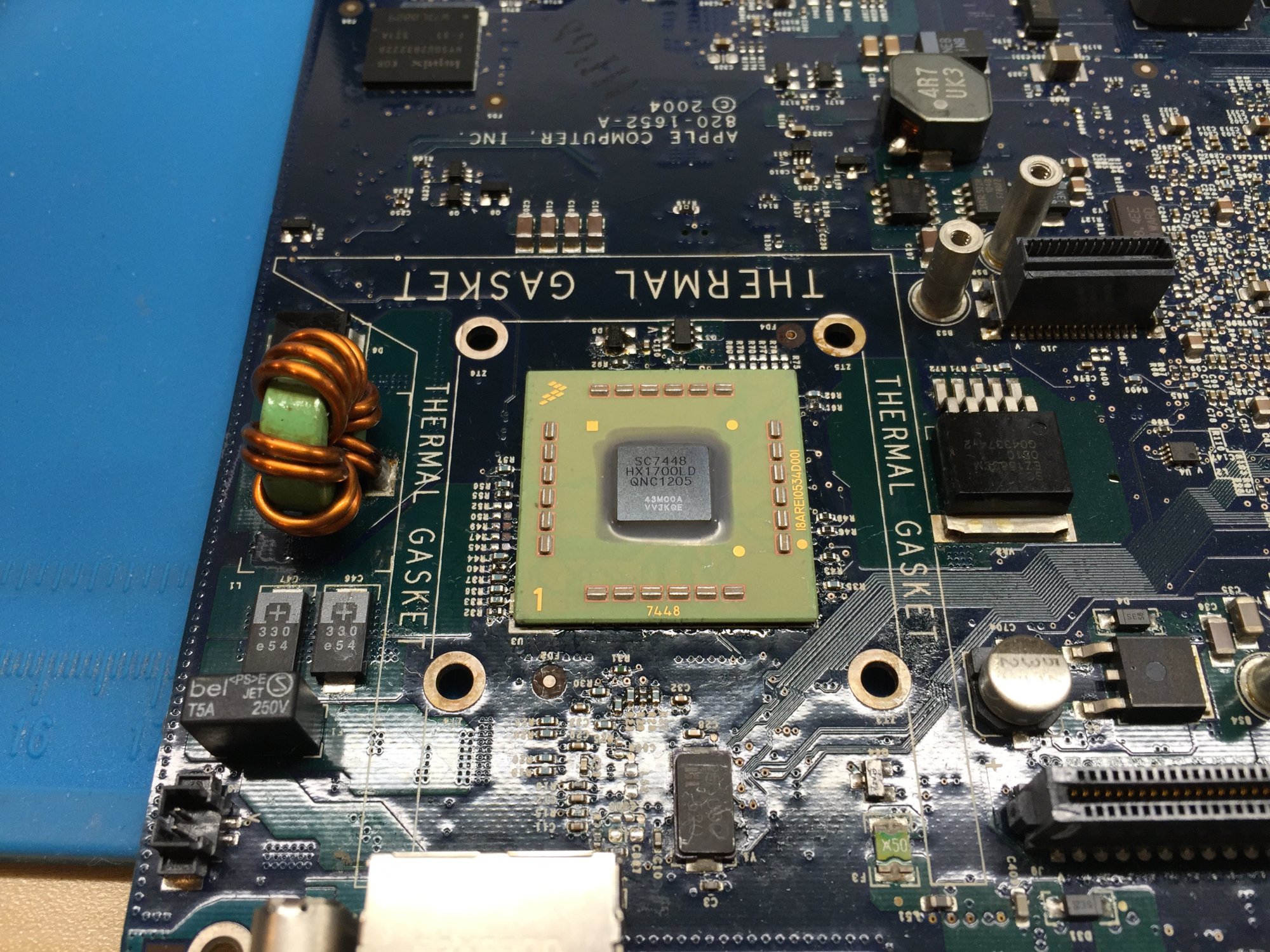

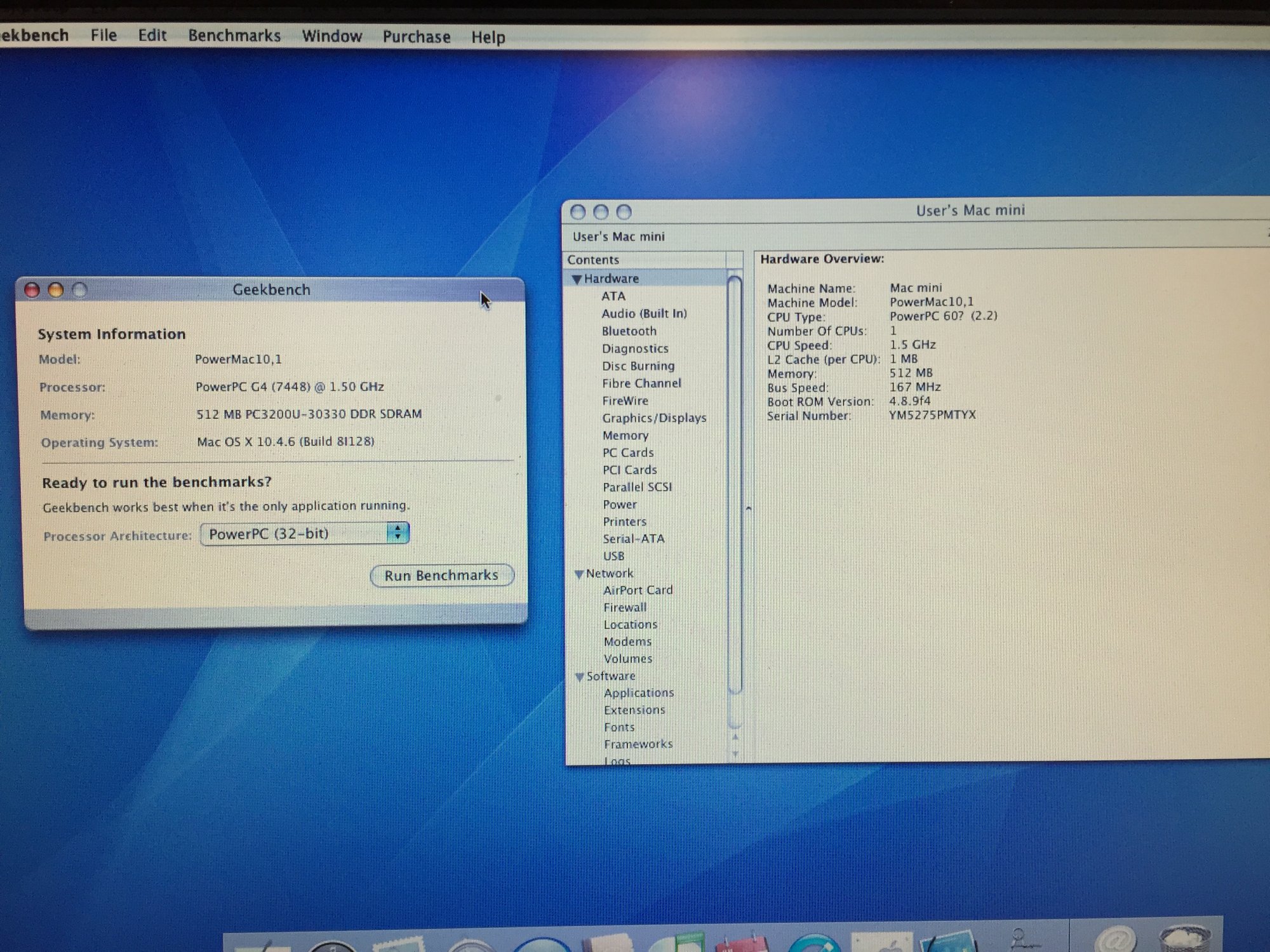

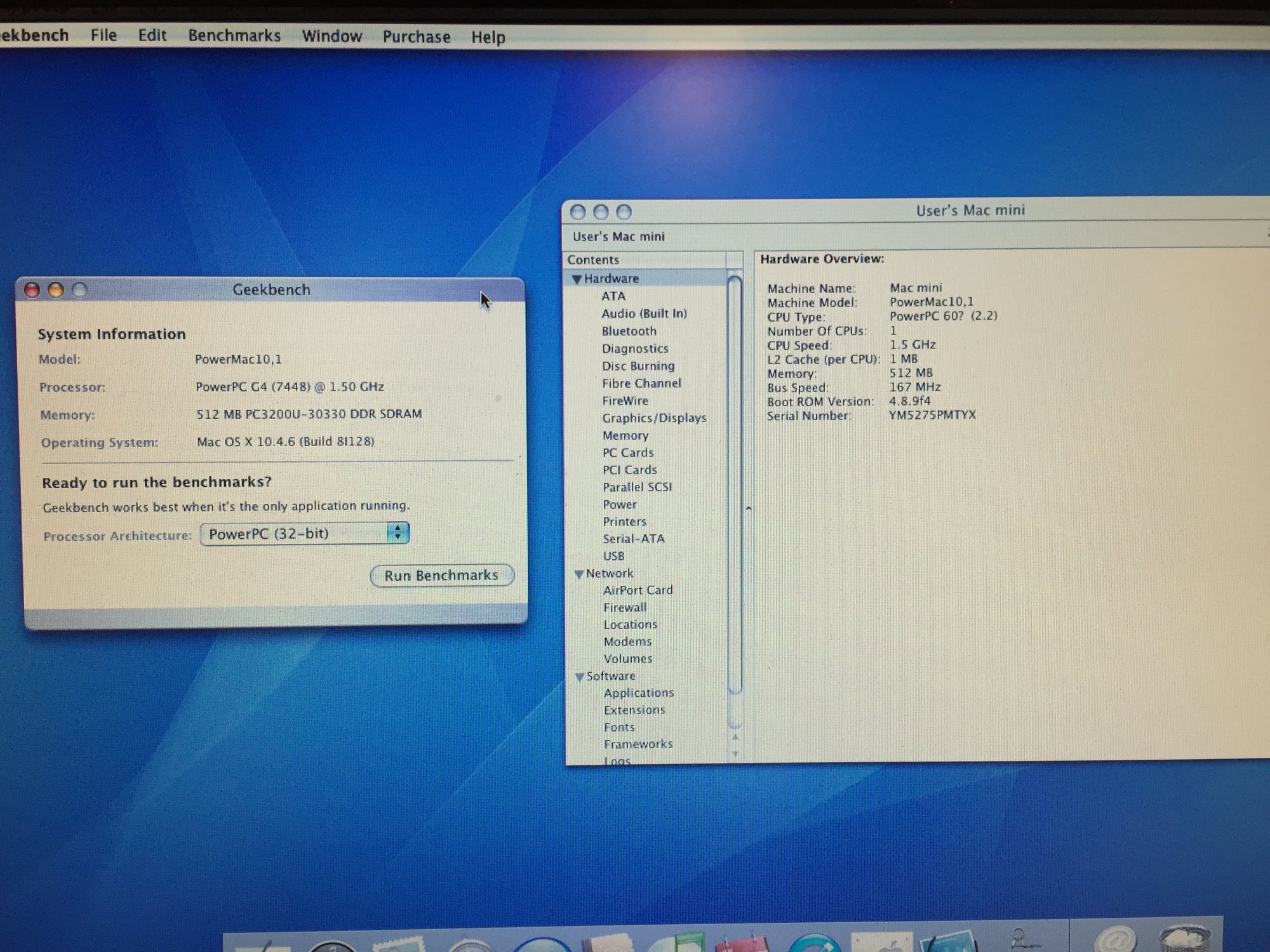

At long last, I finally had some time to test out a Mac Mini G4 7448 CPU upgrade with my patched BootROM. Of course, I used a PowerMac10,1 for my testing, as a PowerMac10,2, as we discovered, does not require any BootROM patches. This, however, is where I ran into an issue. While my patched BootROM works perfectly, the NVRAMRC script needed to boot a stock OS X kernel does not... It simply causes the machine to do nothing but chime, and then sit there doing nothing. Exactly what happened when @ervus attempted on his unpatched PowerMac10,2 system with 7448. So, this script definitely needs to be modified in some way to make this a useful upgrade, with the ability to boot OS X with full CPU support and an unmodified kernel. My theory is that something about the OpenFirmware in this later BootROM version is different, or it could be relying on some sort of offset in the firmware binary itself. Unfortunately, I'm not very familiar with Forth or FCode, but I will see what I can figure out. Any help would be appreciated.

HUGE UPDATE! The FCode binary is NOT THE ISSUE!!! It's simply something with the other parts of the NVRAMRC script, or something to do with the way NVRAMRC is executed in these newer BootROMs. Executing the FCode manually using the boot command in Open Firmware WORKS, and I was able to boot OS X no problem with the 7448 in the PowerMac10,1!!! The binary file to execute is attached, it can simply by executed using:
Code:
boot ud:3,\FCode.bin
"ud" may need to be devaliased first for a USB drive, and "3" is the partition on a USB drive. You could load from internal HDD as well.
Then the system can be booted successfully using mac-boot!
