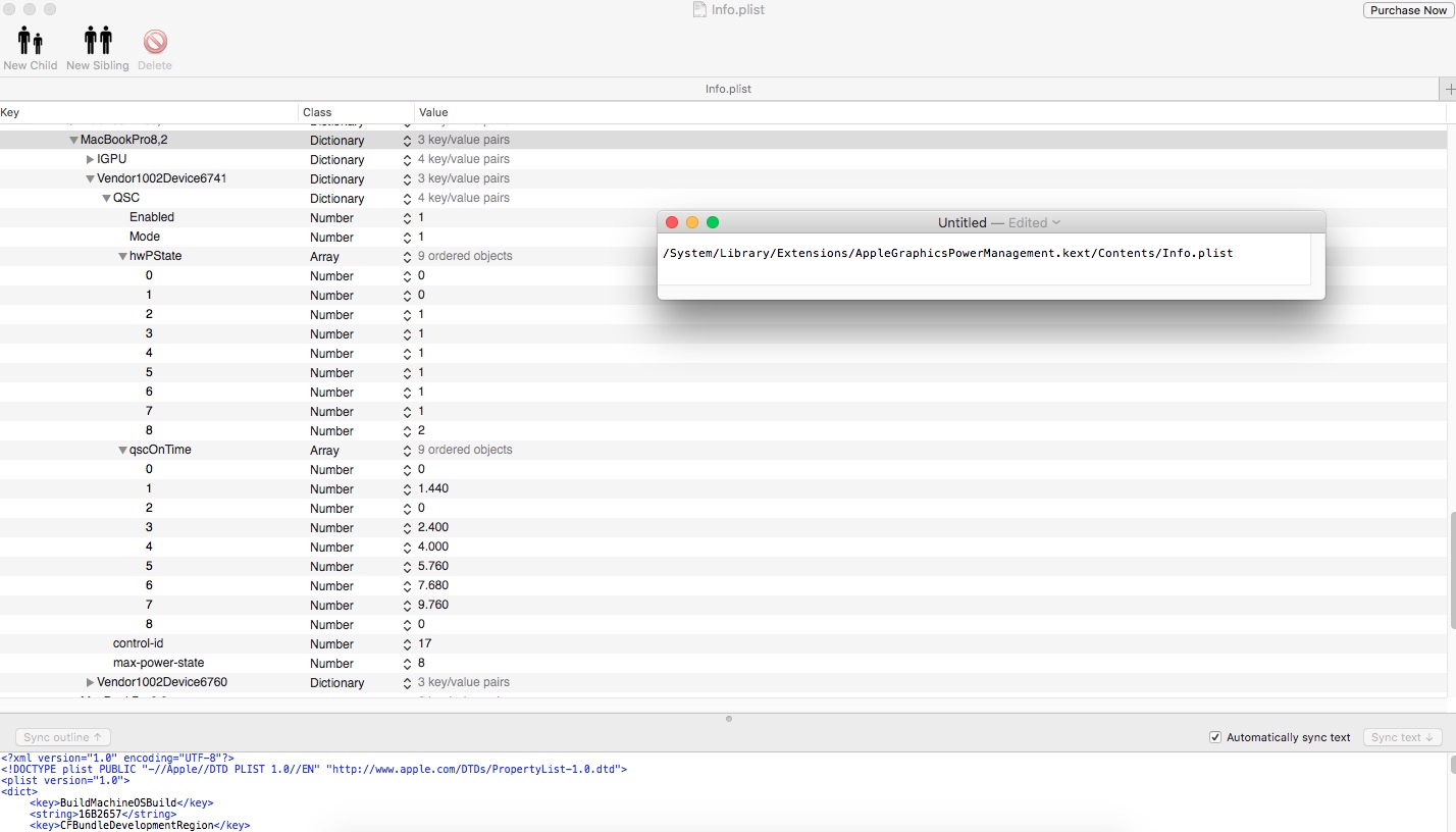

I do not know if this agc in boot-args is connected with the hwPState that is inside:
/System/Library/Extensions/AppleGraphicsPowerManagement.kext/Contents/Info.plist -> IOKitPersonalities -> AGPM -> Machines -> MacBookPro8,2 -> Vendor1002Device6741 -> QSC -> hwPState

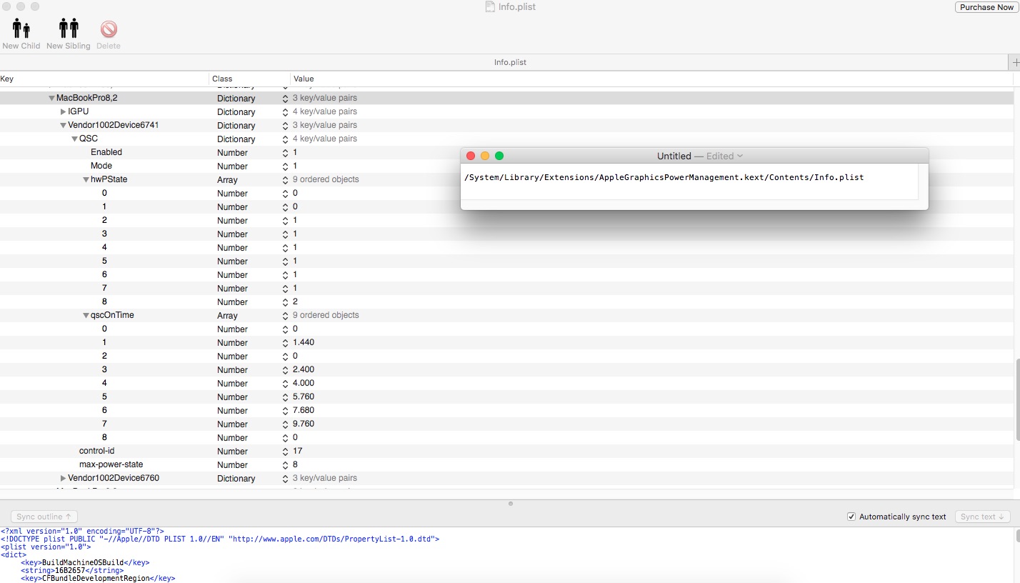

It may be related the max-power-state=8 or just a coincidence ->
qscOnTime -> frequency levels of the AMD GPU.
