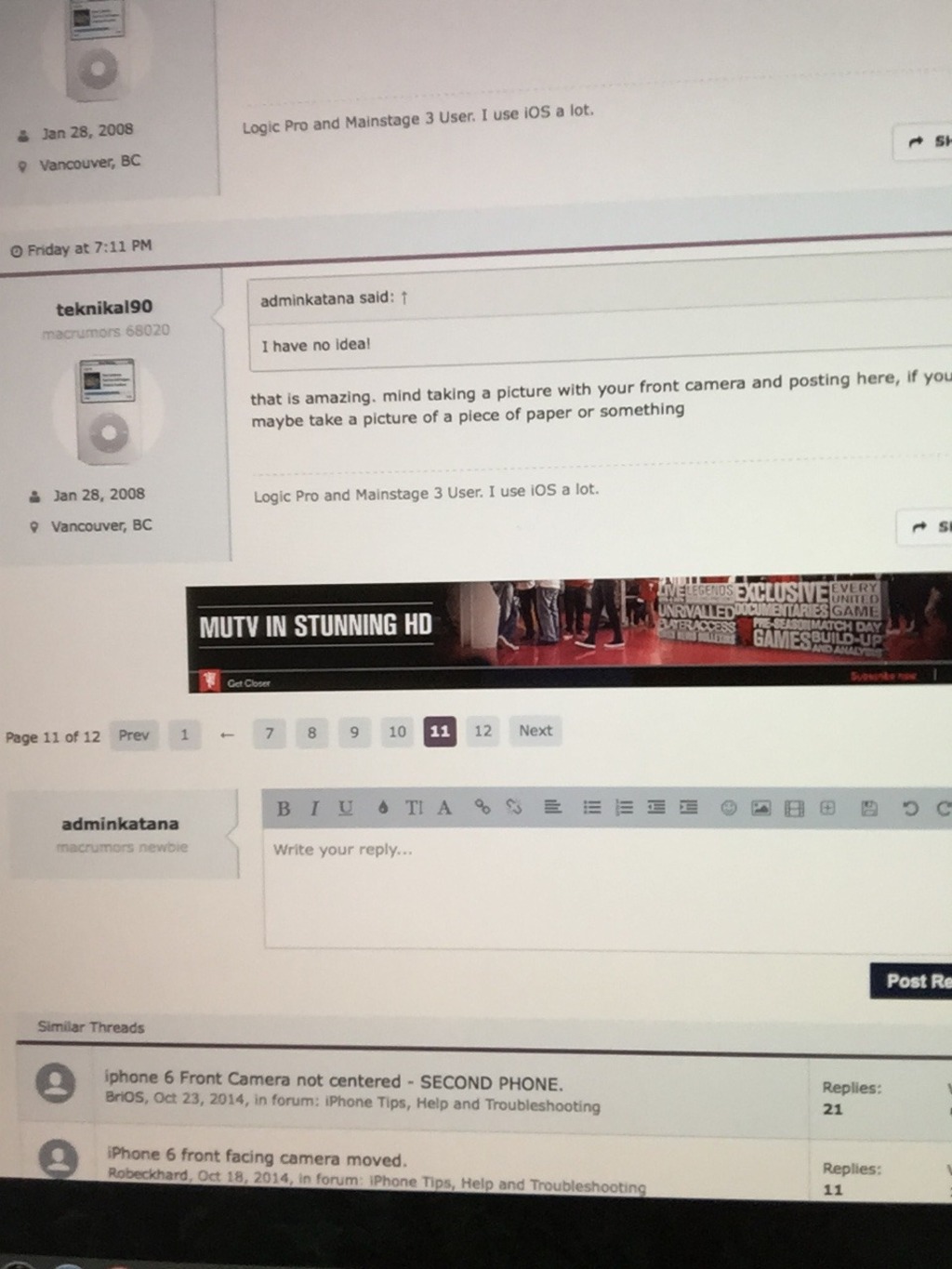

that is amazing. mind taking a picture with your front camera and posting here, if you still have it?
maybe take a picture of a piece of paper or something
Here is a photo of this webpage taken with the front camera. I still have no idea how the view isn't blocked!? Genius appointment is booked for next week, so hopefully it will be sorted soon 🙂
