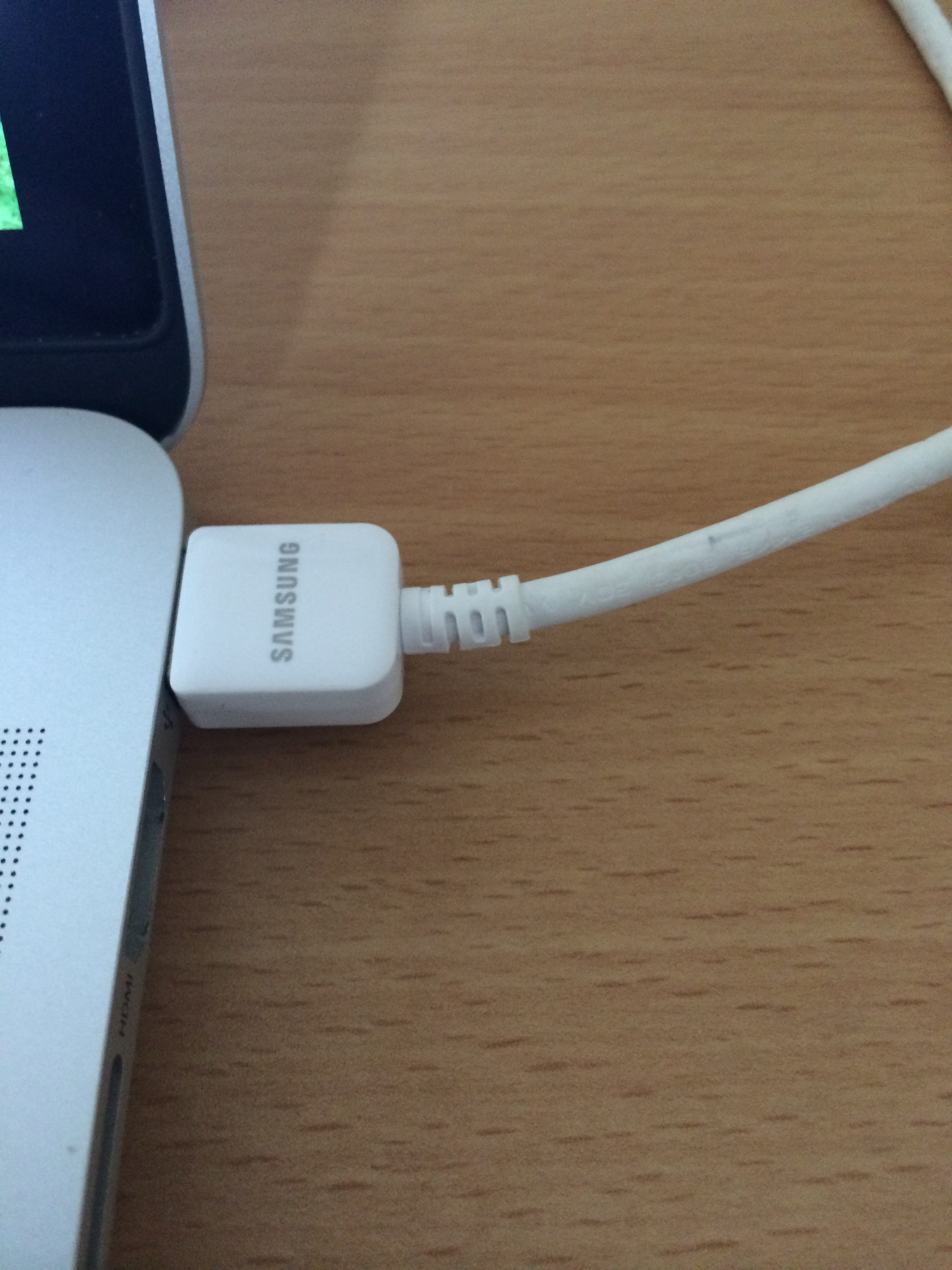

One problem i am having is the phone will charge on usb in my macbook but with Android sync it says no android device found?

It has to be your cables....
Is it the proper Samsung charger and USB 3 cable you have ? Seriously if so it shouldn't take that long to charge ...
If they haven't given you the genuine cables it could explain the slow charging and the issues with Kies and Android File Transfer.

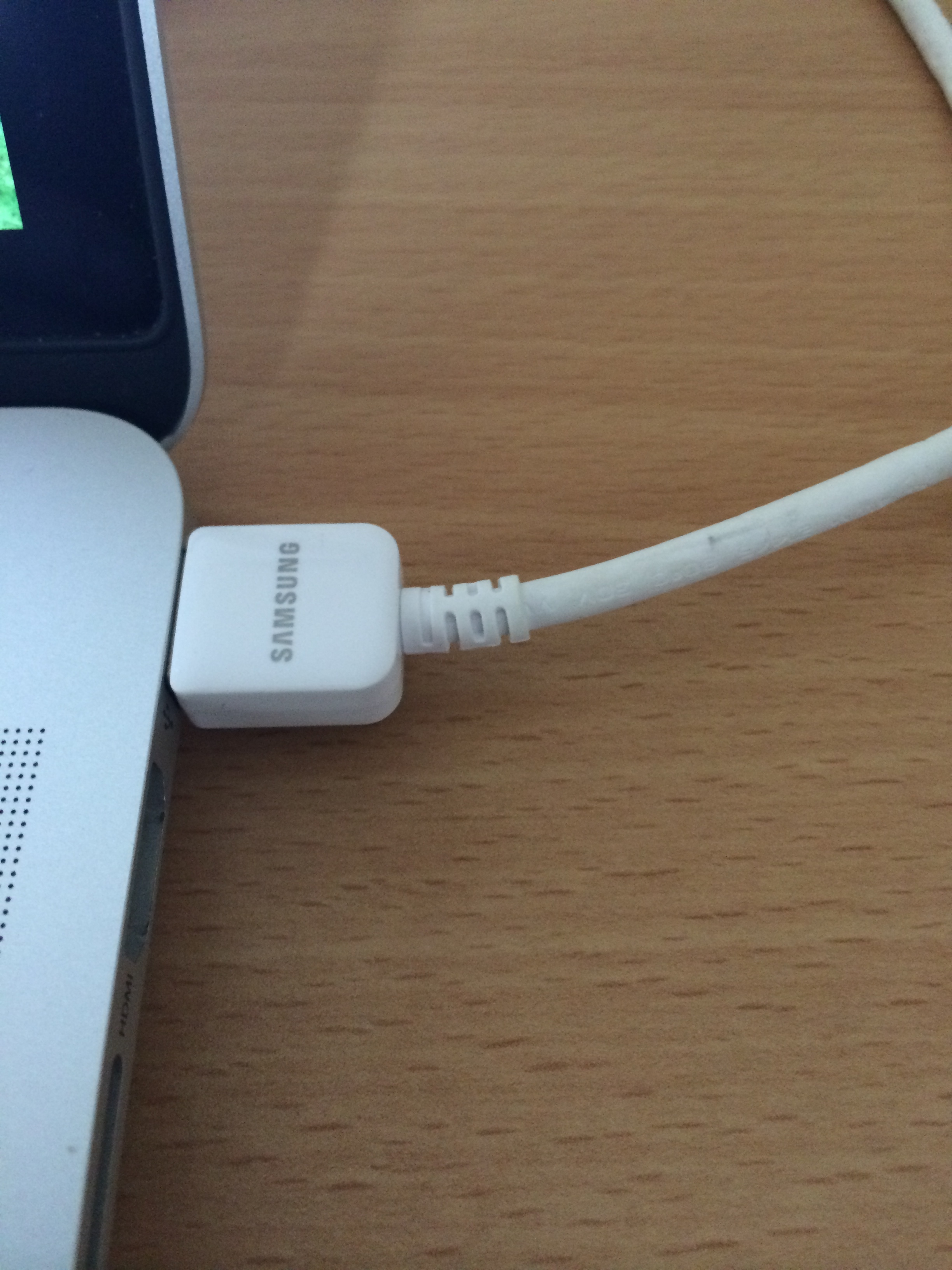

Its a white cable with Samsung written on each end? Its been on charge for 4 hours and gone from 47 to 94 percent.
This is it
