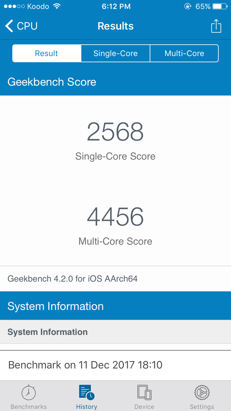

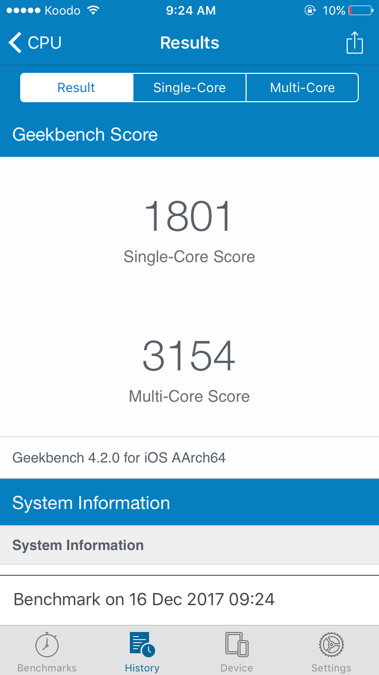

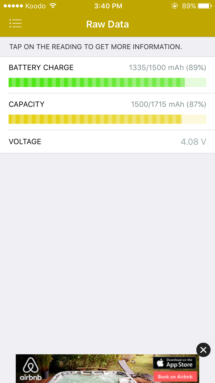

My phone! Take a look at the screenshots i posted my wear level at the time was 91% (down to 87% now)
Edit: added pics, one above 50% one below along with my current wear level. I've seen worse, but that doesn't excuse it.
