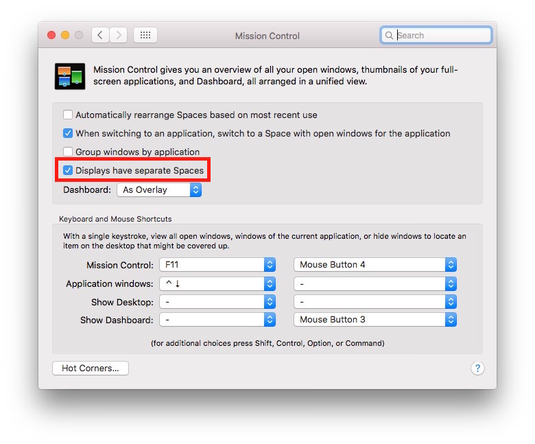

You can use both GPU's power at the same time.
Setting the primary display can only use one GPU regardless which monitor you use.

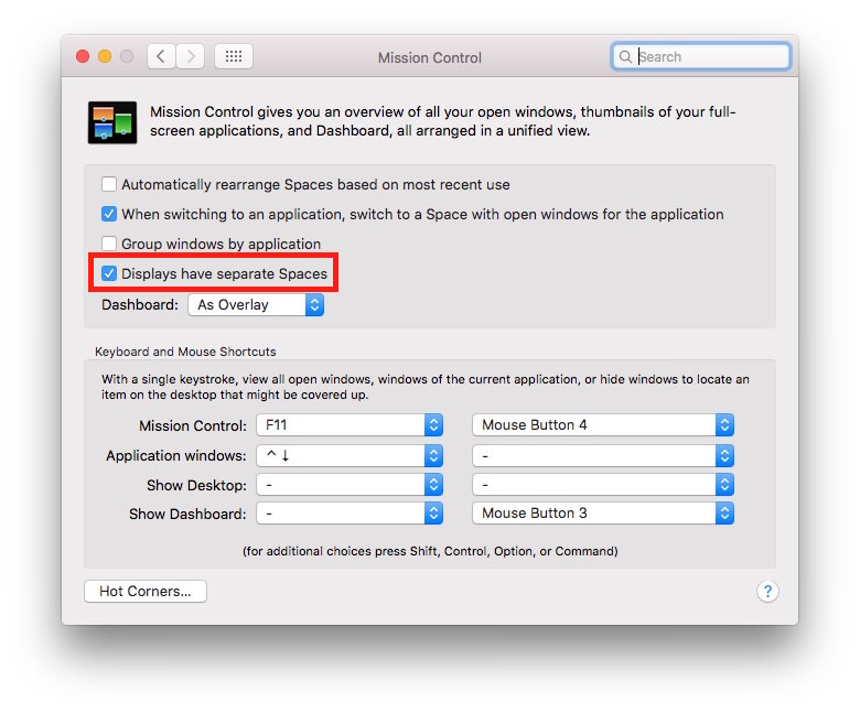

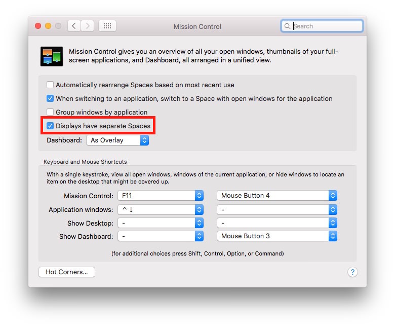

However, if you tick this box.
Then the GPU will become responsible to its own connected display.

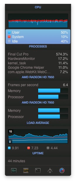

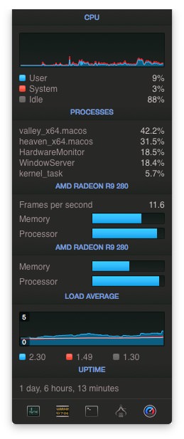

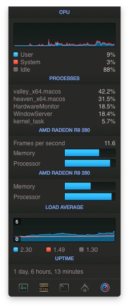

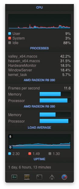

In this screenshot, both of my 7950 (R9 280) working at the same time. One running the Valley Benchmark on its own screen. And the other one running the Heaven Benchmark on its own screen. Both GPU working very hard.

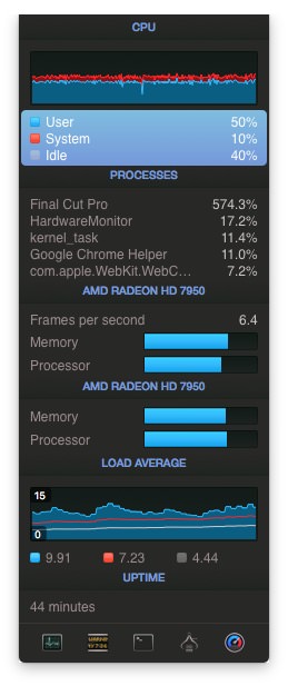

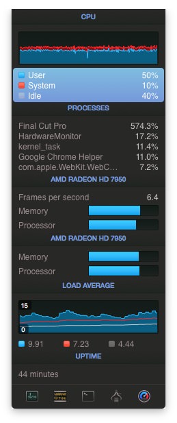

For FCPX, it's much simpler, as long as the GPU is detected. Even no monitor connected, it will be used for rendering.
In the following case, I plug both of my monitors to one of the card, but both still use for rendering. Same as the nMP, even one GPU can never connect to any monitor, it can be use for rendering in FCPX.

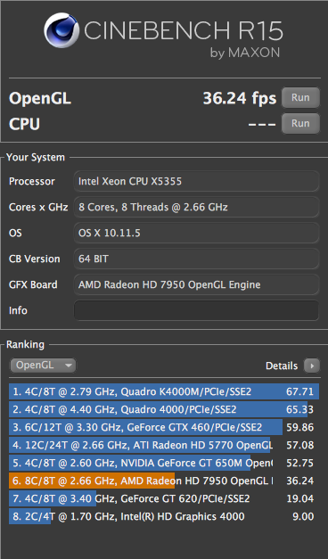

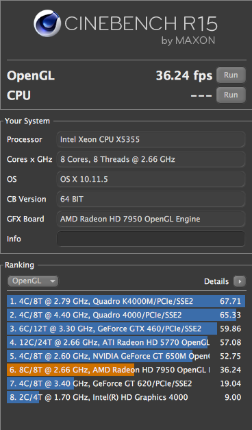

Don't use Cinebench.
It only tests CPUs in OSX.
Incorrect, it does test GPU..

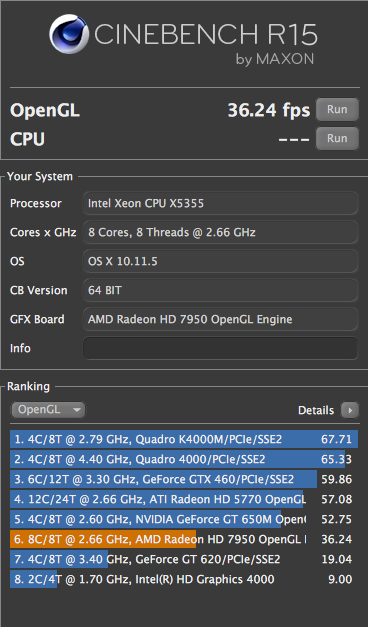

Well, if it tests it the way it should then there is something really wrong with my 7950...;)
It just does a crappy job at testing, but still what we're looking for here is not GPU performance but control
over what GPU is used for rendering. When I did both instances in separate monitors initially, I got
12-13FPS, concluding it was using the GT120. When I switched the default display, the result jumped
up to to 35FPS, so obviously it had switched to the GTX650.
I used cinebench because it's small, simple, and gives me the stats I needed for this test

Haha, I think CineBench tax (use) the GPU a bit, but not really testing (benchmarking) the GPU (unless you have a CPU that has very good single core performance, but very poor GPU)
Anyway, in this test, all you want to know is which GPU is working. So, CineBench may do the job properly. But IMO, it's better to check the power consumption to decide which GPU is working.

Back to the topic, if each GPU has its own space, then the GPU will become responsible to their own monitor. If they don't have their own space, then the GPU that connected to the primary display will become responsible for the OpenGL stuff, even though you are using another display which is connected to another GPU.

Last time I checked a 512 meg 8800gt got same score as 3Gb GTX580 on Cinebench. It is a complete and utter joke.
Once a week I get an email from a customer who thinks they got a dud card because Cinebench score is identical to old card. It is a complete and total waste of time and the authors should be embarrassed.

So, on the 6,1. Only one GPU can display. But BOTH GPU CAN COMPUTE. They can work together. That's exactly what happen in FCPX. The GPU that need to handle the monitors may not perform so well on computation, but it does some contribution. If a GPU that responsible display cannot compute, then no single GPU system can play AAA games. You will need one GPU to handle the monitor, another one to render the 3D picture.
Crossfire is just another example that both GPU on the 6,1 can work together. Even though it's not a good example, because it avail in Windows only. It is another prove that both GPU can do the rendering together (as long as the software support, same as FCPX).

In the 5,1 Mac Pro I kept the GT120+GTX650 for a while, and with some testing I did find that when each
monitor is set as the same space, it will prefer the primary display GPU for rendering tasks with the exception
of programs that utilize multiple GPUs.
