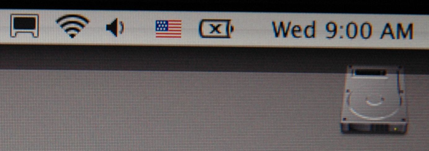

MacFan26 said:
Here's another shot
And a very good one. Shows the scanlines very clearly. Note how every other row of pixels is a little darker. Thanks for this one.

More pics
Some more digital photos of the screen (not screen captures).

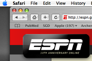

Yes, we know.🙄 That's the point. But watch what happens when you move the ESPN logo up or down one pixel -> BANG! No lines.
The increased brightness of the alternate screen lines and those on the ESPN logo cancel each other out.

Thanks for clarifying that for him, Spectrum. I work on images like this a lot and that is how I first noticed the issue. I was creating a graphic with scanlines, but I couldn't see them...then realized they were there...just had to move them a pixel...and then it looked "off" because some rows were darker than they should be. 🙁 😡

Just to really make the point
Screen capture, lines, no lines.
Nice shots! That shows it really well. Granted, it looks more noticeable in person, but these pics are as close as you can get to showing people.
Hmm...according to Spectrum's ESPN shots, my display most closely resembles the "no-line" scenario. I don't have the vertical-horizontal screen-door effect that the other shots show.
I get the exact same results as you.
