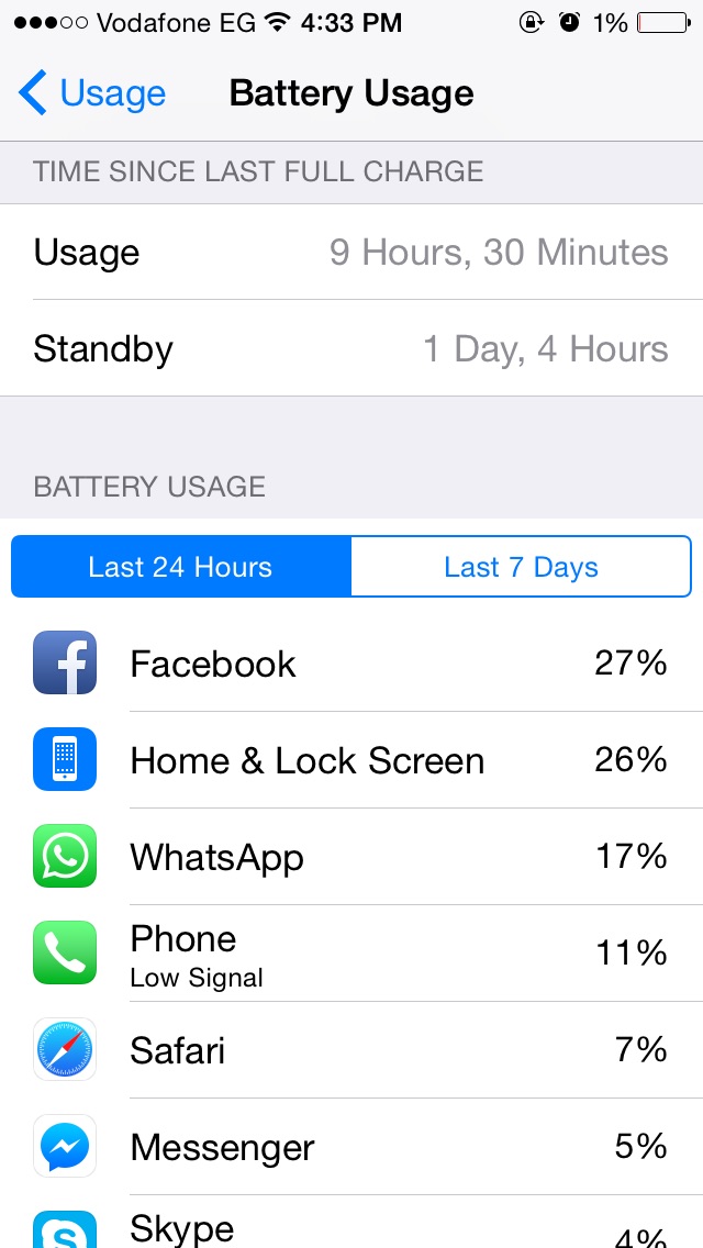

It's not your motion sensor. It's the phone struggling to keep a strong network signal. It drains the battery more than any other background activity.
How many dots are strong signal? 4/5 from 5? 🙂 because at work mostly I get 3 from 5 however I use WiFi but also keep turned on cellular.
Dots are not a linear representation of signal strength, unfortunately.
With 4/5 dots you surely have a good signal. 1/2 are a very poor signal, barely usable especially for data exchanges. 3 dots are a gray area: it could be good for a phone call, but hard for data exchanges (thus an high battery drain).

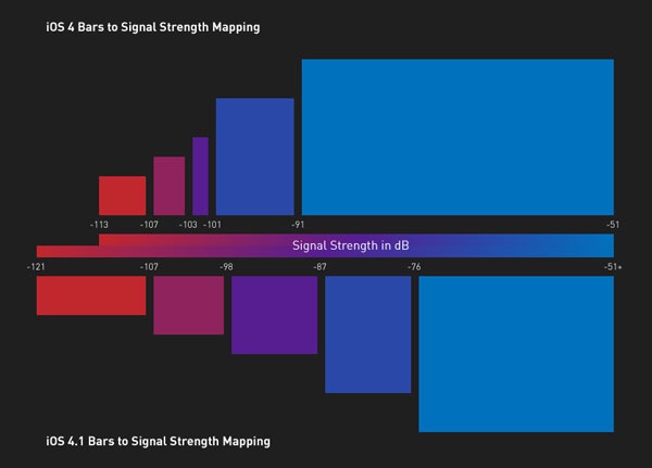

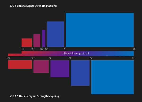

Since 4.0.1, this has been changed to be more linear.
http://www.anandtech.com/show/3821/iphone-4-redux-analyzing-apples-ios-41-signal-fix

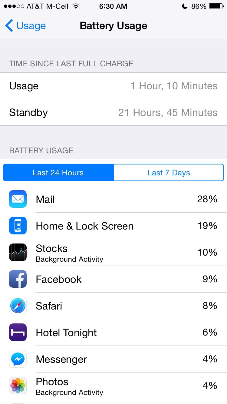

I would disagree with "obviously something wrong". Qver an hour of use and 86% with almost a full day of standby is not obviously bad battery life. Pretty normal I would say.
Assuming this is a 6+
per Apples spec, 384hr standby and 12hr wifi/lte use
stdy =22hr 45min
use= 1hr 10min
22.75/384=.059 (6%) used stndby. 1.25/12=.104 (10%) wifi/lte use so 100%-(6+10)=84 so should see about 84% remaining. He had 86% so seems like good battery to me.

I wasn't really commenting on battery life, more the 'background activity' in apps which pretty much never say that. I had that issue before and resetting all settings (plus the subsequent re-toggling) fixed it.
Oh sorry, wasn't thinking that. However background activity is normal too if its turned on. Looks like he has stocks and photos in the background enabled. So in that case this too would be normal.
If enabled, yes sure. I kinda fired my message off and should have said 'if this, if such & such' etc. I would just assume within my own set-up that too much background activity meant an 'issue' was present. Not necessarily for everyone though.#

Anandtech's new bars agrees with my findings.

There is nothing wrong, and in fact it is great. This is a 6, not a 6+
Photo stream is on, and mail is fetching and pushing in the background. This is normal.
21 hours of standby, and little usage shows that the iOS is not drawing my battery on its own. With normal usage, with my habits, I'll get 8 hours of usage. In a stronger signal area, it might go to 9-10. No audio being used.

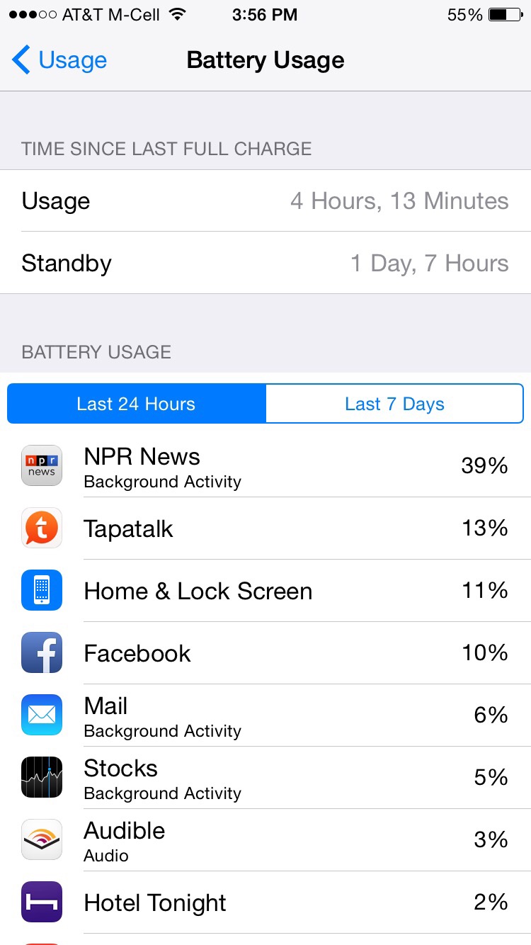

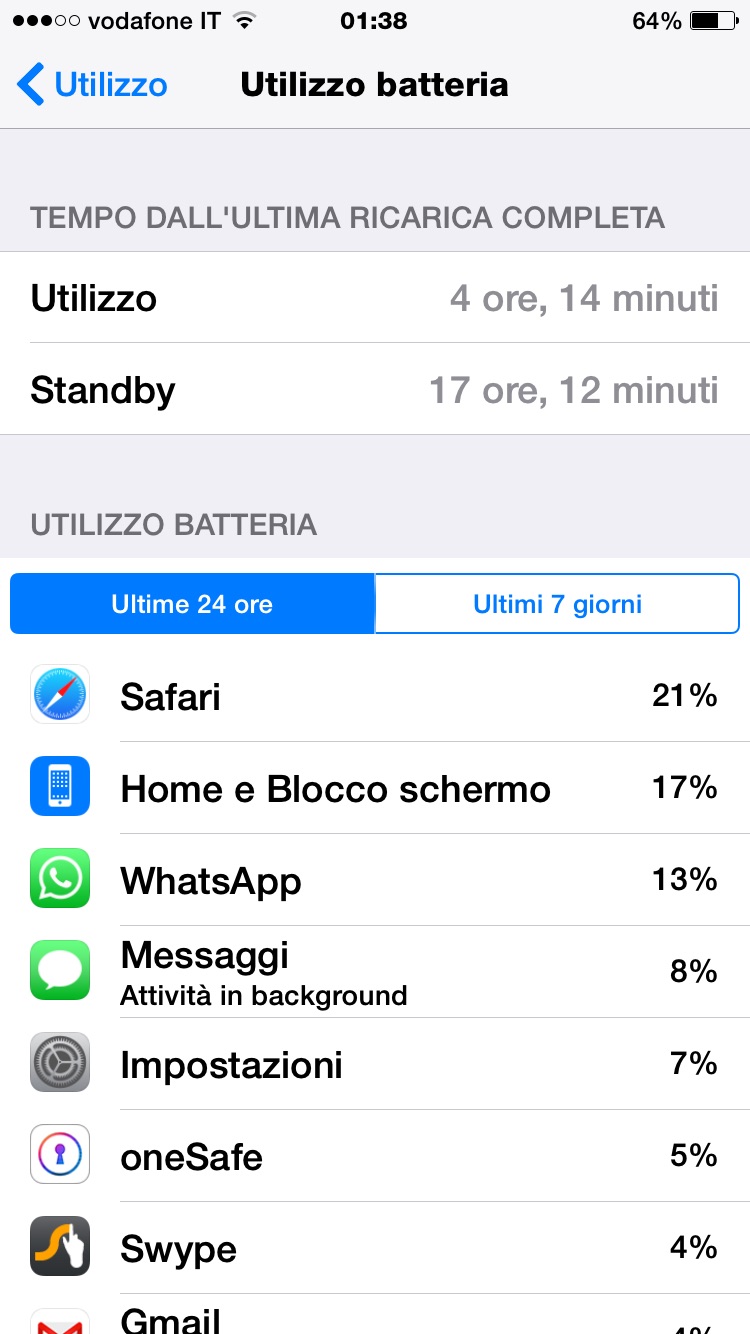

Now that I'm using the phone more, time is ticking. Spent about an hour plus listening to NPR wifi radio and 15 min of an audio book. In this case background activity means I'm using wifi radio but the screen is off, phone locked
Still on my way to 8+ hours. Standby time is incredible. That happens a lot when my phone is in a pouch. I check it less often, so the screen is not on.

That article is quite old.
Since iOS 7 dots took place of bars, and we don't know the algorithm behind....
Yes but I see no reason why Apple would have reverted back to the older behaviour in subsequent updates. Using a linear scale gives a more accurate reading.
