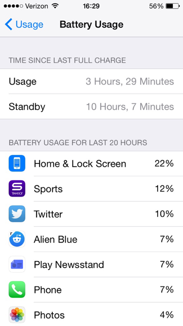

It took a few days for battery life to go back to normal after i downgraded to 8.1.1.
My first charge cycle after installing 8.1.2 via a DFU restore on iTunes:
[url=http://i30.photobucket.com/albums/c336/sunking101/9EA3E7FA-9C47-4B2E-9BF4-402AA2B59C97.png]Image[/URL]

He has the 6+ so there is some of the difference. Here is a good way to see where you are in relation to Apples specs and times. Try and use the number of hours of the particular type of usage:
iPhone 6 Spec
stdby: 250hrs
Talk: 14hrs
Internet: 10 LTE/11 wifi
Video: 11
Audio: 50
So assume the below example shows 8hr 45min standby and 30 min of use mostly all wifi, (email, text etc)
8.75/250=.035 (3.5%) used for stdby, .5/11= .045 (4.5%) used for wifi. So 100%- (3.5+4.5)= 92% should be remaining. Compare to the battery meter to see if its close. Of course this is not exact but if you use the numbers for the type of usage you will be very close to knowing where you stand compared to Apples MAX spec. (those spec numbers are their "up to x hours max spec)"
