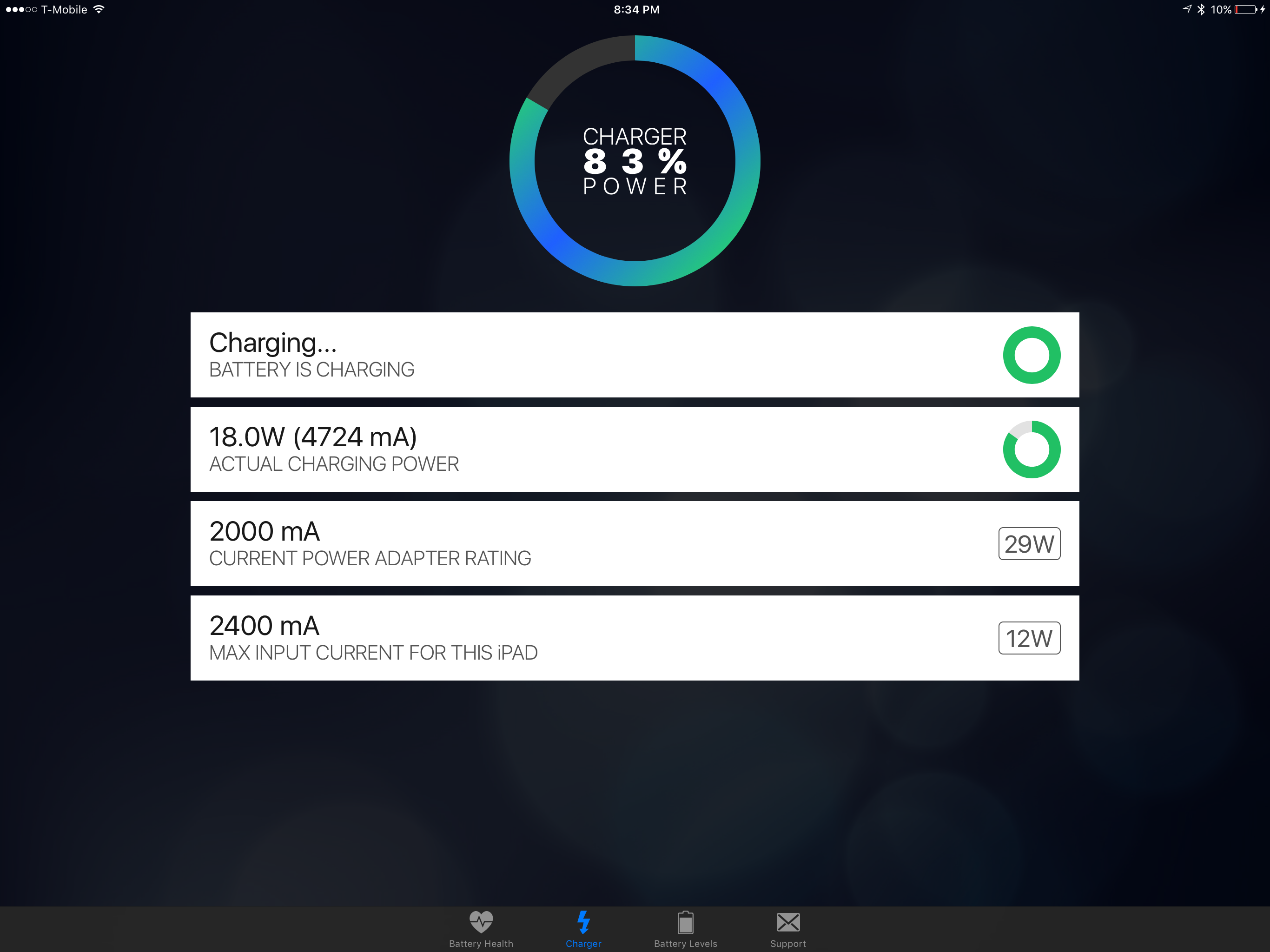

I got my USB-C to Lightning cable delivered to me today, and I spent some time draining my iPad Pro battery with multiple runs of GFX Bench Metal's battery test. I drained it down to 10% then started to get it charging. Here's a screenshot with @echo1877's excellent app (sadly no longer on the App Store):
As you can see it indicates 2A / 29W charging (I guess the app needs to update the "max Power" for the iPad Pro)

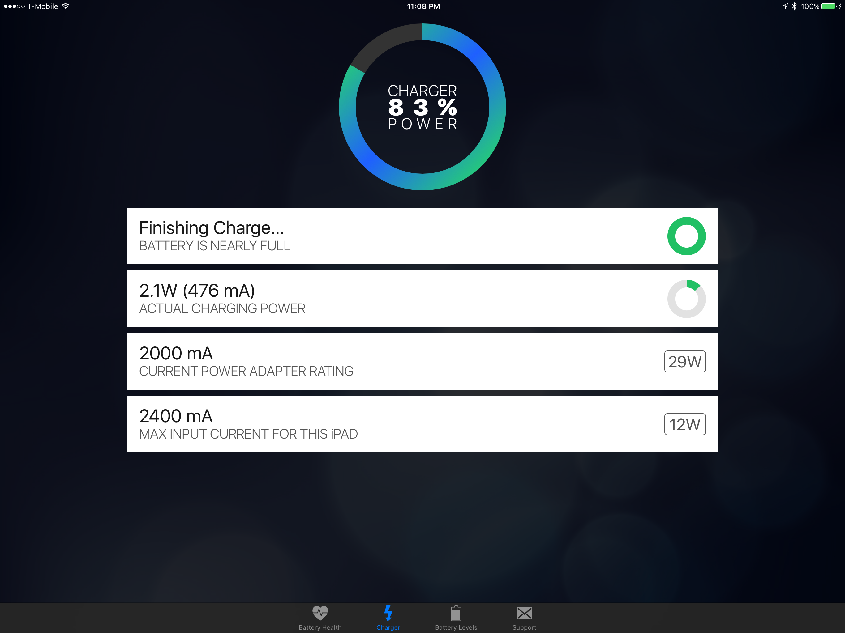

I turned the screen off and left it charging while I went to do some stuff. I came back about 2.5 hours later and it's fully charged:
I'm personally very impressed by the charging speed. I've ordered a second 29W power brick just for this - decided to save a little and get a used one from Amazon for about $30.
Thank you for this @masotime, you beat me to it! Clearly the app is correctly detecting the 29W brick, but of course the 83% figure is incorrect (it's comparing against 2400mA which is incorrect).
The actual charging power sounds spot on. Do you happen to recall the screen brightness setting when you took that screenshot at 10%?
Ah... Unfortunately I didn't capture this information, although it might have been 30%. I turned off the screen after taking the screenshot though, so I'm not sure if the brightness has an effect in my experiment.
No worries. I ask because the 4724mA in that particular screenshot is lower than I expected for a near-empty battery, which would make sense if the Pro was at or near full brightness.
