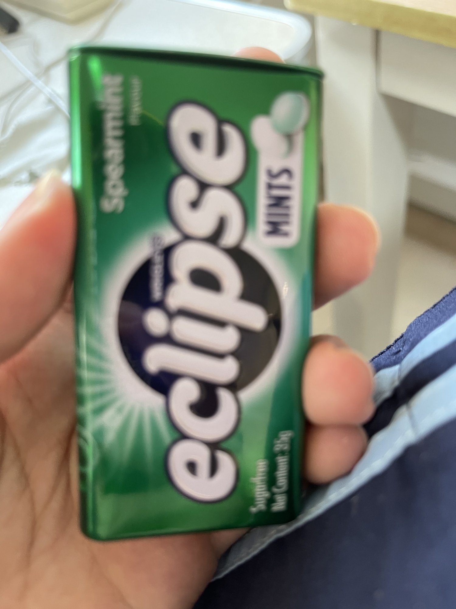

My Iphone 12 max was spazzing out when it couldn't focus. It was actually driving me insane as it took me twice as long for product photography compared to my XS max. Hopefully you guys are right that 14.2 fixes it.

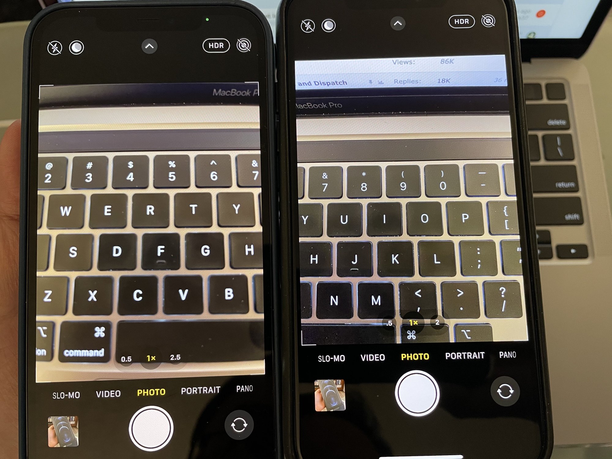

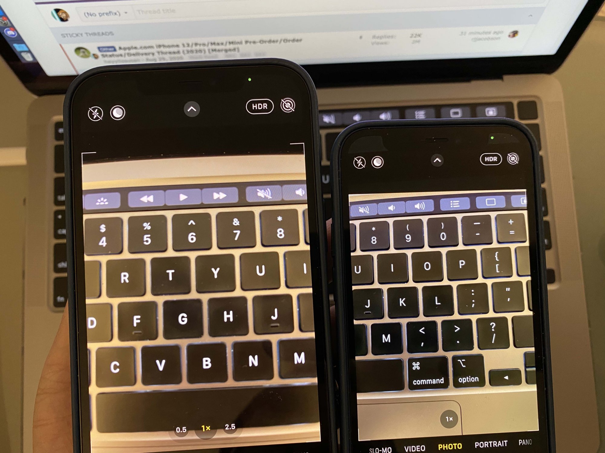

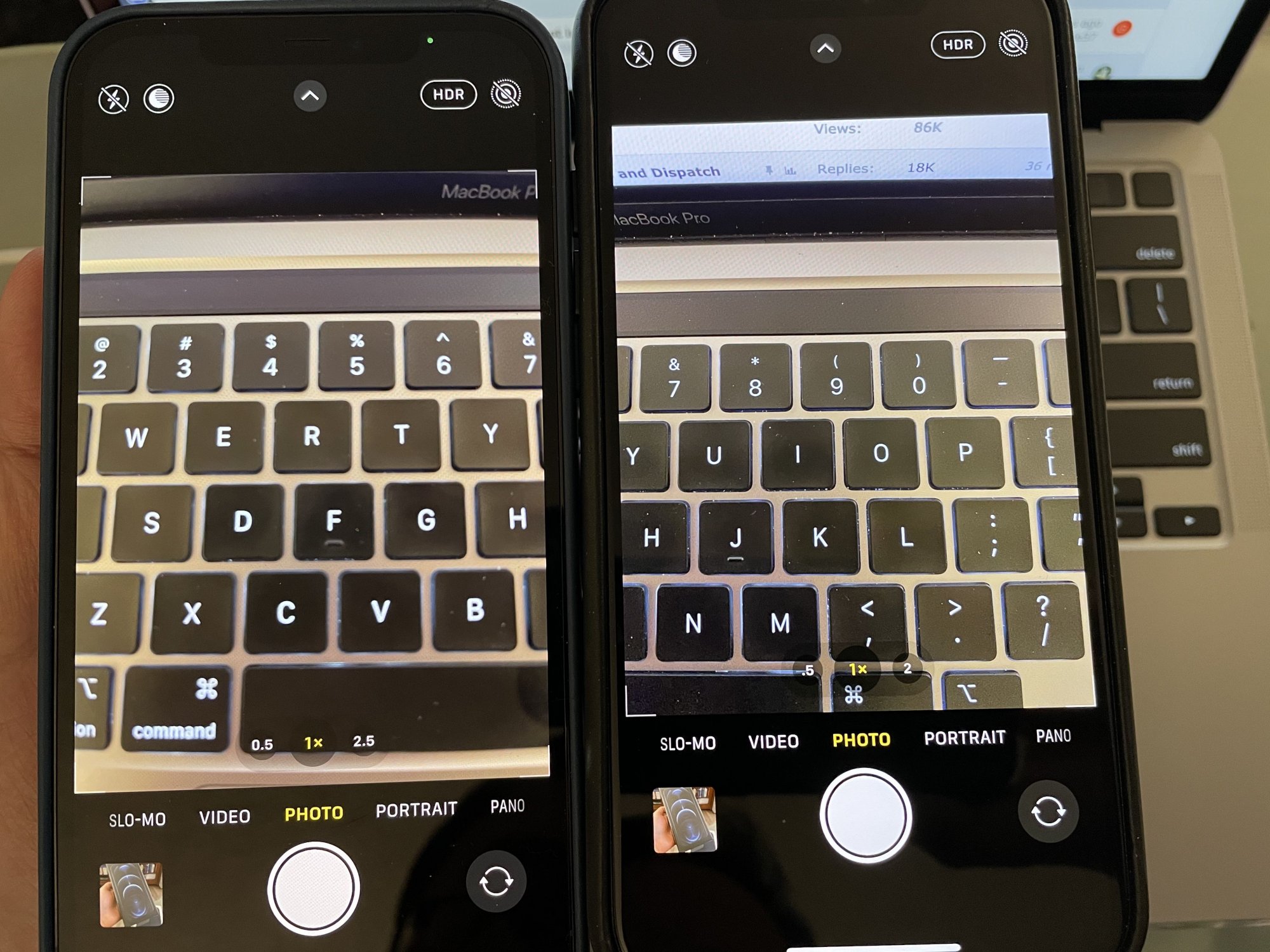

Definitely have issues on my 12 Pro Max. In this picture below I have both phones above the keyboard. The 12 Pro Max on the left has a blurry shot. On the right, the 11 Pro Max the image is sharp. I hope this can be fixed in software.
Larger sensors and faster lenses create more depth of field. The larger sensor with the faster f/1.6 lens on your 12 PM is going to have a more shallow depth of field than your 11 PM, meaning more will be out of focus in a comparable shot. I really wish people in this thread understood how cameras work and what minimum focusing distance is before thinking their iPhones are broke...

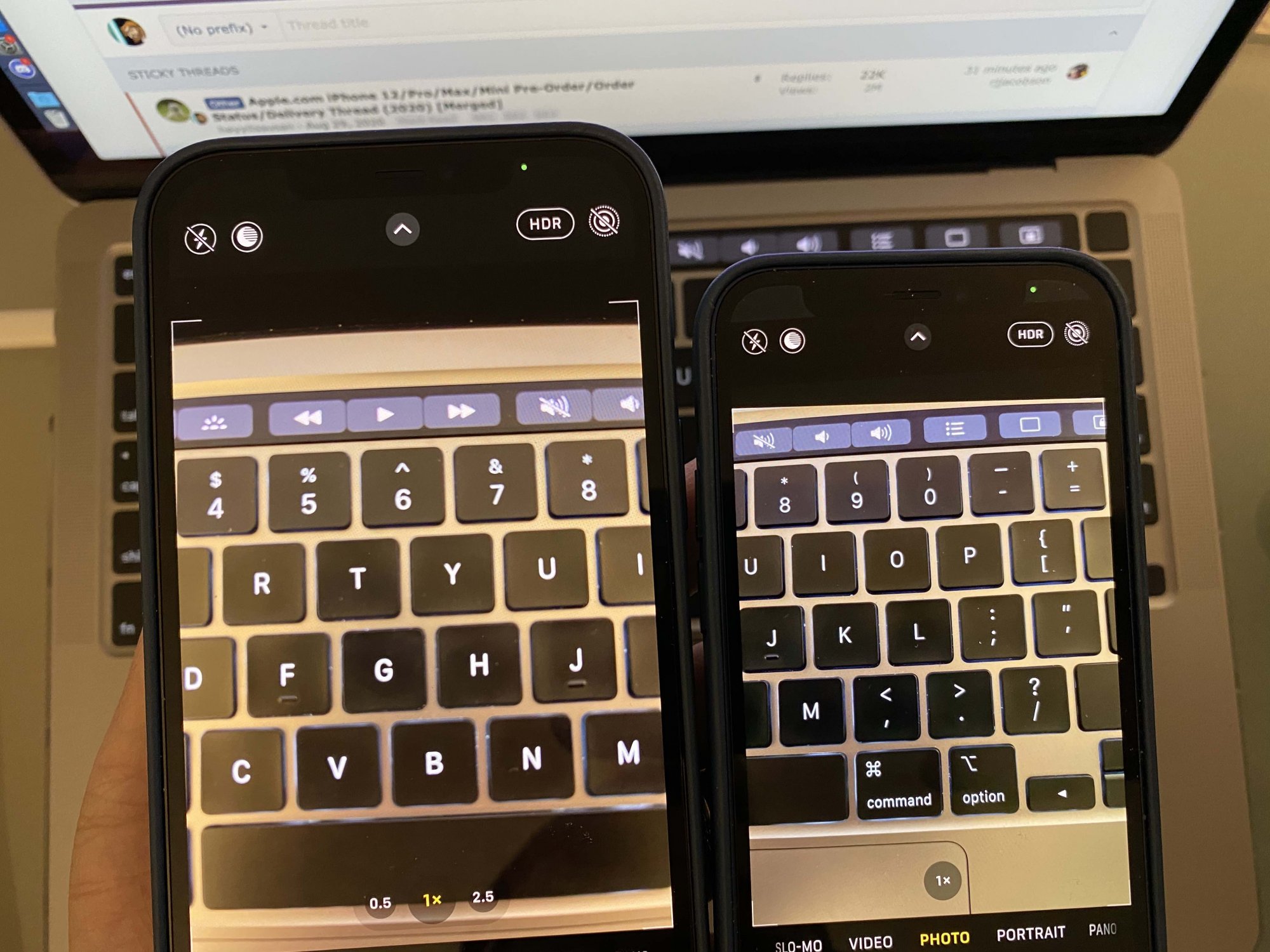

Okay, that may be true. However, I also have an iPhone 12 mini, and according to the specs of its camera it also has the f/1.6 lens. The image is not blurry on it. As you said, the blurriness could be a result of the Pro Max's larger sensor.
Reactions: trifid
Its also the LiDAR sensor in lower light. Try the same test outdoors in better light and see what happens.

Excuse me, while you’re not technically wrong, the depth of field is like 10-20% shallower at most, and WOULD NOT account for the entire frame completely failing to focus. You’re dismissing others as clueless, but there’s a very real issue here and if you actually tried one of these phones you’d see it. The focus racks like crazy and fails to lock, it’s clearly abnormal and a major regression from previous models, not just ‘a minor, understandable tradeoff of the bigger sensor’.
I really hope Apple addresses this soon, as it’s frankly a nightmare. I imagine it’s fixable in software but please acknowledge it and tell us.

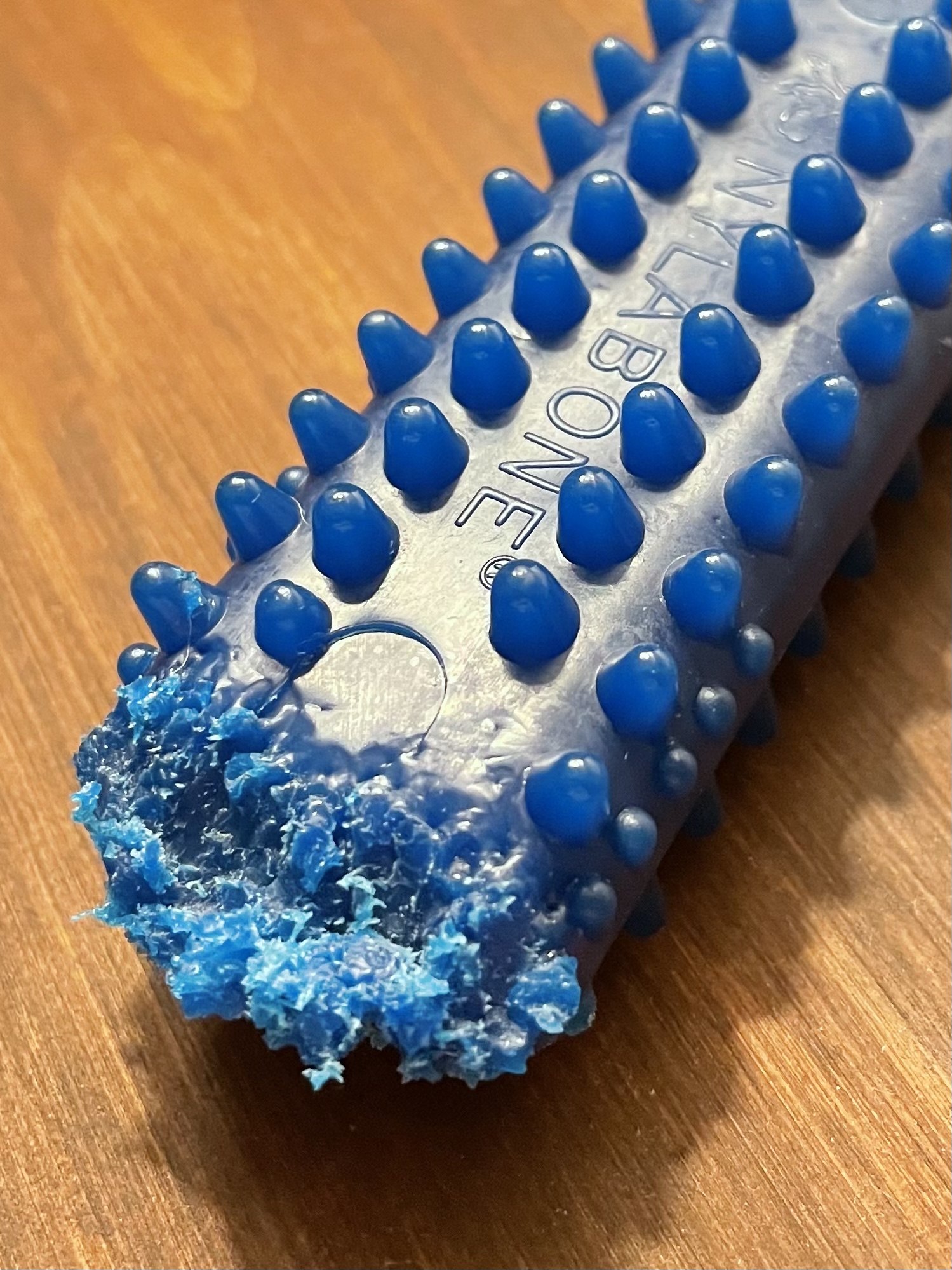

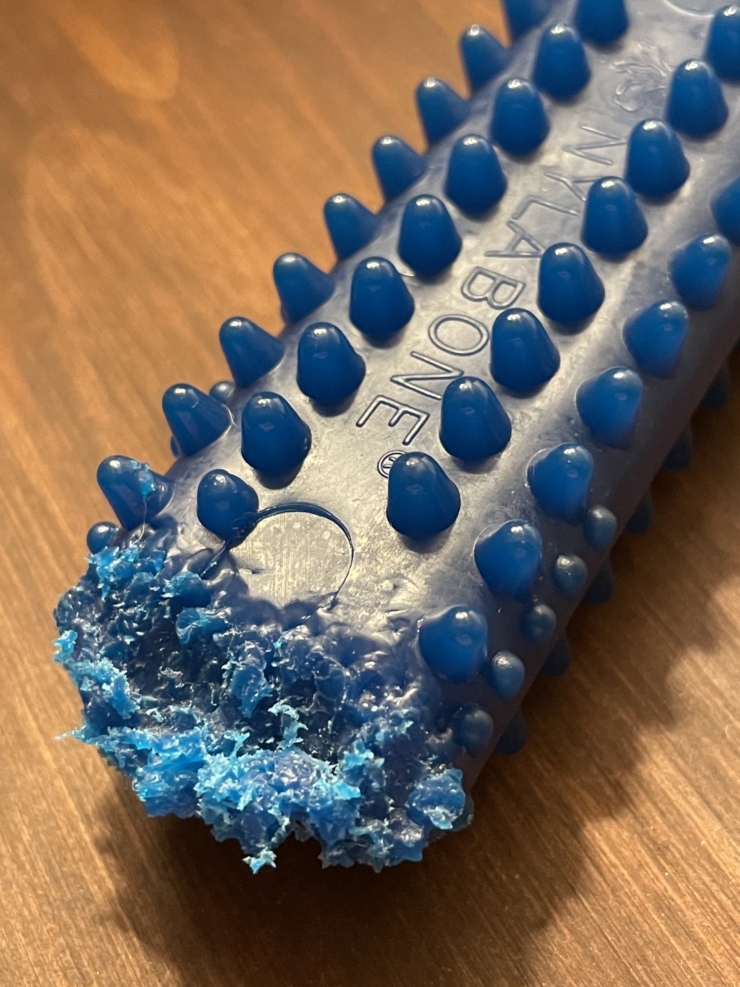

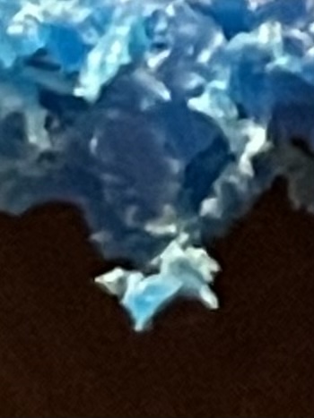

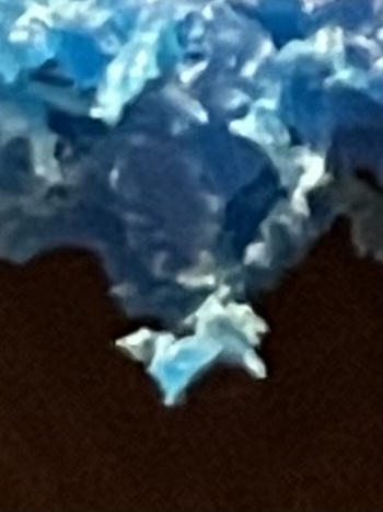

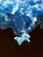

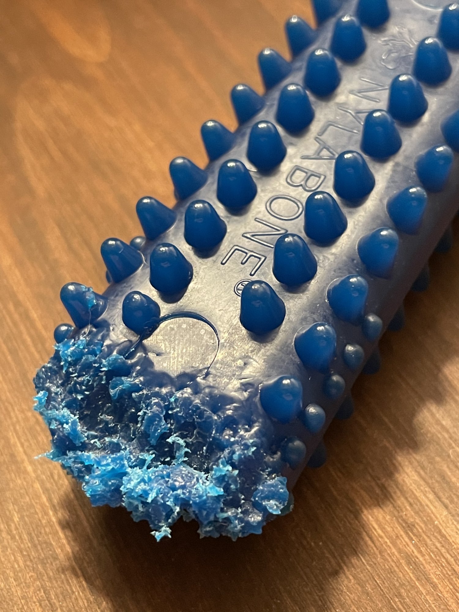

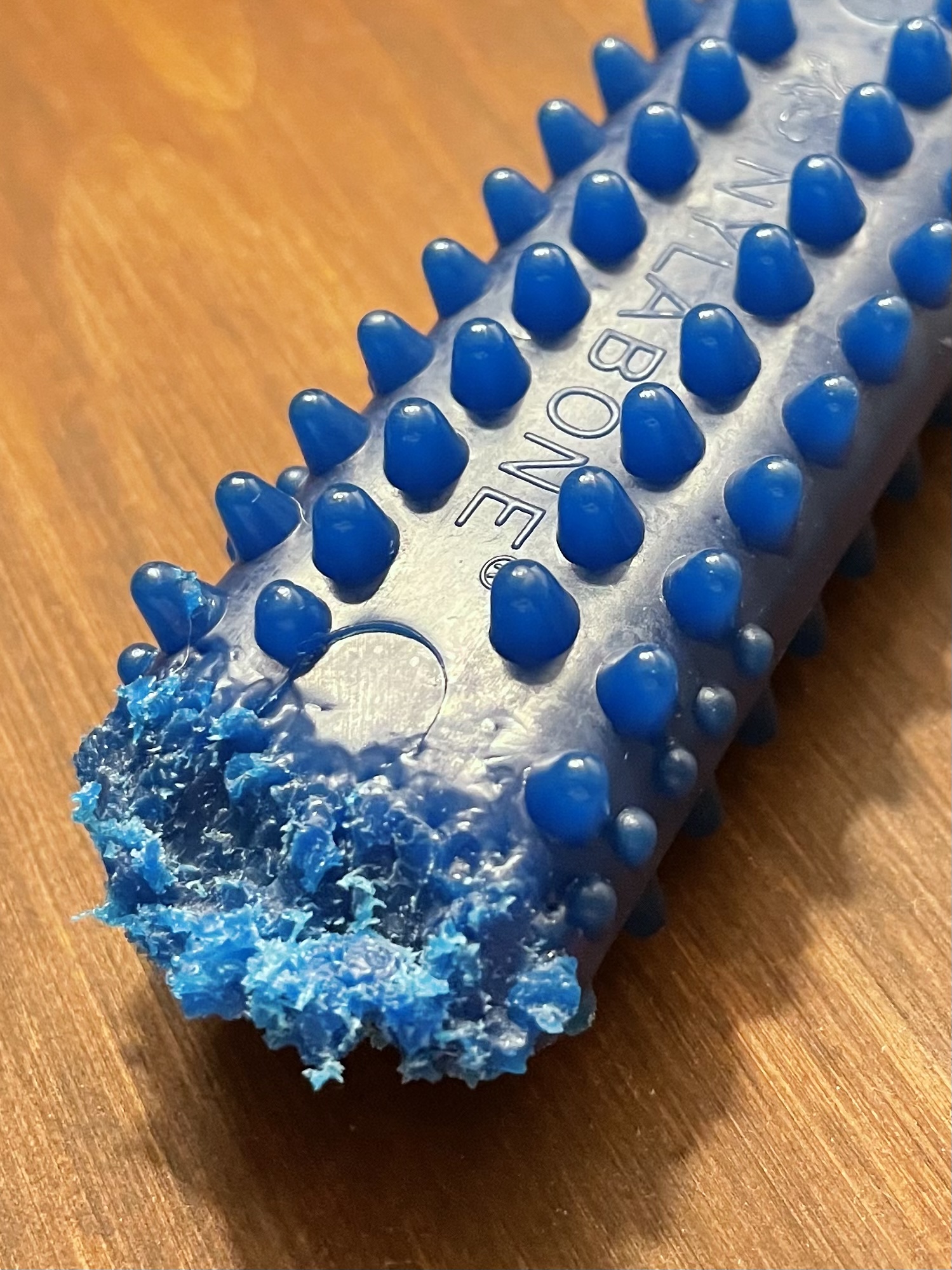

I welcome theories as to why this might be the case, but I think the Tele lens might be Apple’s intended Macro lens on the 12 Pro + Max (despite being saddled with an inferior sensor.) Here’s a 2X crop from the Wide, followed by an uncropped shot from the Tele. As you can see in the, uh, gory portion of the chew toy, the Tele seems to have captured more detail:
I’m not saying it’s ideal, but this could well be how we’re expected to do closeups with the Pro phones.
What’s perplexing is why this “downgrade” to the Wide’s minimum focus distance would only apply to the Pro phone lenses and not the 12/Mini‘s cameras, given that they’re apparently exactly the same...? In other words, what is gained by forcing Pro users to only use the Tele lens (with its noisier sensor) for macro shots? 🤷‍♂️
(Note that I haven’t tested this in daylight yet but I expect similar results...)

Using a third party app to manual focus (i.e. disabling autofocus) doesn’t allow for a shorter focusing distance, unfortunately, which points to the actual travel of the Wide’s physical lens elements being restricted to a shorter range... which might make sense since there’s an extra element crammed in there now. But then why wouldn’t this be happening on the regular 12 and Mini Wide lenses too?
View attachment 1671815View attachment 1671816
View attachment 1671840View attachment 1671841
Possible. Which is super frustrating. Being forced to use a Tele lens to get the focal distance while narrowing the DOF. If this is the case then I have to relearn the ‘angles’ that I take my photos. Trying to get the whole image into a narrow DOF. I’ll try reshooting that way and pay close attention to camera to subject angle. If that doesn’t work I’m gonna scream! I don’t need artsy shallow depth of field close up photos!

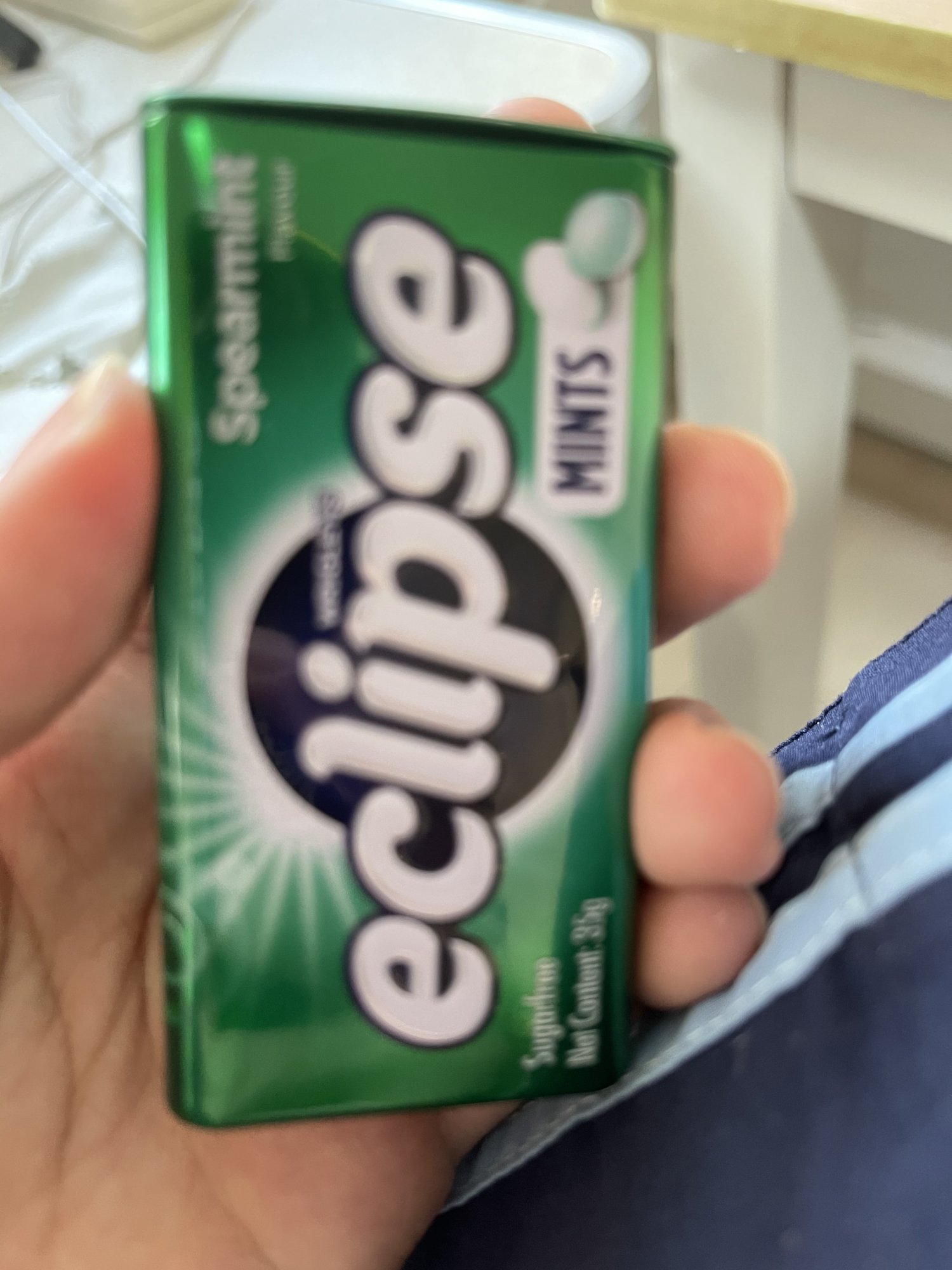

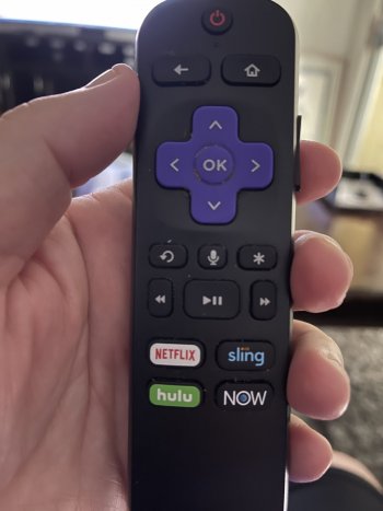

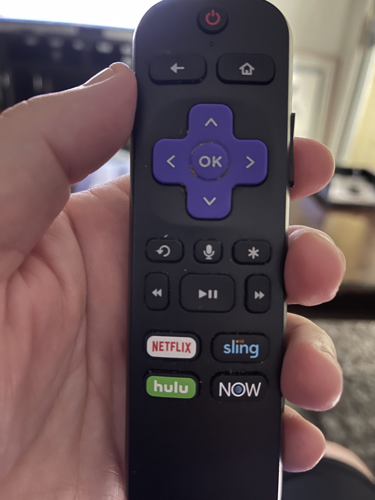

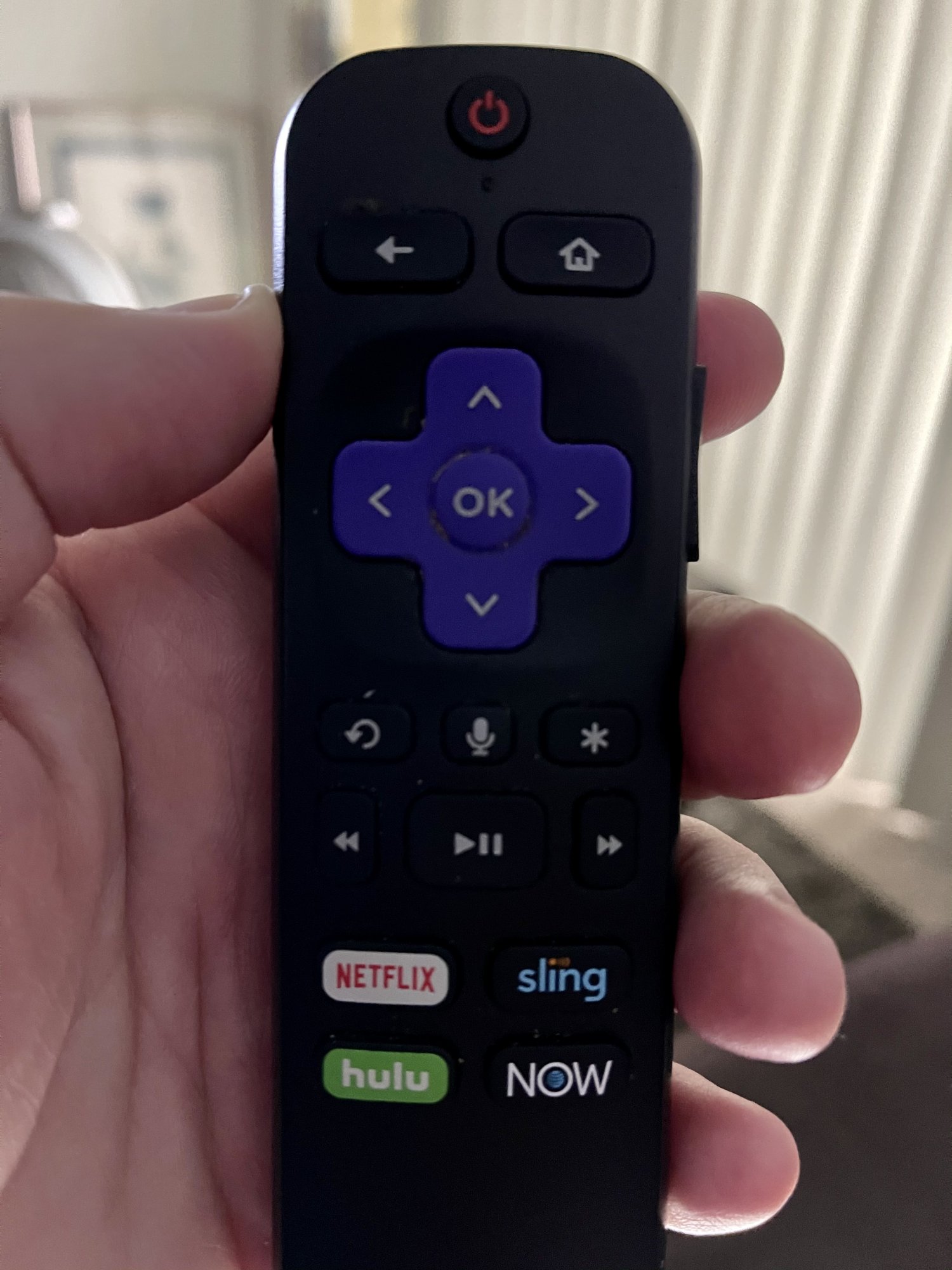

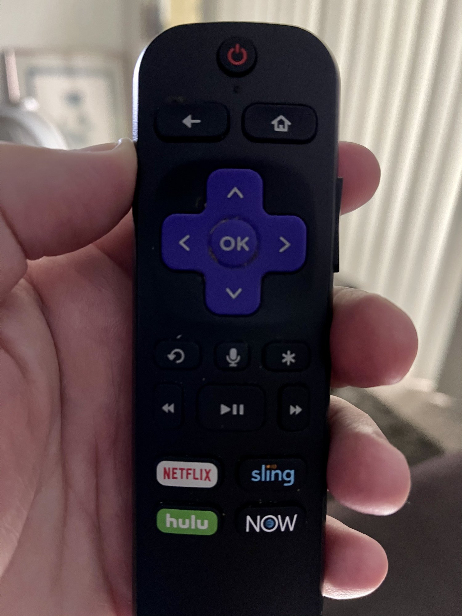

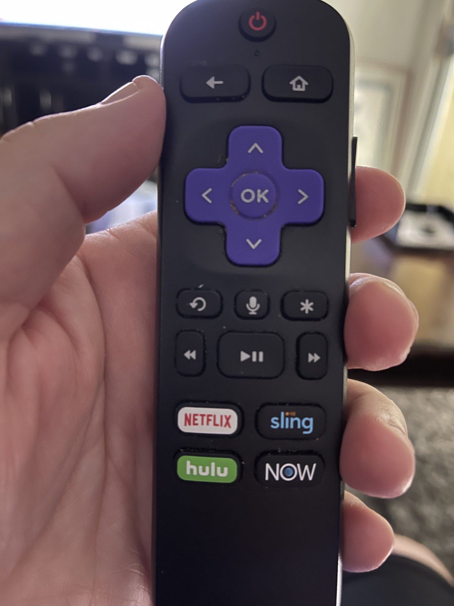

In very low light. So low light that the night mode kicked on for the second shot. It’s not super sharp, appears to be focusing more on my hand than the remote, but it’s not blurry like yours. Almost looks like yours was attempting a portrait shot. Look at the blue fabric to the right.
