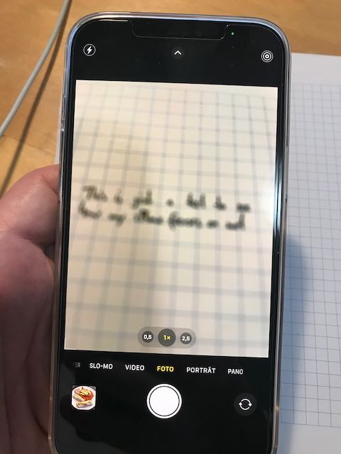

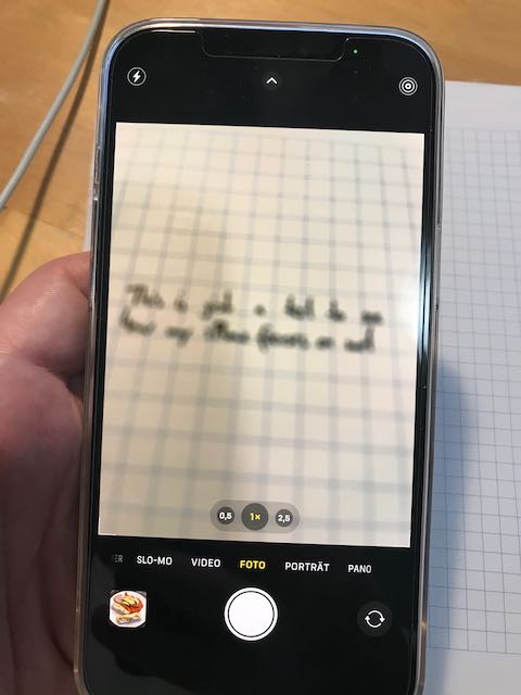

The minimum focal distance issue on the 12 Pro (non max in my case) is real. Today, I tested two 12 Pros side by side. I placed both on a box that is about 3 inches high with a letter in front of it.
One iPhone took shots that were 100% sharp.
The other could only take blurry pictures - it focused, so not completely blurry, but a night and day difference to the sharp shots of the other 12 Pro.
Both phones on iOS 14.2, both with their lenses cleaned (repeatedly), exactly the same camera settings, rebooted the one with the blurry shots multiple times. Nothing changed.
In order to get an equally sharp picture, the "bad" 12 Pro had to be moved 1 1/2 to 2 inches further away from the object.

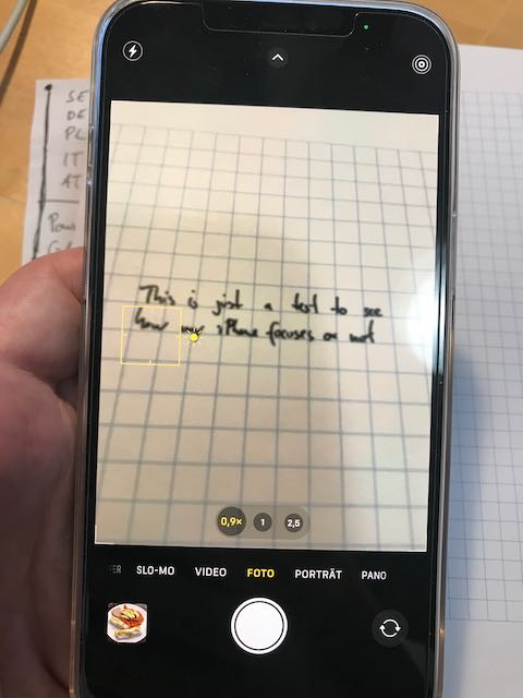

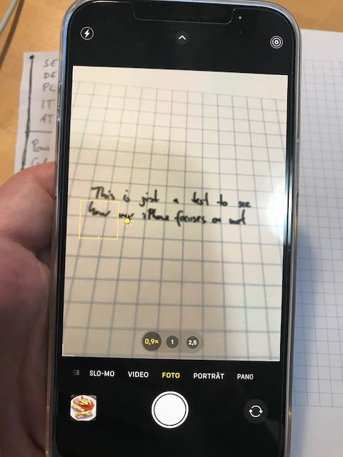

This info is actually incorrect. The telephoto lens will not be used if you are any closer than 11 or 12 inches, regardless of which button you tap. Why? Because it cannot focus any closer than that. So the telephoto lens is useless for macro.
This is based on my actual tests, and not hot air. You can verify for yourself that it’s not being used, inside of approx 1 foot, by holding your finger over the tele lens. The regular 1X lens gets used and any “zooming” you do is digital. And you can not get closer than 4 5/8”, at least on the Pro Max unit I have in hand.

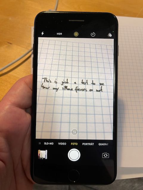

CloseUp:
Zoomed (2.5x):
2-5x-zoomed-jpg.1673436
Also I'll love this to be solved by Apple too. But still at least I can survive till then for the occasional close ups I need to take.

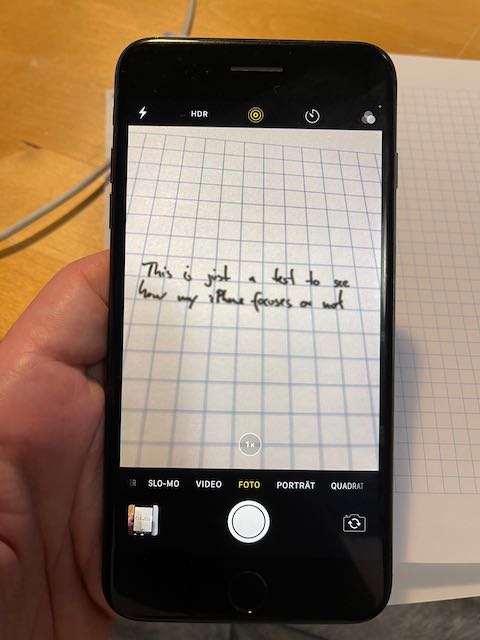

for me it seems to work for anything below 1,0 such as 0,5 or 0,9 or if I hold the phone further away and zoom instead. This really kind of stinks since I need to take a lot of photos to scan "IBAN Numbers" for banking purposes throughout the week and it has a hard time to focus on the digits. Same is true with scanning of credit card numbers actually. (3rd photo is from my old iPhone 7 Plus doing it just fine). Guess its partly a habit thing.
to summarise: old phones are better for focus up close
new phones: for everything else.
