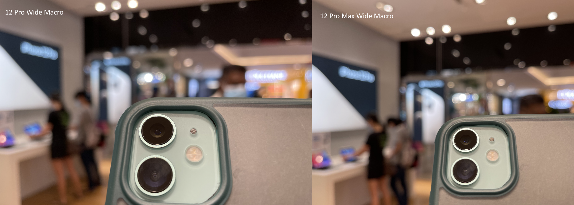

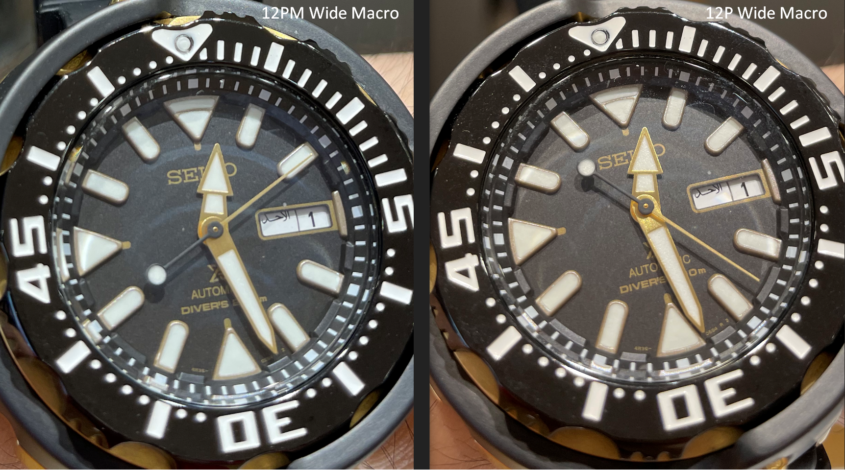

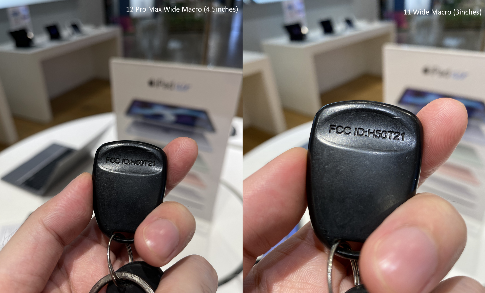

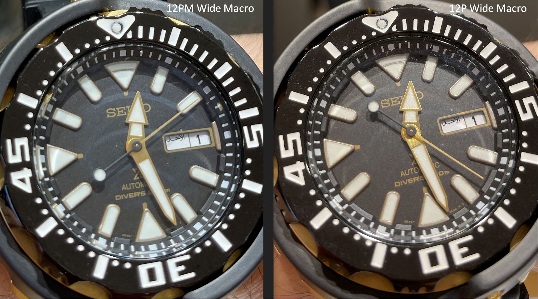

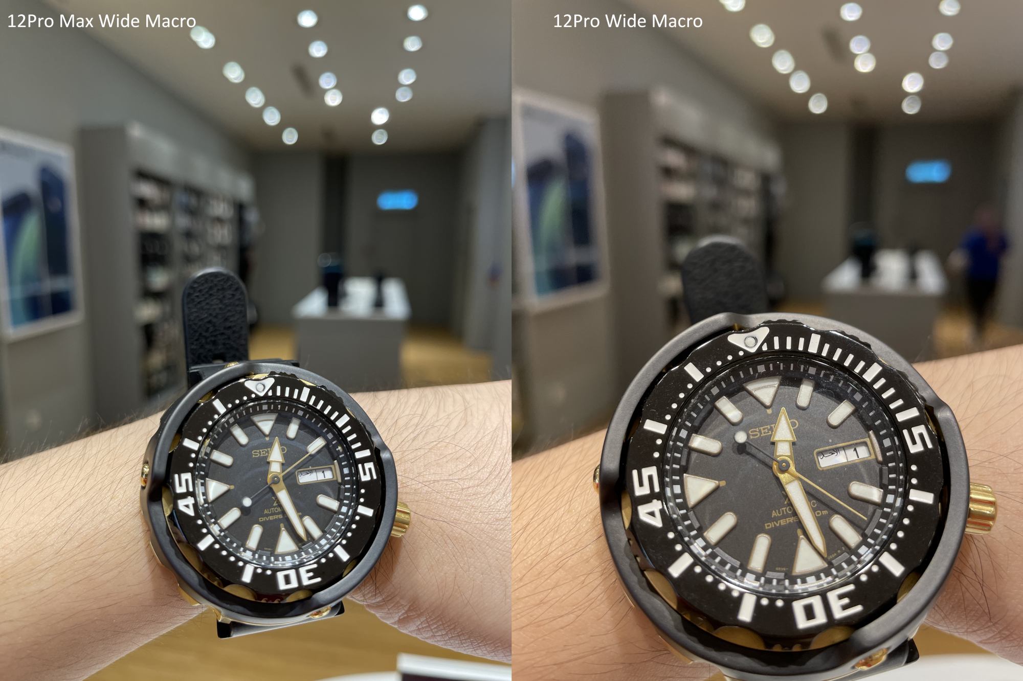

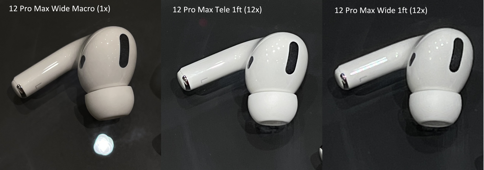

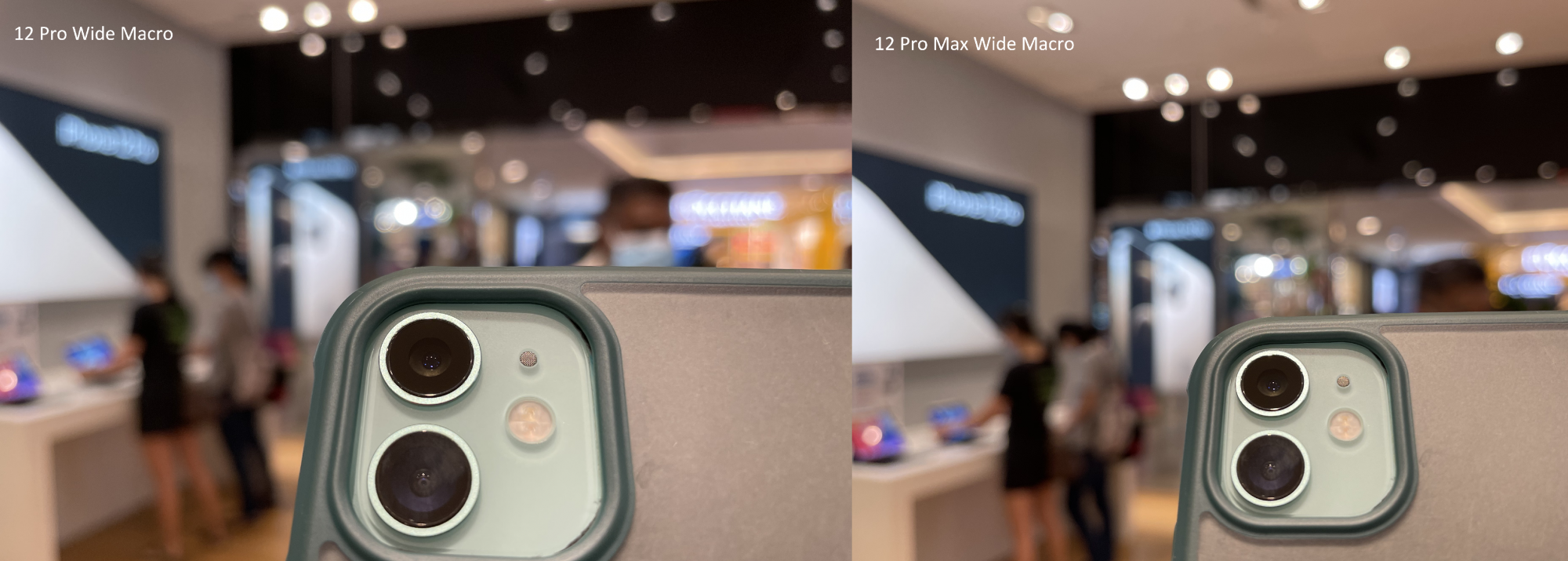

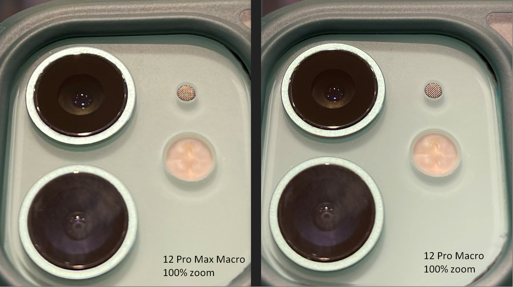

I have gone to the store to try out the 12PM, testing the min focusing distance of 12 Pro/12 Pro Max and my iPhone 11.
Both my 11 and 12 Pro have a min focusing distance of around 3 inches, while the 12 Pro Max is 4.5 inches.
I took a few pictures, observing the detail, field of view, the bokeh. 12PM's came out less detailed, slightly less creamier bokeh, and wider FOV obvious.

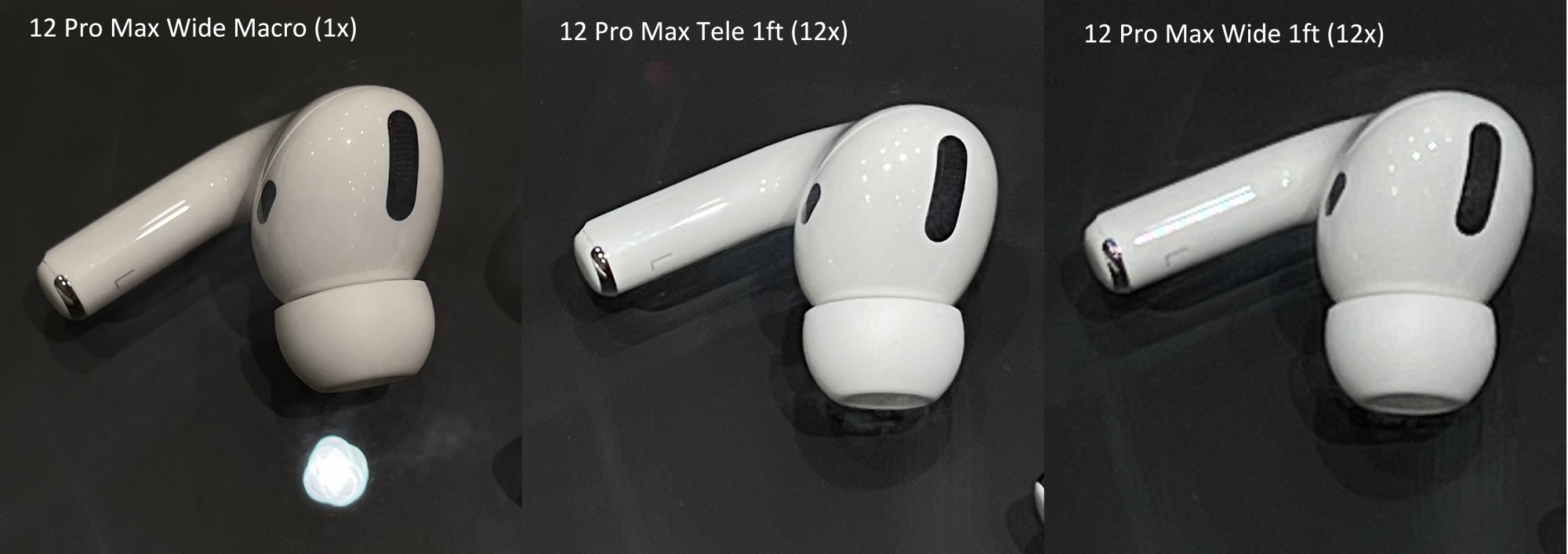

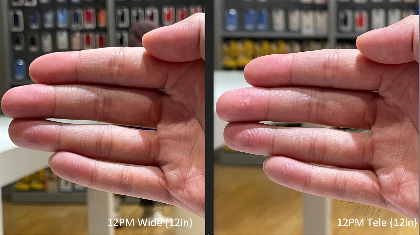

I also took a few shots with the telephoto lens, it is not for macro, despite the 2.5x zoom, the min focusing distance is at least 12 inches away, for that you might as well use the wide lens as it has much better details and noise level.
TBH the difference in detail and noise can be quite noticeable for macro shots when zoomed in, less so for the bokeh. So now I'm conflicted if I should cancel my order for the 12PM. I wish there is something Apple can do in software to at least to improve it a little bit (Note 20 Ultra has larger sensor yet it is able to focus as close as the 12 Pro)

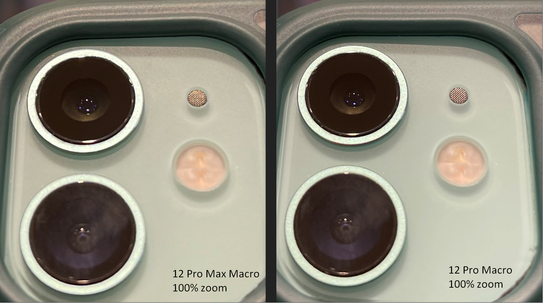

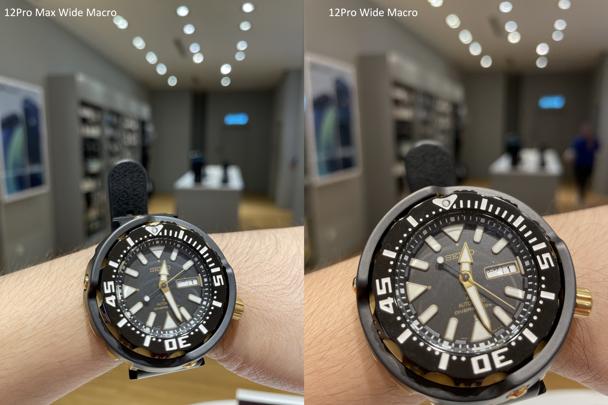

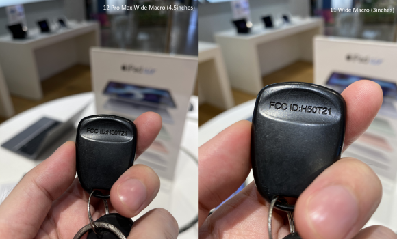

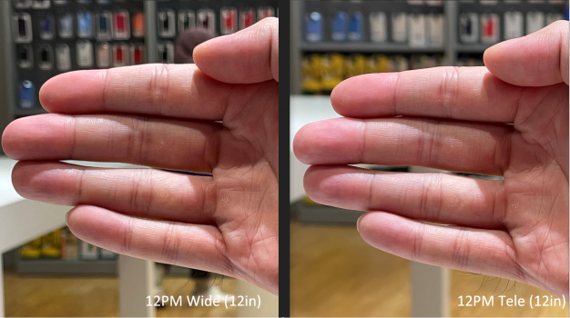

Thank you for posting these detailed images. Your findings concur with my own, in that the 12 Pro gives almost 50% greater magnification at its closest focusing distance vs the 12PM. This is quite discouraging.

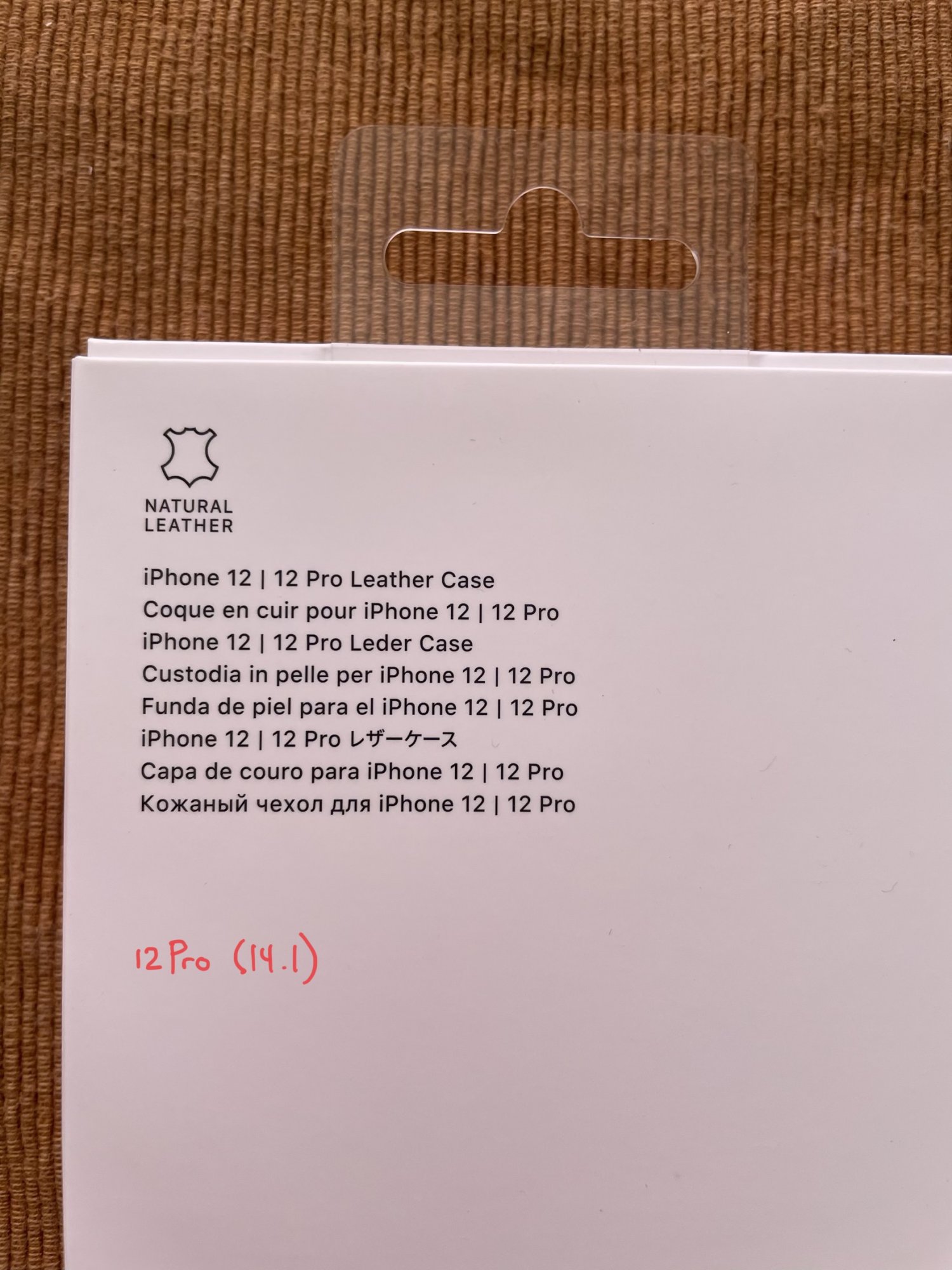

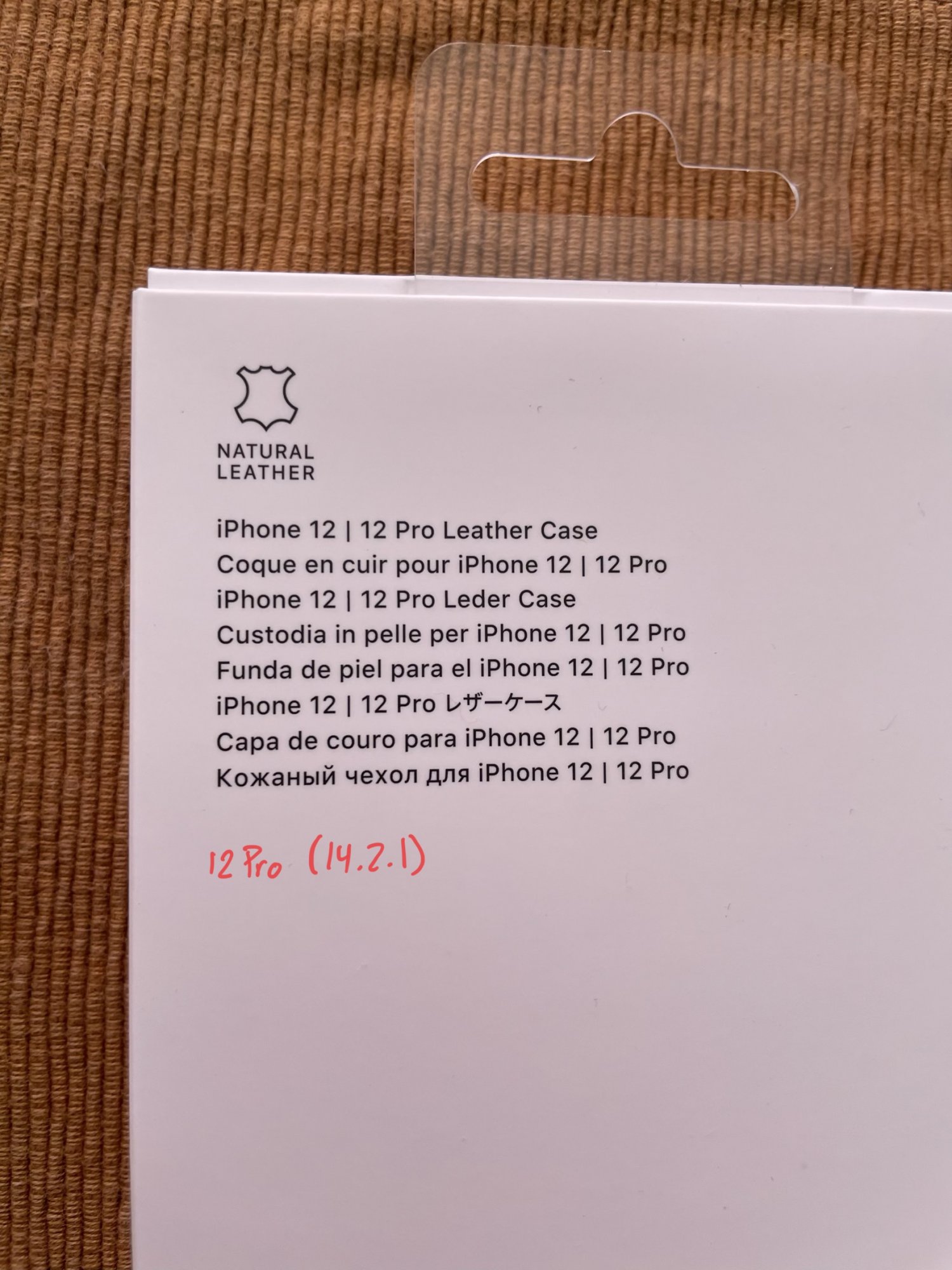

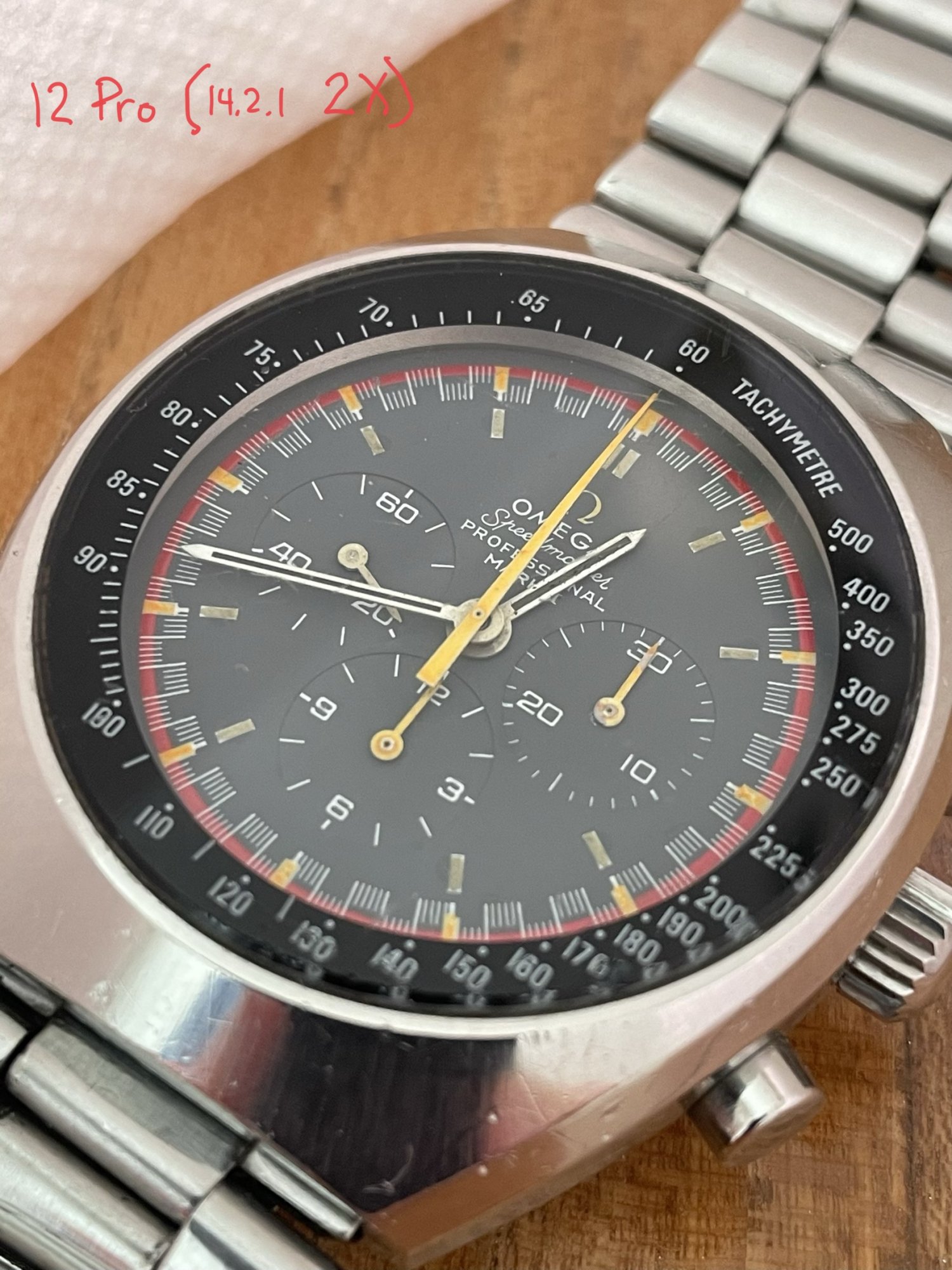

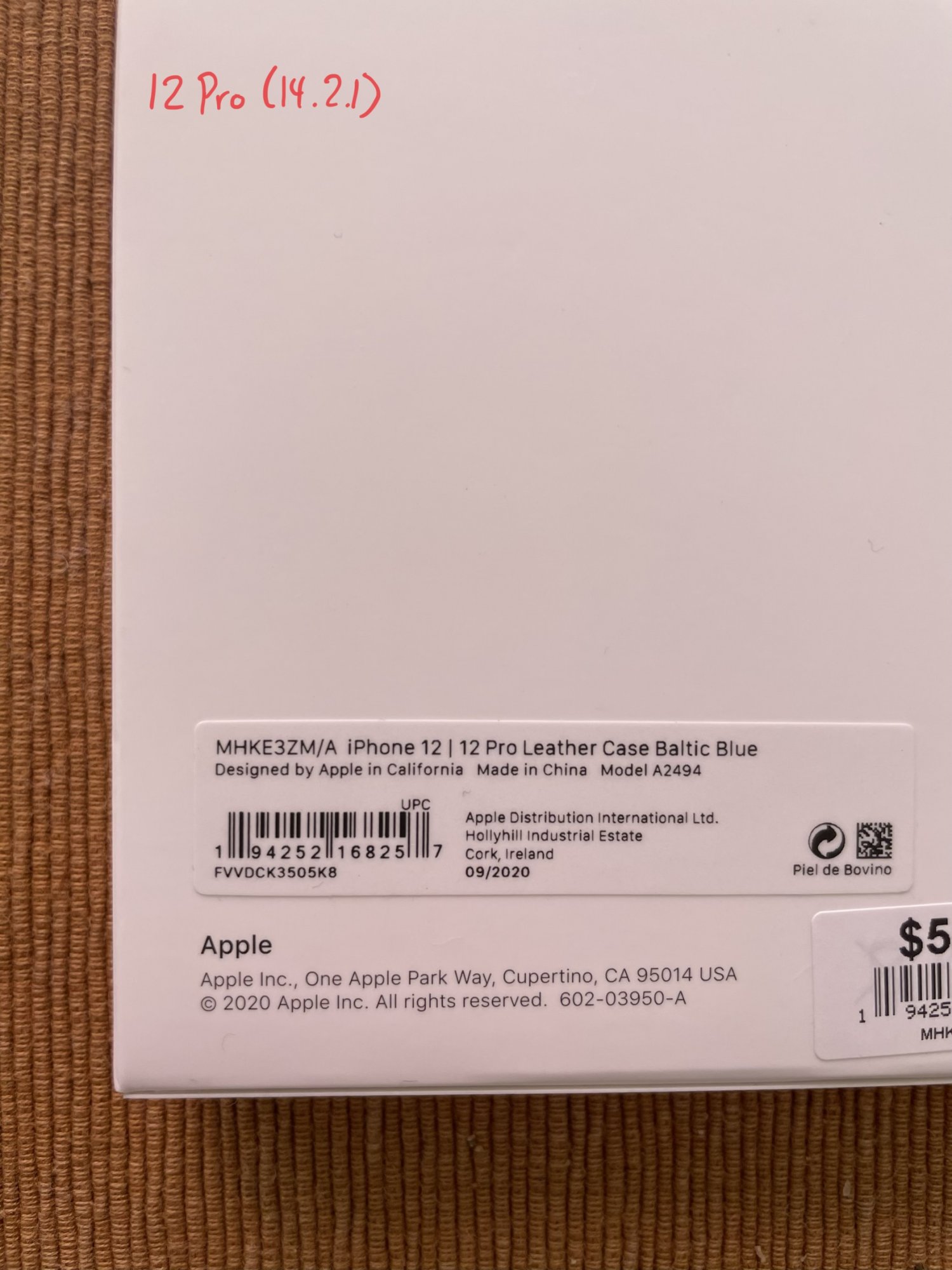

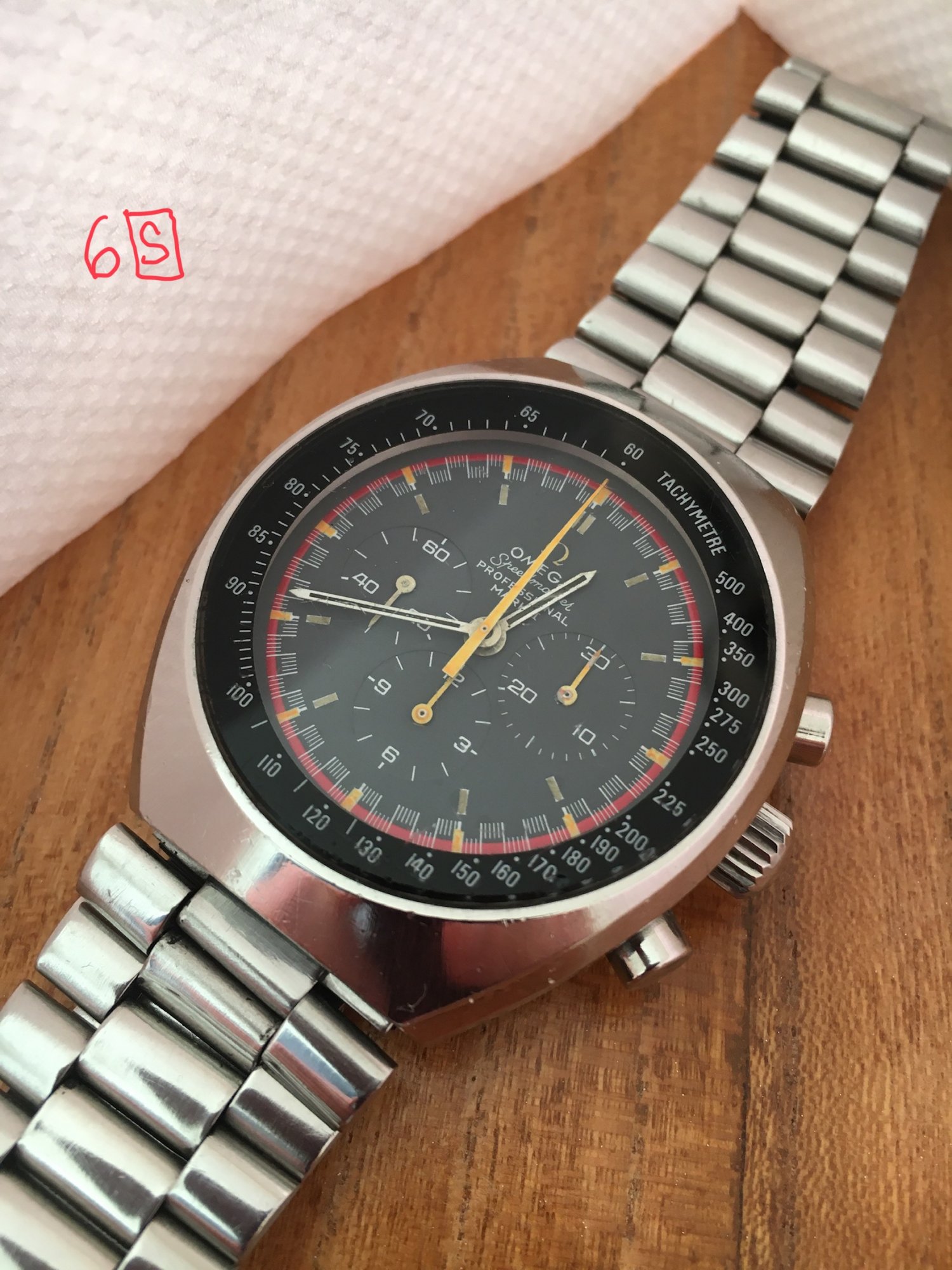

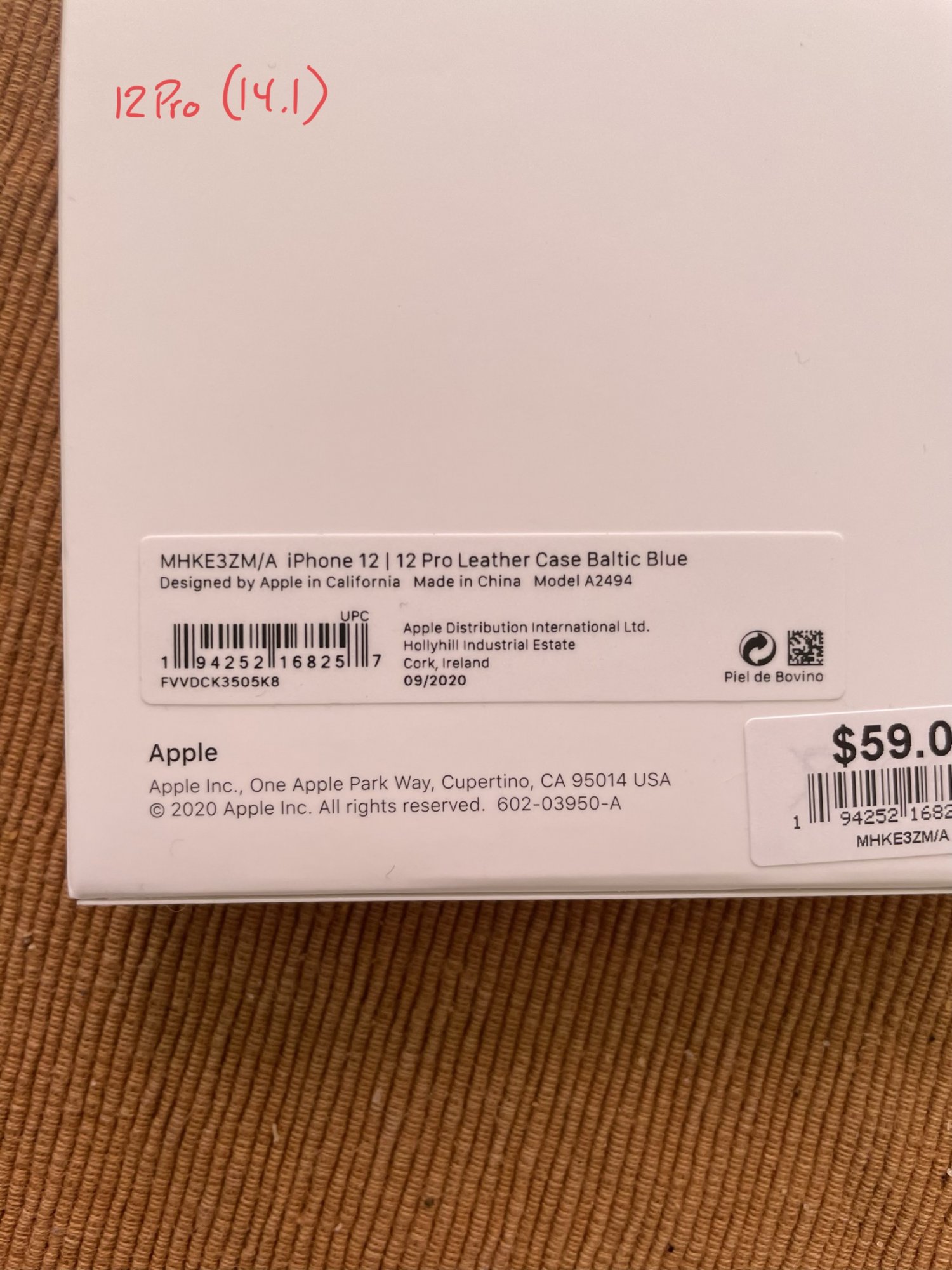

Done!
So... based on this very unscientific experiment (hand-held, using a tape measure to eyeball distance): the minimum focus distance of the 12 Pro did not change from 14.1 to 14.2.1.
What the update addressed was the wonky autofocus behaviour—the iPhone was prone to losing/hunting for focus up close, erratically switching between lenses and not responding to “tap to focus”. The only way to reset autofocus was to pull the phone way back from the subject (or focus on something else.) So I can confirm that this sketchy focusing behaviour was definitely addressed in 14.2(.1).
Based on my measurements though, the 12 Pro’s MFD is still right around 3” (or just a little over that). 6S shot (taken at about 2”) included for reference. If some or all of these look a bit blurry, it’s because I was trying to get as close as I could and was using my iPhone’s screen to judge focus in real time. Backing off a quarter inch in most of these would likely have yielded sharper results.
One thing I messed up: the 2X comparison. I forgot to shoot a 2X pic on 14.1. This is suddenly significant to me because the Pro is definitely NOT USING THE TELE lens on 14.2.1. for close range subjects (tested by covering the Wide lens during these shots. Now we need someone who’s still on 14.1 to test whether the Tele lens was ever being used for closeups! If so, maybe the lens handoff algorithm was too messy (causing all of the focus problems of 14.1) and Apple’s fix was to disable the Tele altogether for macro shots? Just a hypothesis...
I took a “real world use” shot of my beat up Speedmaster with my 6S (1X) and 12 Pro (2X) for an idea of what I’m gaining/losing in this phone upgrade. For me personally, the 12 Pro at 2X is still totally adequate, but for those of you coming from more recent models with better cams (up to and including the 11 series) the loss in MFD could understandably be more significant.
As much as I hate to admit it, these findings do lend credence to the theory that these new 7-element lenses are simply not physically capable of focusing any closer than ~3 inches... although, as an internal optimist, I welcome Apple to prove me wrong!
Hope this helps resolve at least a portion of this debate.

Many thanks for posting these detailed images Johnny. Much appreciated. So looks like the 12 Pro's minimum focusing distance is indeed 3". From what I recall of my visit to the Apple dealer, I am quite certain that the 12 and 12 mini MFD was also 3". By the way, the white balance on your 6S is much more accurate than the 12 Pro. And I can confirm that the MFD on my iPhone X is 3.25" approx with the standard wide lens, and approx 4.75" with the tele lens.
He may have a defective unit then. Most of them, which I feel are not defective, focus up to about 4.5" as I believe that is the min distance of this lens. Mine never has a problem with focus >4.5". Again some units are defective. Mine is not.
My pleasure.👍
And regarding the white balance of the 6S, good on you for spotting the difference. And here’s a surprise: it’s actually the 12 Pro that nailed the white balance in this instance. The daylight in the room was actually very warm (there’s a pink house next door that reflects a lot of warm, often pink light through the windows). The 6S tried to artificially cool down the whites to a more neutral temp.
By and large, my 12 Pro does a better job of capturing/reproducing true-to-life light, colour and dynamics than most of my expensive dedicated cameras. Obviously shutter speed and lens quality are still a long ways off, but it’s pretty damned amazing what this computational stuff can pull off in the literal blink of an eye.
