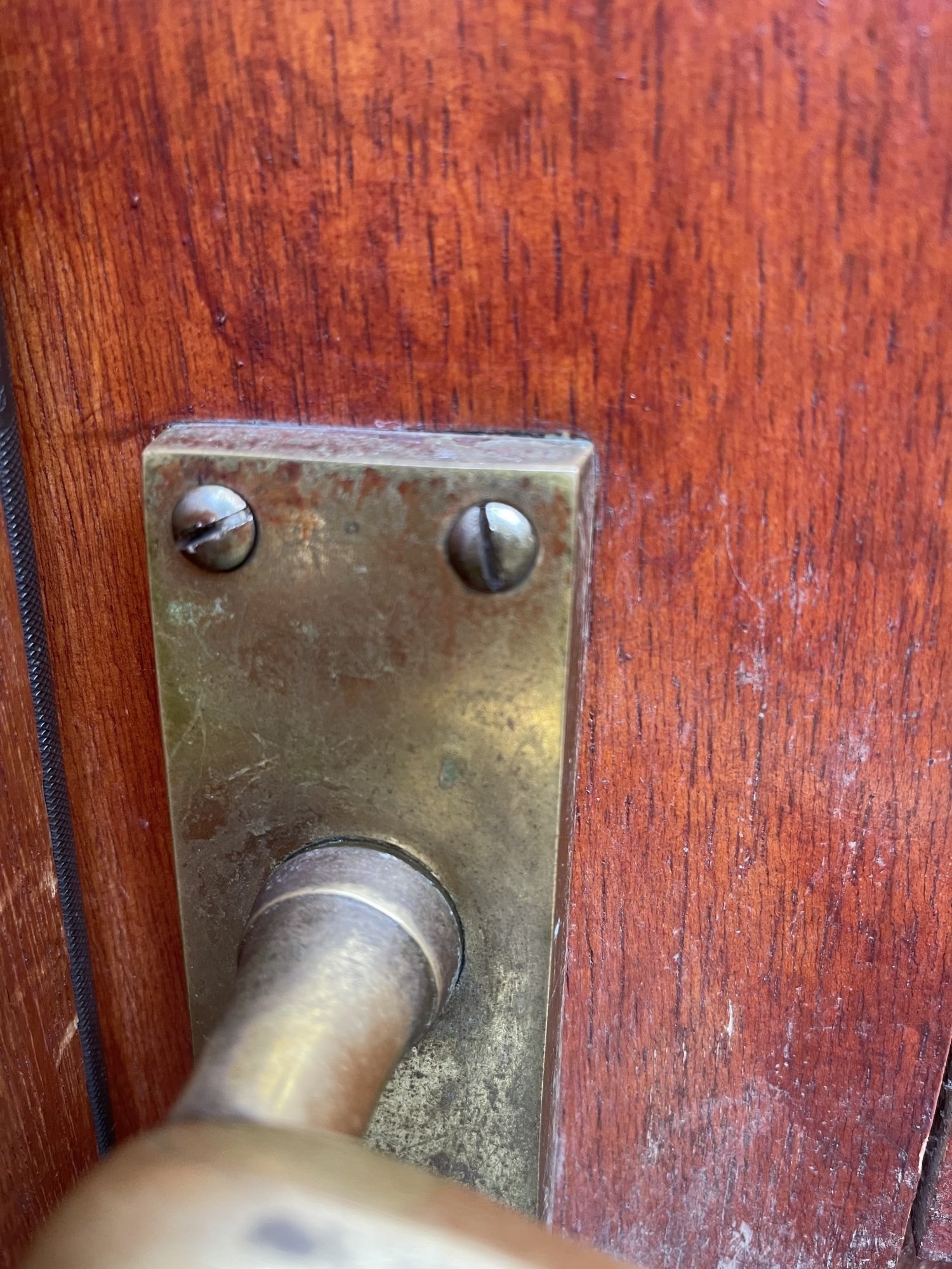

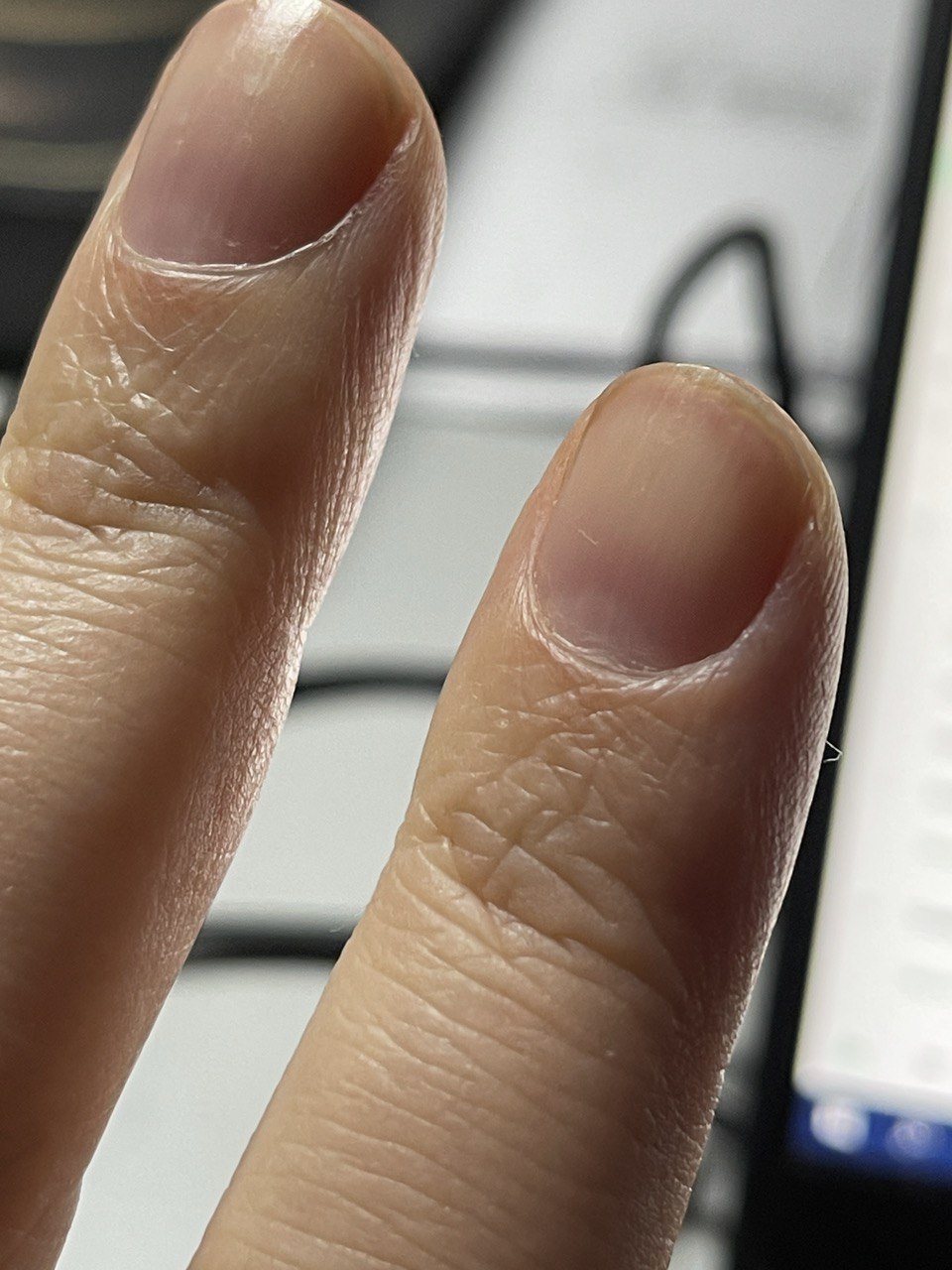

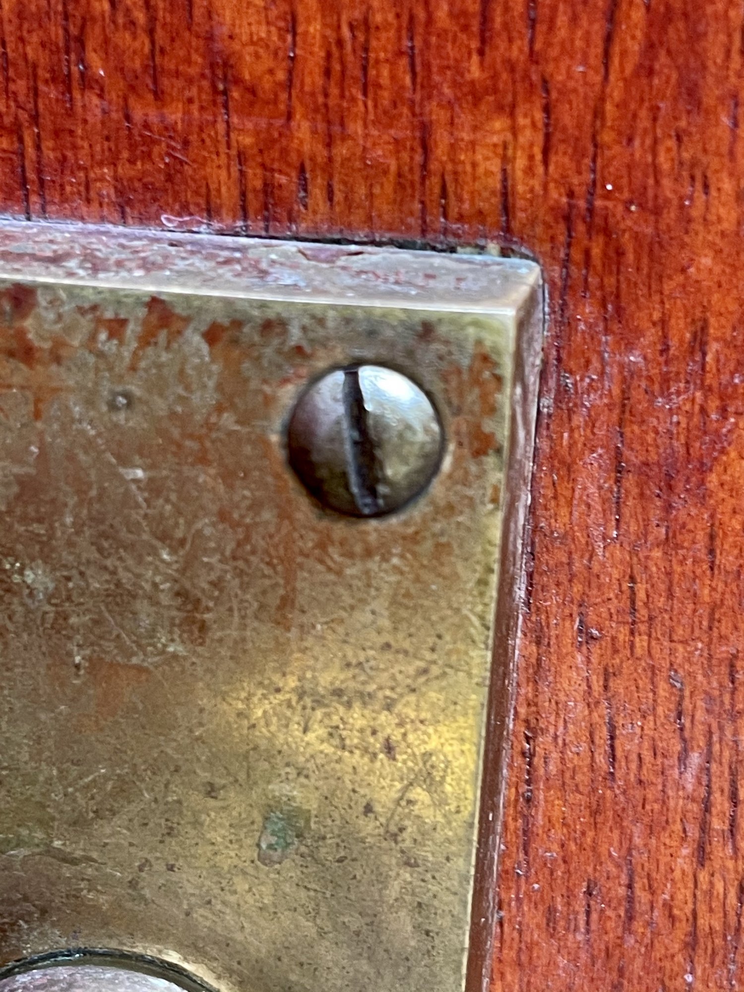

I’ve a feeling it’s software. Here’s a couple of shots showing the closest I can focus with the normal lens, compared to the zoom lens, which is perhaps not surprisingly, a lot closer 😀
Focusing was a bit better than the photos, I’m shaking about thanks to my stupid nerve damage and the cold, with the snow today.
Based on my testing, any subject closer than 12 inches, the telephoto lens will not be used, and instead it’s just a digital crop of the normal wide angle lens.

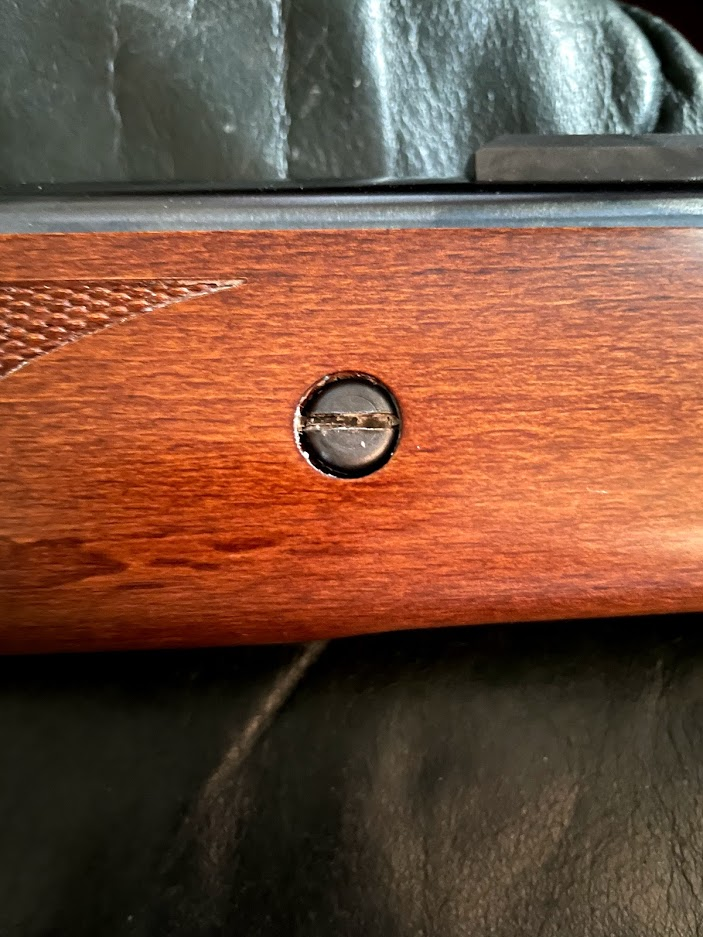

Sorry guys, I have a 12 pro max and when shooting a macro, if I want to get closer, I hit the 2.5 zoom and that trick solves the problem. For the video, the same. Therefore, it looks like it's a software problem that does not change the lens automatically when closing up. An example below...is that enough for a macro?

While that might give you a macro type shot. It’s not the same thing as focusing closely with the main camera.

No it’s not the same thing, but apart from I wrote that it needs a fix, what exactly it’s the point of focusing closely if not for taking a macro shot? Am I missing something? My point was to show that the camera is capable of focusing very close, and apparently it’s not a hardware issue

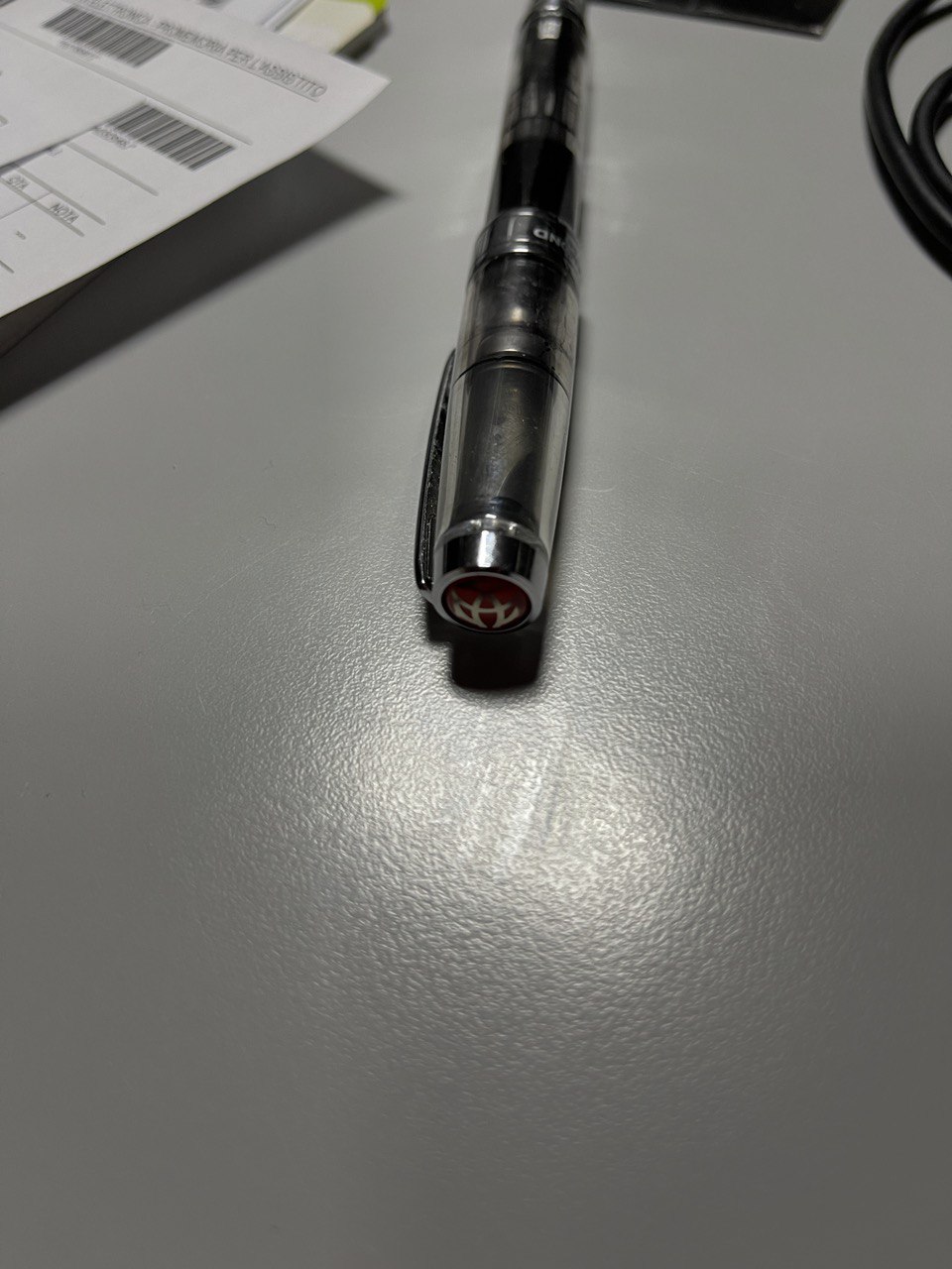

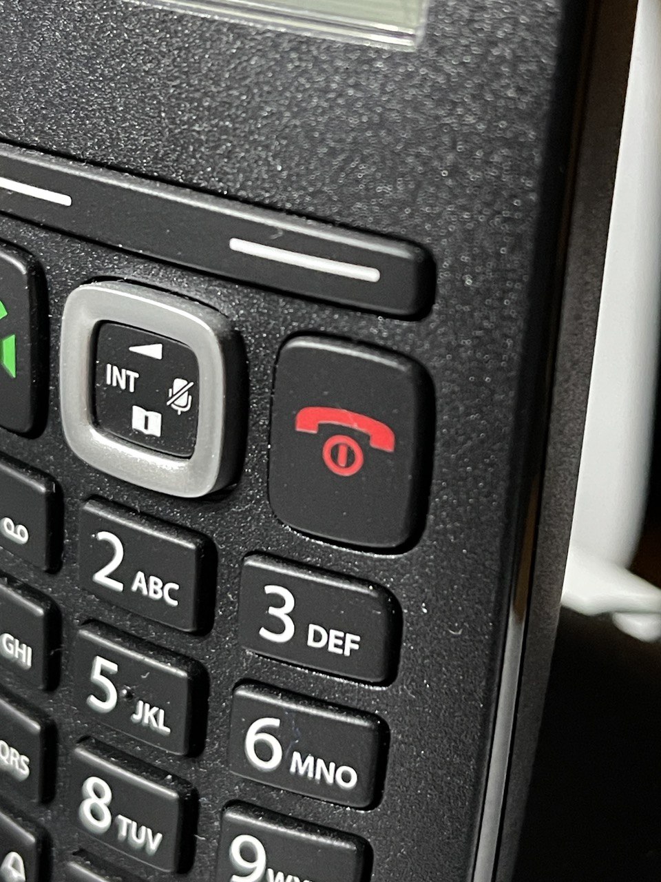

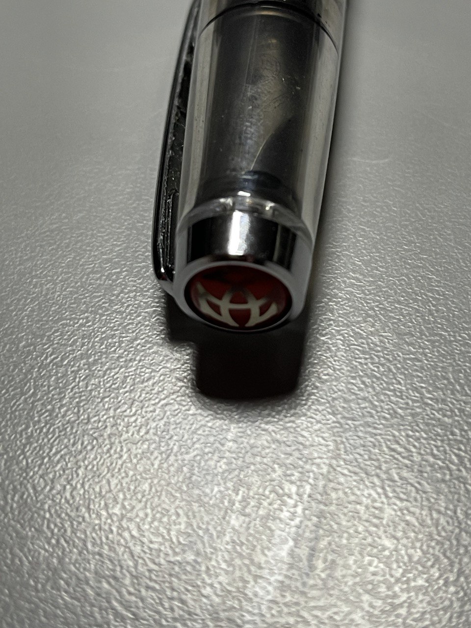

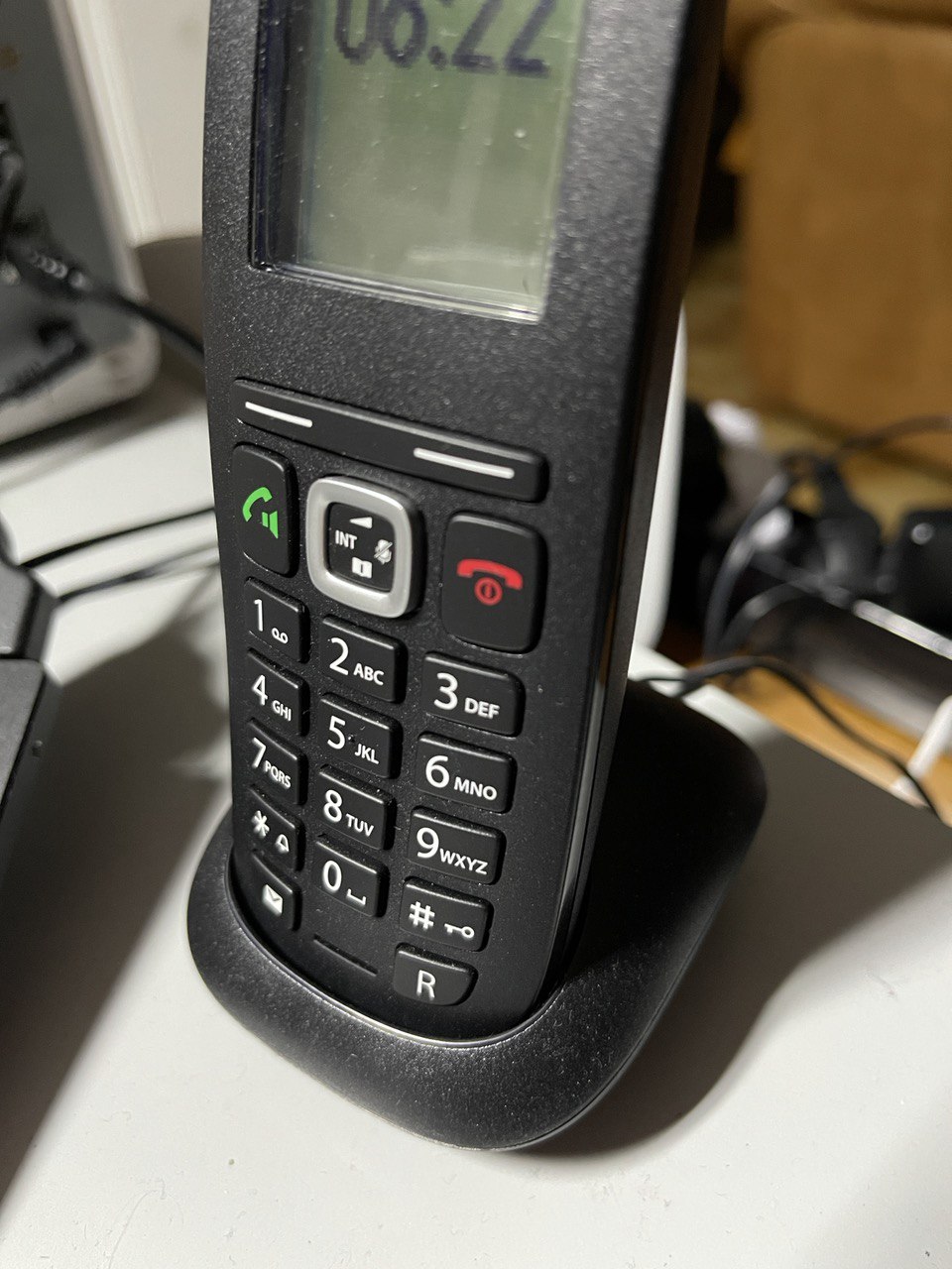

Sorry for I use other metrics, 12 inches = 30 cm definitely not my case. I can focus with normal lens until about 8 cm or 3 inches, then I press the telephoto and this is the result, indoor and artificial low light:
each couple, first pic is normal lens, second telephoto from there.

Have you tried putting your finger over the Tele lens while you take that shot? I would wager the phone is playing a trick on you. My 12 Pro switches to Wide on the 2X zoom for any subject closer than 15-20 inches.
Also, as has been discussed ad nauseam in this thread, it’s actually not physically possible for the 12PM Wide lens to focus closer than 4.5 inches (11.4 cm). That’s been established as the minimum focus distance of that lens. Try measuring from your lens to your subject with a tape measure and you’ll see. 🧐
All told, it’s not perfect but I still find the macro results using 2X zoom to be pretty usable on the 12/Mini/Pro.

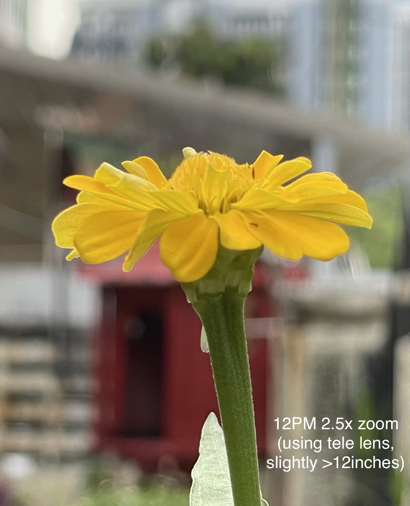

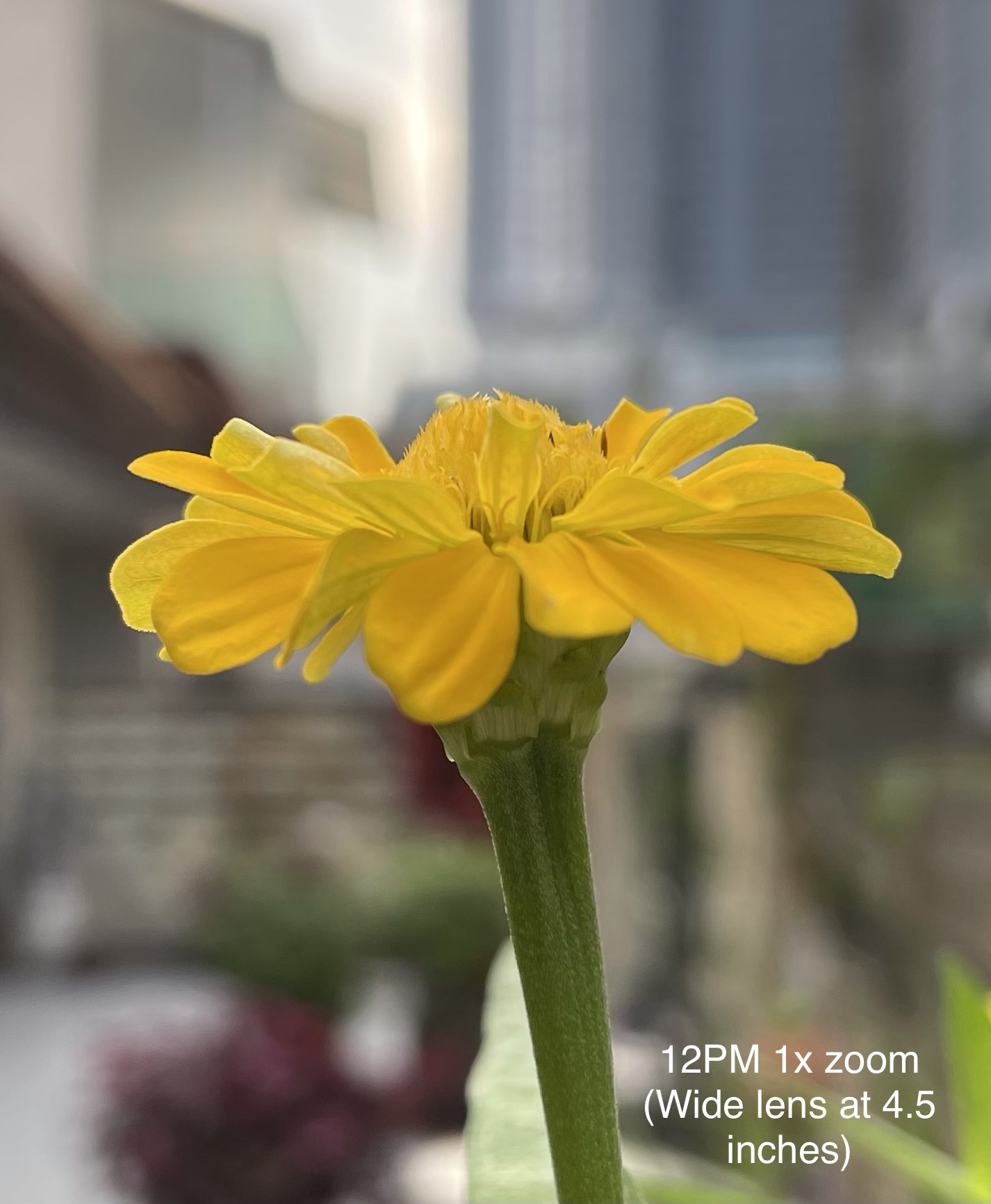

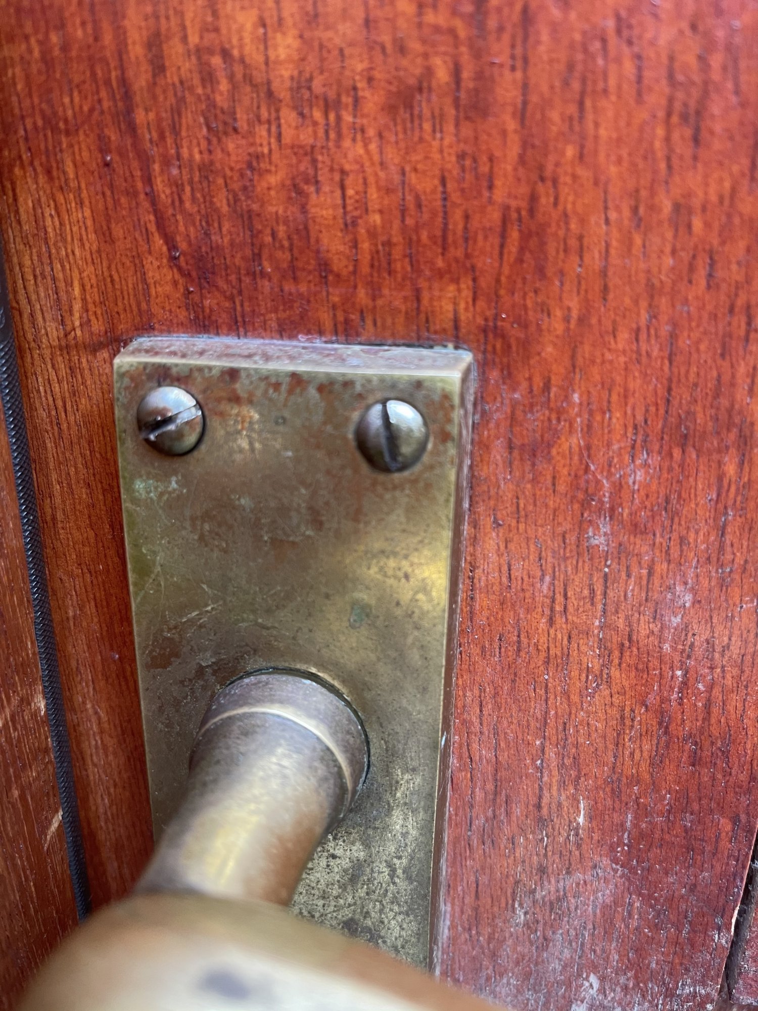

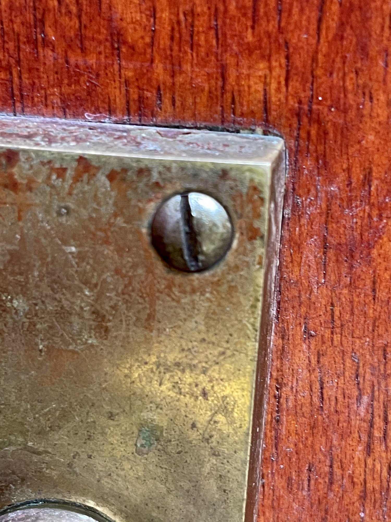

I retested again outdoor with good lighting.
It confirms the focus distance for the tele lens is >12 inches (>30cm), and for wide lens it’s 4.5 inches ( ~12cm)
aside from the background compression, the close up shot taken with the wide lens has better details in general. Look at the stem and the disk flowers. The difference is small but noticeable.

My 12PM does not switch automatically, I have to press manually 2x to use tele or .5 to use ultrawide.
But with tele I can shoot very nice macros.
Thanks for the correction about the minimum distance. So if it's the minimum distance for the wide lens is 11.4, my phone is doing correct.
Since I am new to iphone, I don't get what should be the correct behaviour of the camera: if I use tele it is supposed to switch automatically to wide when close up?
