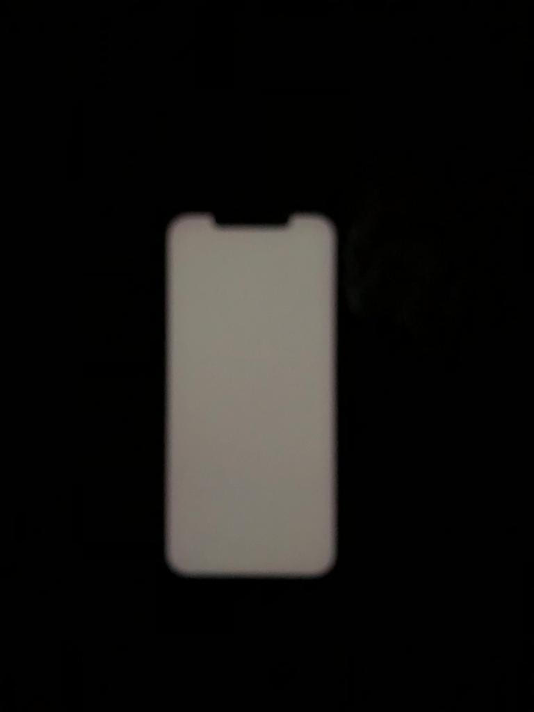

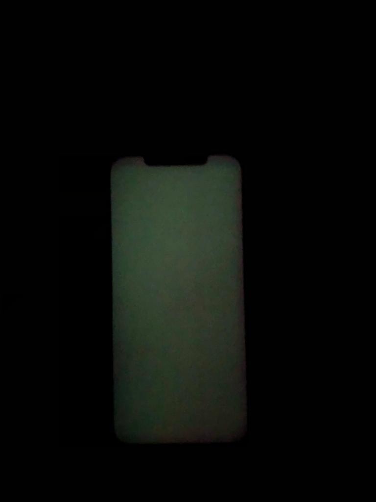

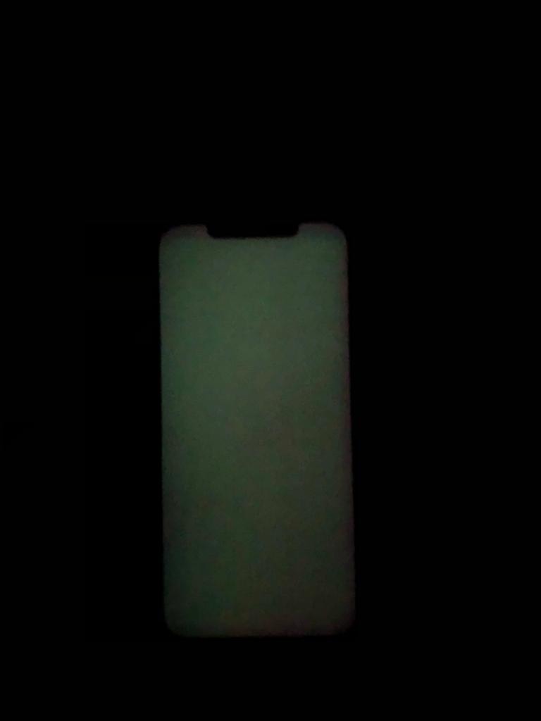

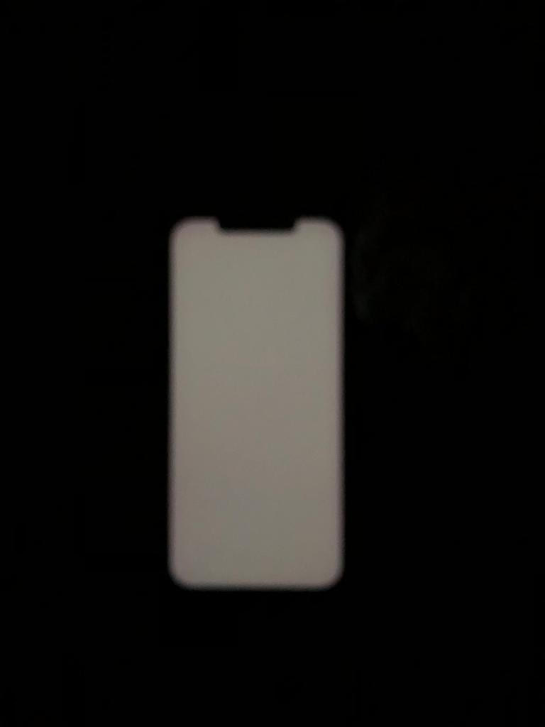

Wrote with apple support and they said the know the problem and will fix them.
Showed them also the green tint on 0% brightness. He was shocked.
He said they will show this to the engineers and they working on a fix.

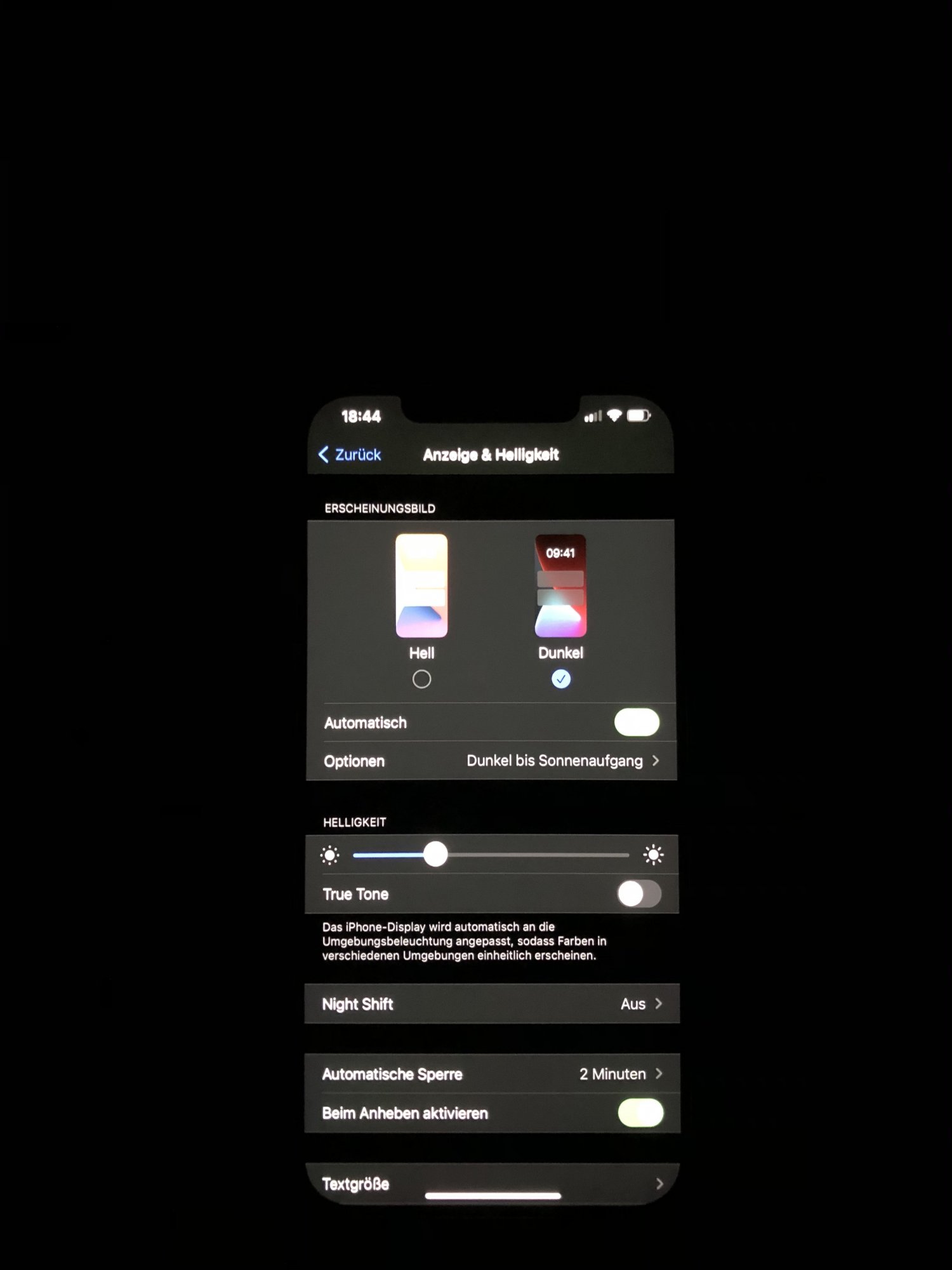

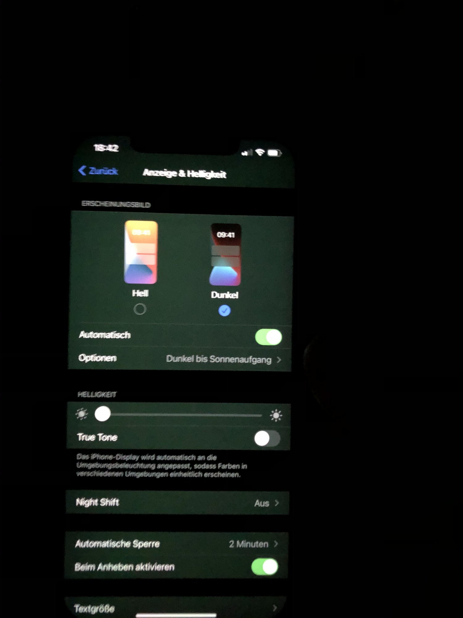

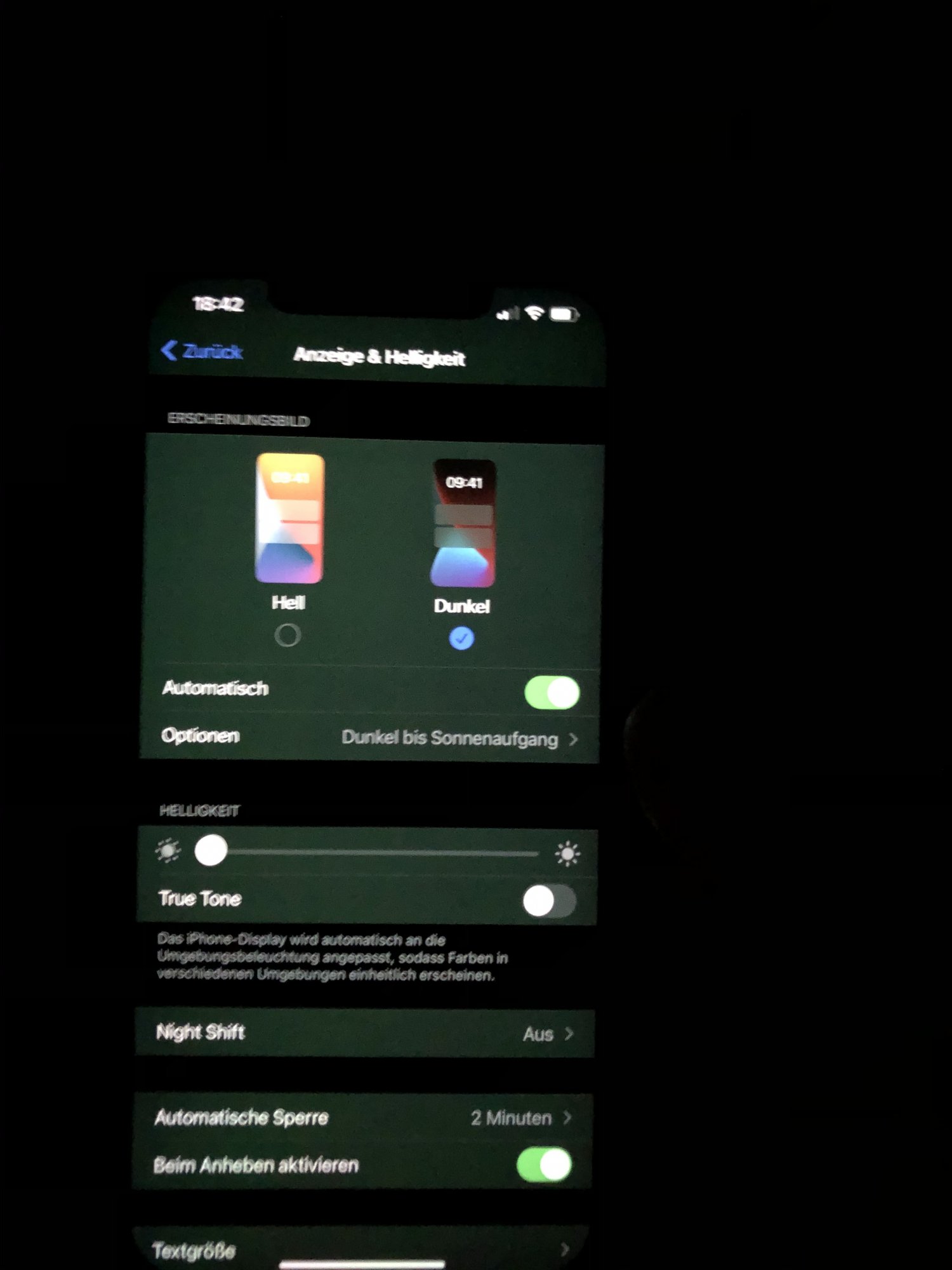

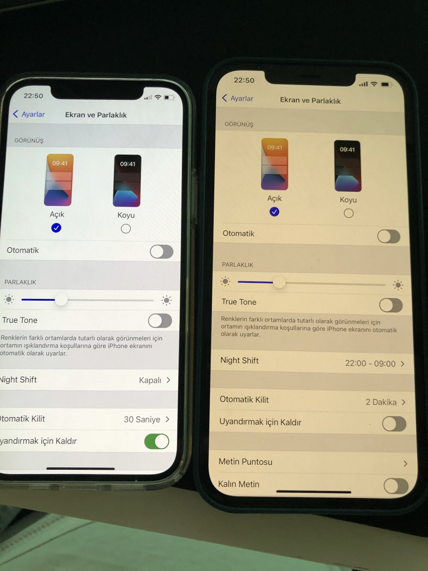

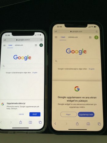

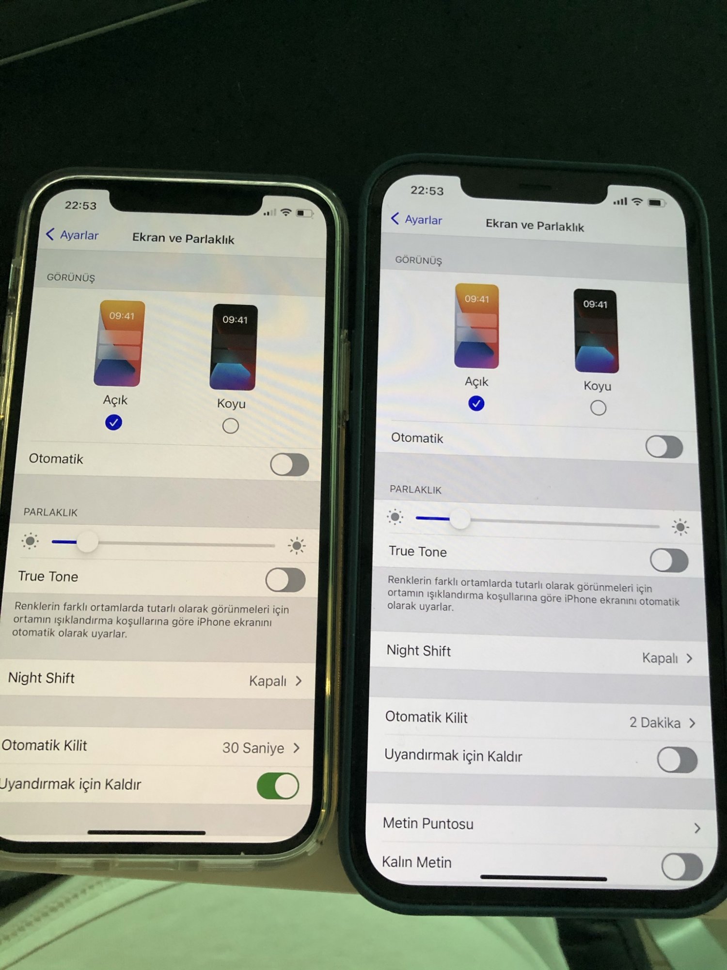

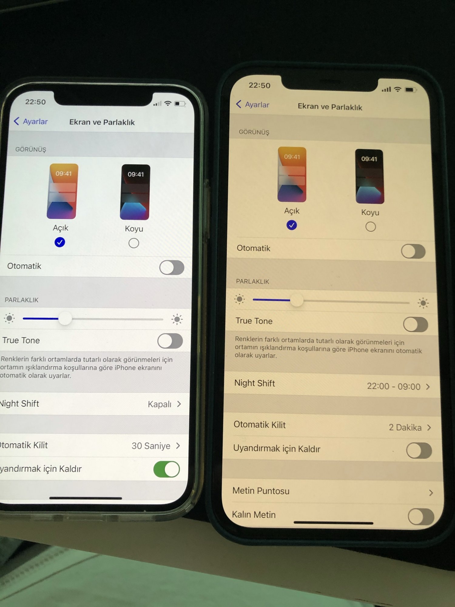

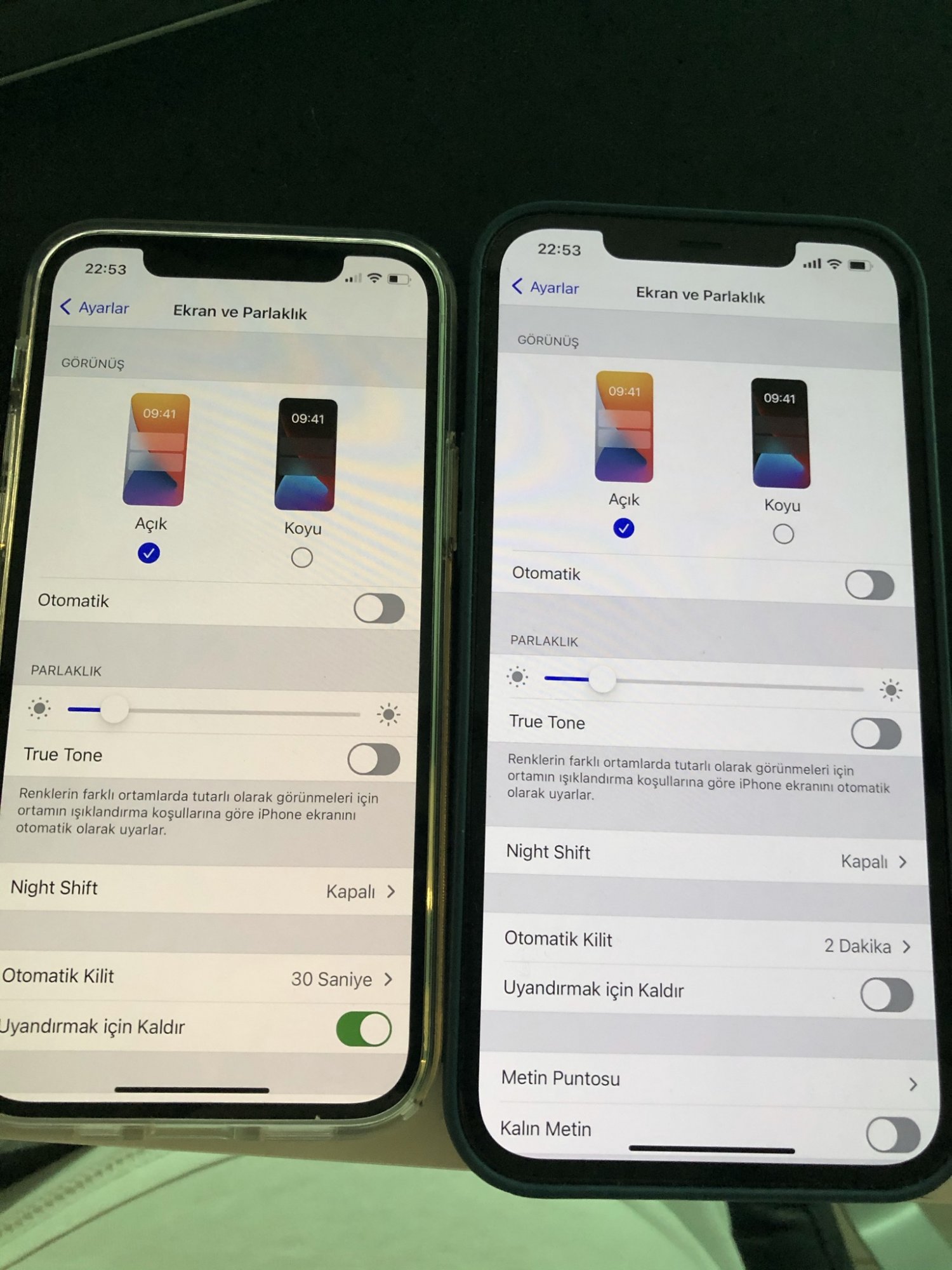

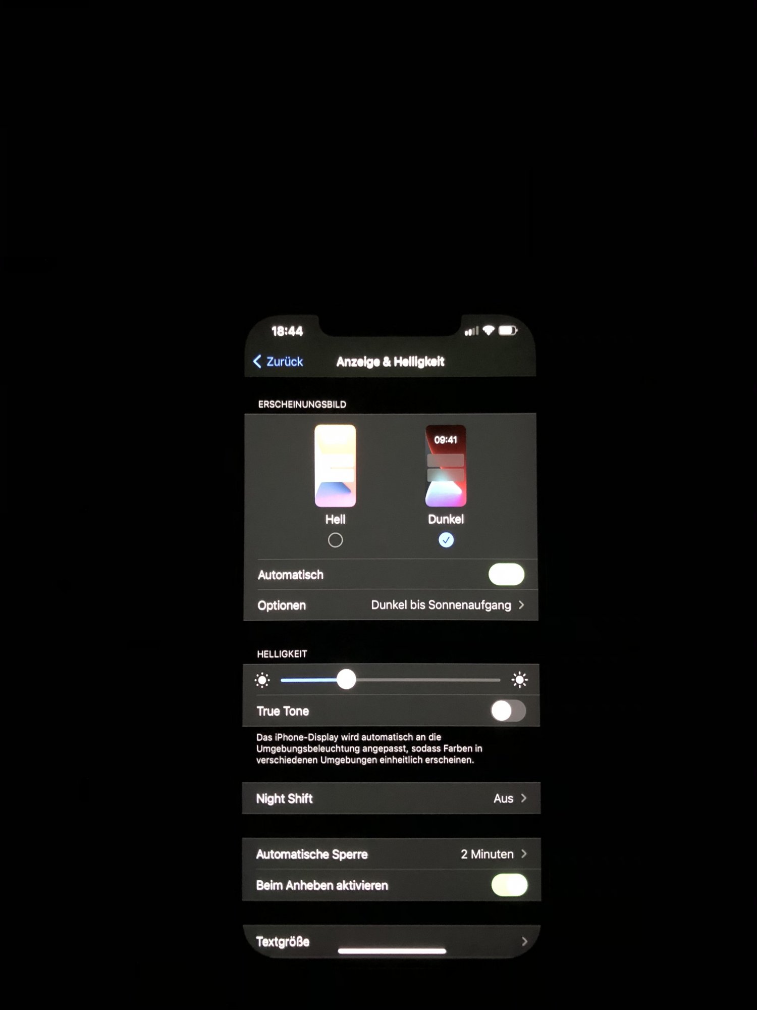

all 12 pro max have this yellow tint isssue? After comparing with my daughters 12 vs my 12 pro max .
This looks really strange ..
Post a picture from both smartphones from brightness settings screen again.
Look likes night shift or do you troll?
