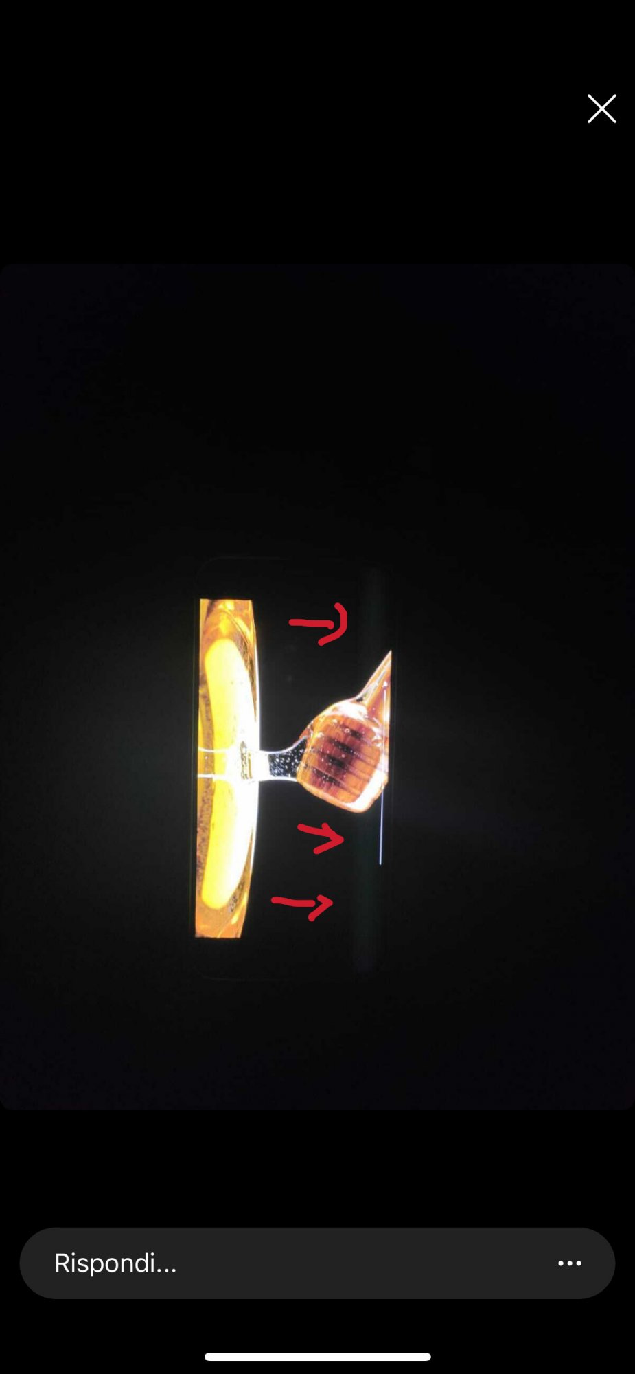

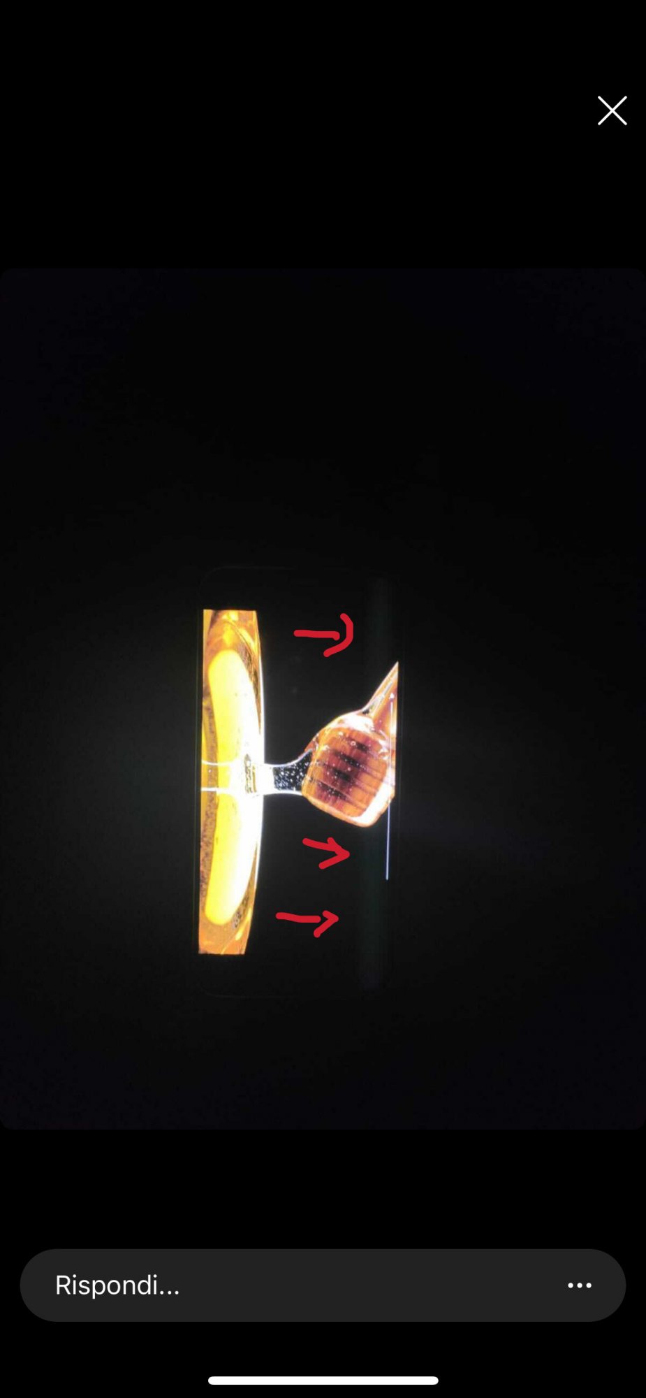

I see this green line always but only if I open the YouTube application on my iPhone 12 pro and start a dark video, and increase or decrease the volume .. when the volume bar appears this green line appears that I hate .. more increase the brightness and more you can see .. for the rest I have no problem with green tint but only the classic yellow calibration of this year's iPhones that we all have .. if I open YouTube from safari the problem is not there because the volume bar has a different graphical interface .. I don't understand if it's a bug on all iPhones because it's a YouTube bug or just mine.
Can you replicate this?

The only thing I notice is the problem with the volume bar on the YouTube app.

More than the colour, I am concerned about the glow at the top(which we can see while increasing or decreasing the volume in YouTube app).
Now, that you were able to notice this issue. I am very much certain that it's not completely fixed for anyone.
Whomsoever, claimed that it's fixed for them are not able to replicate the issue.
I have the grey bar too….no green.
A green or red push in greys is not unusual on oled screens due to the lithography process.
I went through quite a few mini‘s to get an even screen, it’s a lottery.
So, the hint of green on that bar, while changing the volume will be considered as norma?
