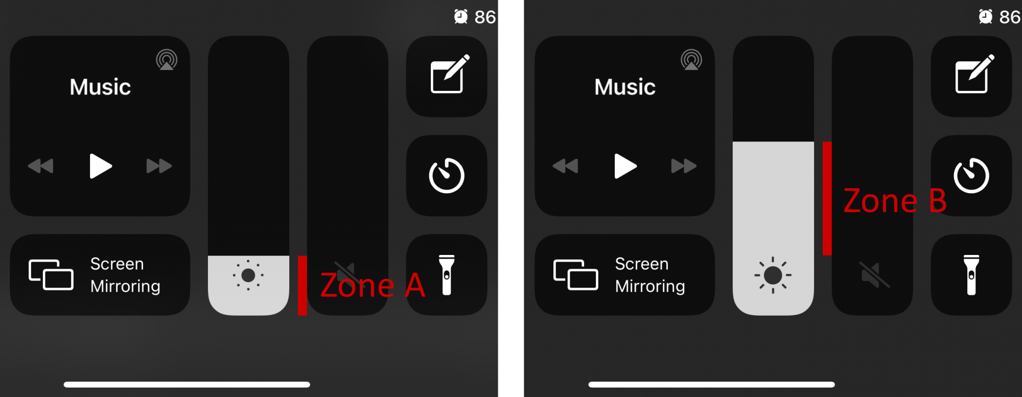

Okay, I was finally able to replicate this on my 12 mini (unfortunately).
One important thing is not only to be in a 100% blackened out room, but also to let your eyes adjust to the darkness for 1-2 minutes (which I didn't at first). This is just to set up proper testing conditions. Some people will likely be able to notice the effect in less strict conditions as well, depending on eyesight and sensitivity.
Testing procedure:
  1. Turn off Auto-Brightness in Settings. This is not strictly necessary, but ensures reproducible brightness levels.
  2. Start the all-black video from the first post, so that it runs in full-screen mode in Safari. The video runs for an hour, so you have ample time for the following steps.
  3. Select some brightness level via Control Center.
  4. Exit Control Center, back to the fullscreen all-black video, and wait until after the bottom slide bar has disappeared, so that the screen becomes completely black.
  5. Observe an effect (or don't). 😉 (see below)
  6. Repeat from step 3.
There are three different effects, in my opinion. The first two (maybe all three) depend on the brightness level. The following screenshot shows two brightness zones A and B (as accurate as I was able to determine them). EDIT: Important: This is in landscape orientation. The relative position of the sun symbol is different in portrait orientation.
Effect 1: If the brightness level is within zone A, the raised blacks are permanently visible in the video. However, the lower the brightness within that zone, the more it approaches true black, by virtue of the lower brightness. For me the easiest way to reproduce it was to set the brightness level such that the slider position is on the top "dot" of the sun symbol (in landscape orientation — the position is different in portrait orientation).
Effect 2: If the brighness level is within zone B, the raised blacks are visible until about 3 seconds after the slide bar disappears. After that, the screen turns true black again. If that was the only effect, it wouldn't be much of a problem.
Effect 3: I don't know how to reliably reproduce that one. I only saw it two times by chance and afterwards wasn't able to reproduce it again. The brightness was somewhere in zone B when it happened for me. The effect is the one already described by others, where the black starts to flicker on the screen. For me it was just a short flicker that didn't repeat, and it appeared to me that it was a little brighter than the raised blacks of effect 1 and 2 above. It happened maybe 5-10 seconds after exiting the Control Center.
So, I hope that makes it easier for people to see if they can replicate the problem. And maybe someone will come up with a way to reliably reproduce effect 3.

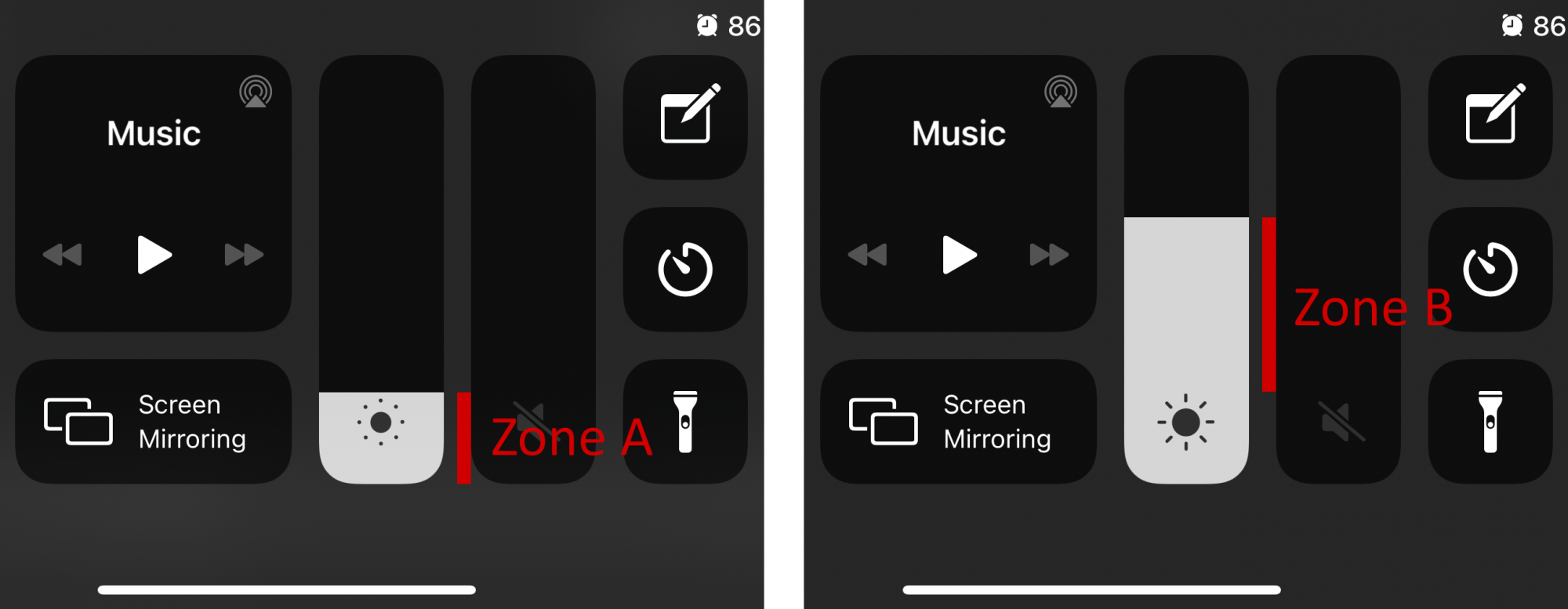

Testing procedure:
Effect 1: If the brightness level is within zone A, the raised blacks are permanently visible in the video. However, the lower the brightness within that zone, the more it approaches true black, by virtue of the lower brightness. For me the easiest way to reproduce it was to set the brightness level such that the slider position is on the top "dot" of the sun symbol.
