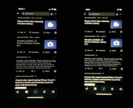

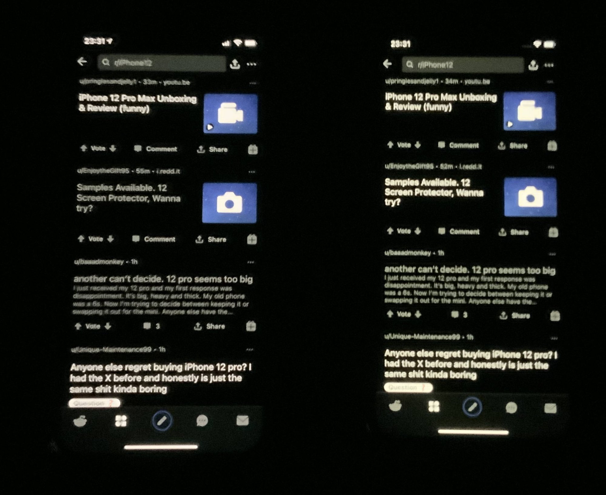

I've tested my iPhone 12 Pro and iPhone X in a pitch black room (It's night here).
Left is 12 Pro, right is X.
Both the same brightness (under 15%).
I don't see any difference.

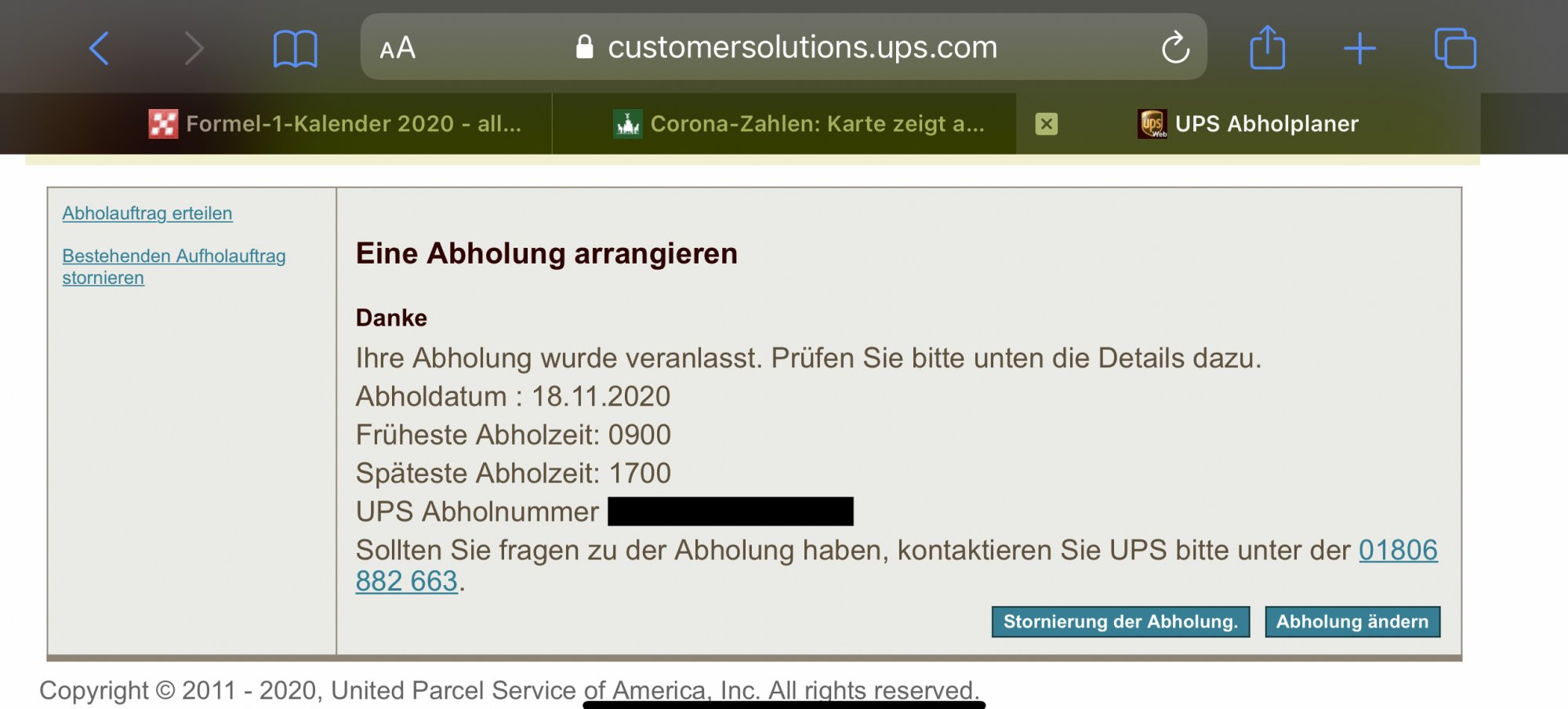

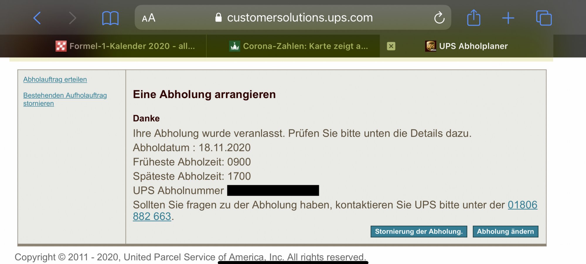

wow now i am seriously confused. How a direct picture of my screen with the two buttons on the iphone shows me this yellow tint picture. the yellow follow a circle! As child we learnd never to play with an magnet nearby electric components. But todays iphones have a round magnetic field to positioning the wireless charging cal it MagSafe!
