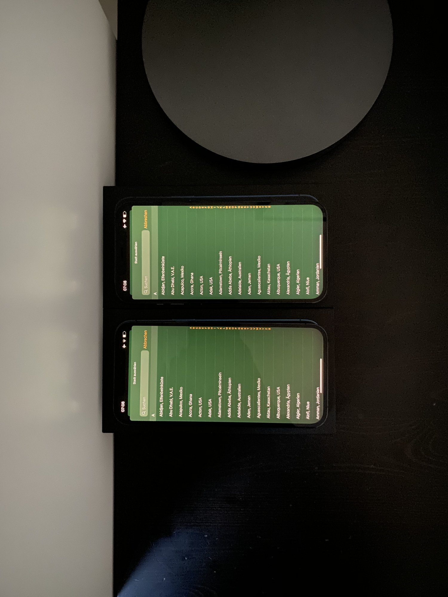

I've tested my iPhone 12 Pro and iPhone X in a pitch black room (It's night here).
Left is 12 Pro, right is X.
Both the same brightness (under 15%).
I don't see any difference.

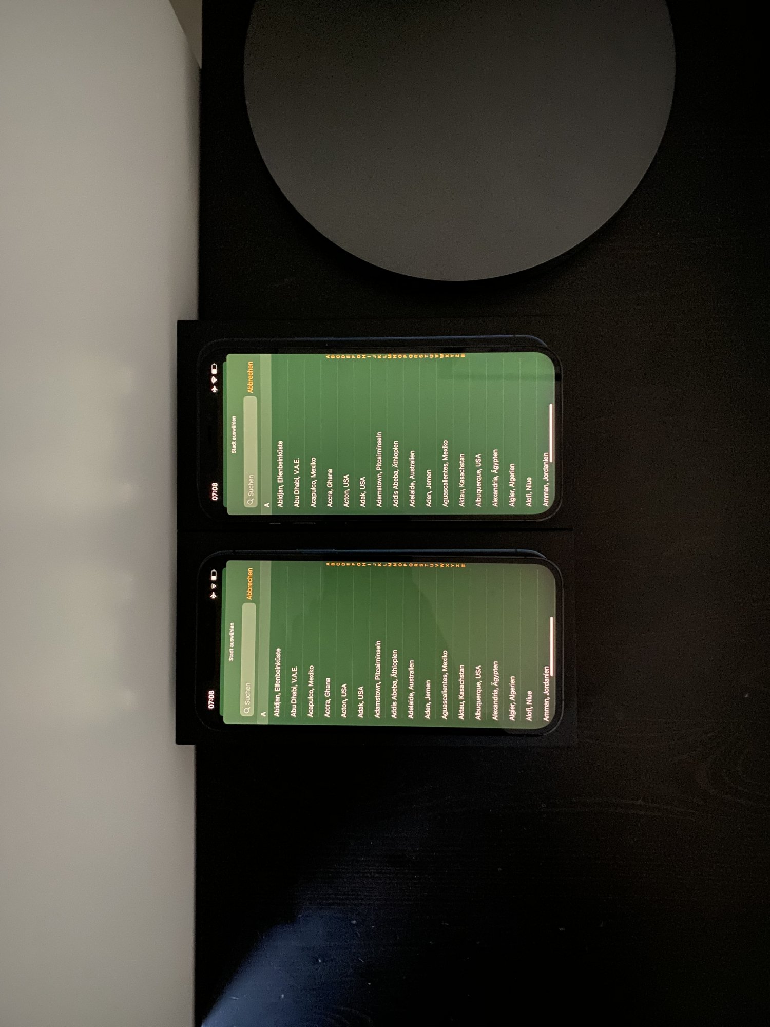

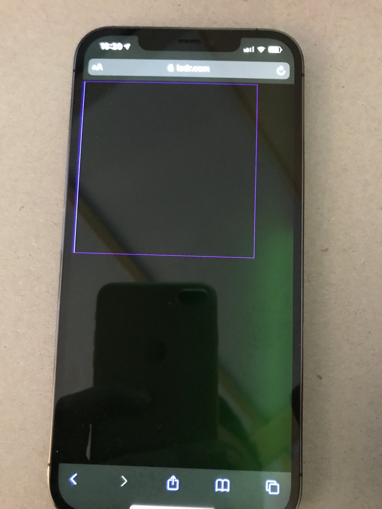

I've tested again my iPhone 12 Pro and iPhone X around 40% brightness in a pitch black room.
Yes, you are right. I can see strange green light bleeding and flickering, especially the top of the screen.
It's very hard to see in the photo, so I changed exposure a bit.
12 Pro on the left, X on the right.
Hope iOS 14.3 fix this issue.

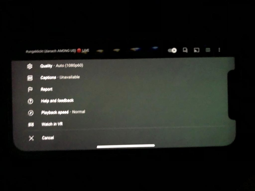

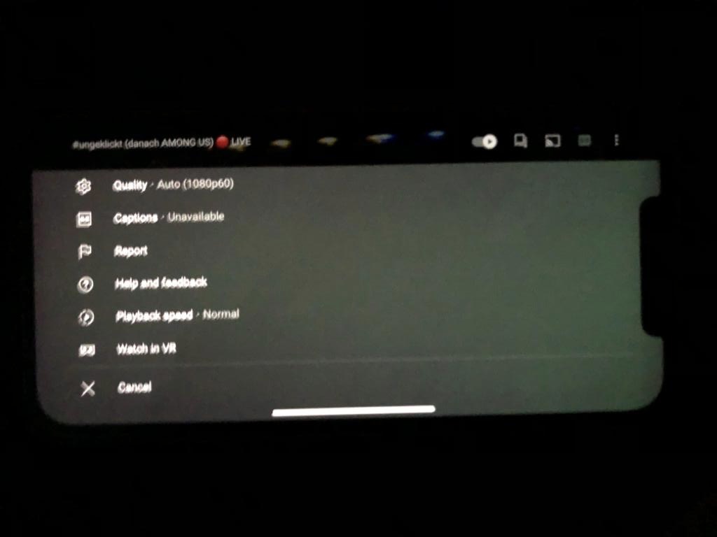

On my 12 Pro Max, i noticed another thing. Only if the brightness is set to 0%, the top portion of the screen has a different tint to it. You can test it in the YouTube app in dark mode, by tapping on the three dots. If I rotate the device, it is still on the top portion (where the notch is).
Anyone having this issue as well?

I can see that on my 12 Pro too.
