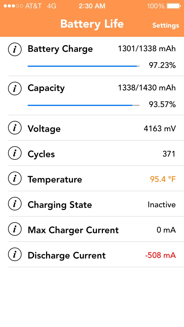

Launch day Verizon iPhone 5. I've been using it on my AT&T line for most of its life. 🙂 Sent from my iPhone 5.
Posted a shot of slightly differing results while phone is discharging, same phone. Originally 1332 capacity, now 1338. Cycle 371.
