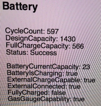

Here is mine again after these many charge cycles.. I think it has gone bad..because apple says it should be about 80% after 500 charge cycles..but looks like mine won't make it..:confused:

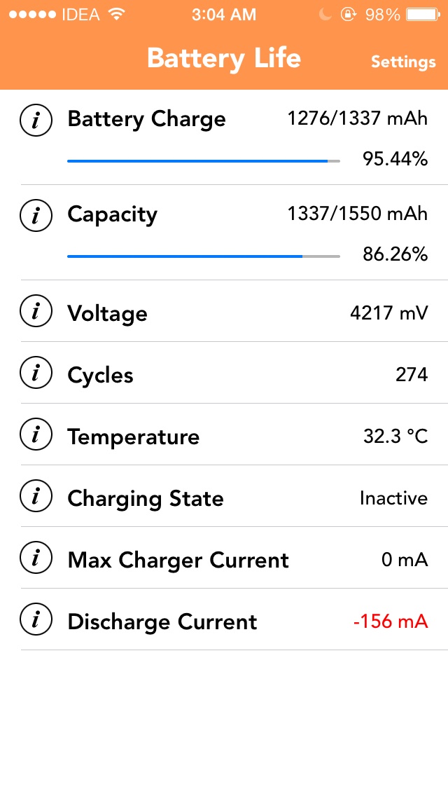

Here it is the application for ur Iphone! Really good application to check ur battery heatlh without plugging ur phone into the computer!! :)
