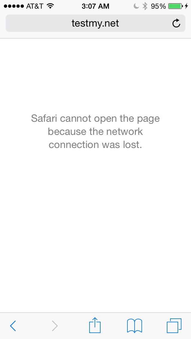

Was the error the same as the one I attached? I've seen that periodically since updating my 5s to iOS 8.
Also did you restore your 6 from backup or set it up as new? When I restored and set my 5s up as new (as instructed by senior care executive), most of the problems went away, but that's likely because there were no apps installed and no data whatsoever on the phone.
No. Mine said something about WebKit specifically but don't have the screen shot anymore.
And the 6 was setup as new. Was having issues almost right off the bat - I think only 5-10 apps.
