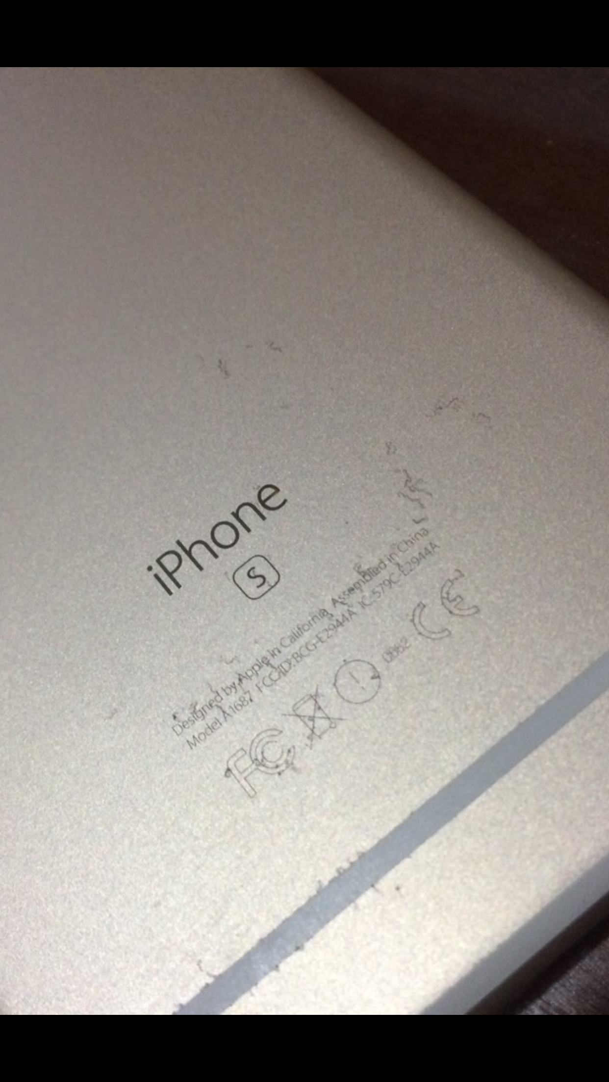

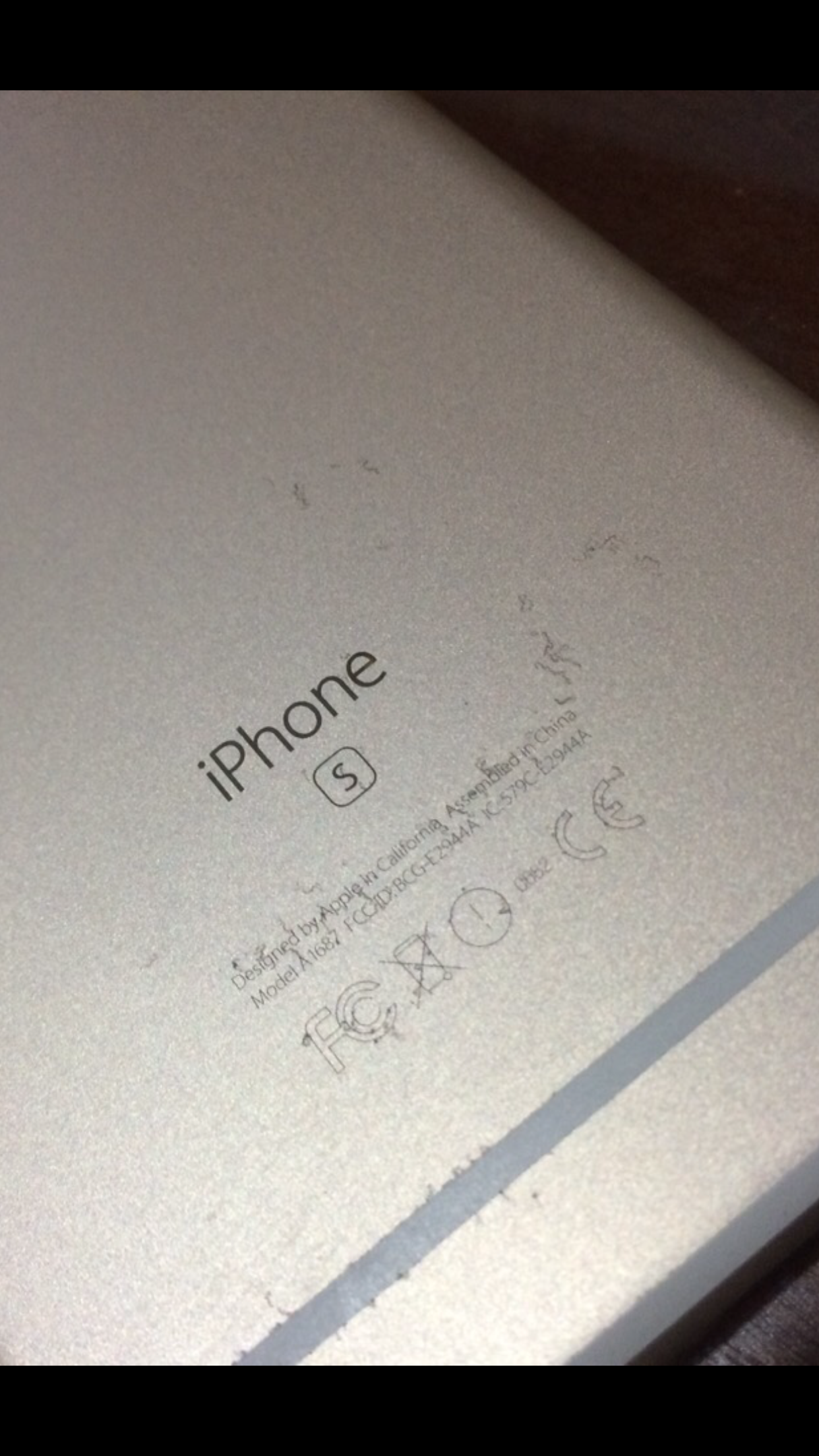

I was browsing through a local forum of apple users when I saw a comment about this issue. Decided to google "iphone 6s plus paint chipping off" and I stumbled upon this thread.
Unfortunately, I am also encountering the same issue with my 6s plus space gray phone. I was cleanig my phone when I saw there's a tiny chipped off part at the lower left corner of the lowest antenna. I also noticed it happening at the bottom. 🙁
I did not contact apple when I stumbled upon it, because who would believe that it was not Caused by misuse even if I know I handled my phone carefully.
I hope they find a solution or they allow an exchange... Because based on some photos the chipping off can eventually get worse 🙁
I bought this iPhone 6S Plus, November 2015. I have been using a back cover since day 01 so there no chance of me scratching the phone. The aluminum have been chipping off in various place including the areas near the sim tray, near the camera and the flash. I guess this is some kind of manufacturing defect. I'm still under the 1 year warranty period so would they do a replacement?

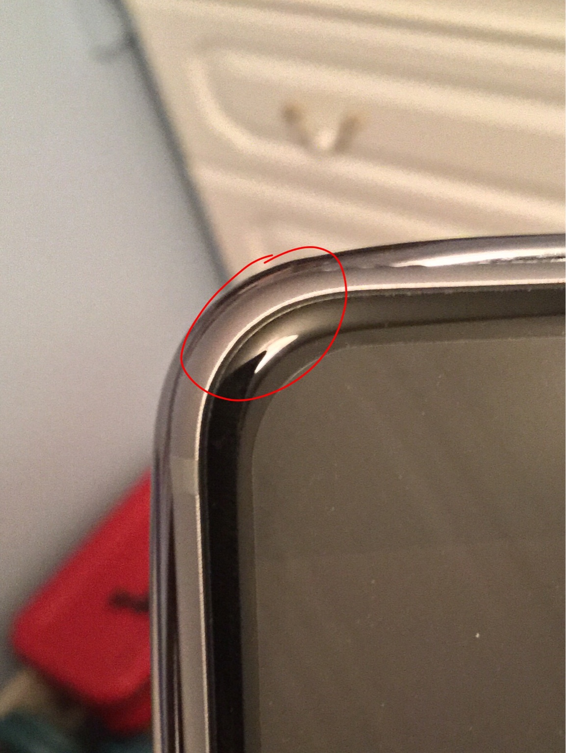

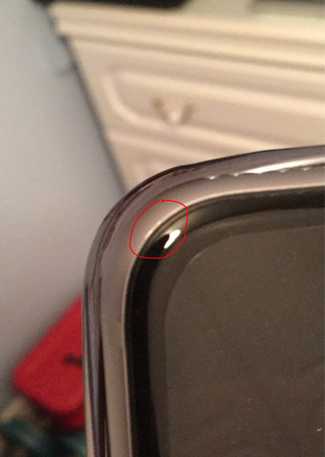

Hi. Does anyone think this counts as chipping? It's really difficult to see in some angles and I'm not quite sure.
One picture shows what I mean. The other picture shows how it's only visible at certain angles

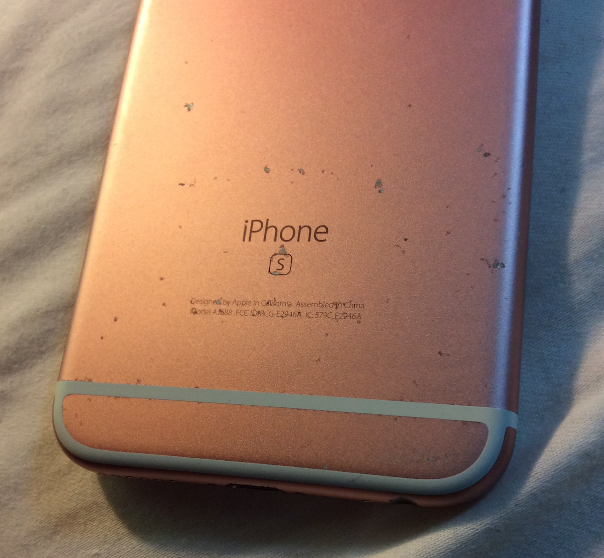

Thought I'd share a photo of my rose gold 6s here as well.
Never been dropped, and no case since day 1. All of my previous iPhones look great after years of use, but the 6s looks like it's been through hell in just 6 months.

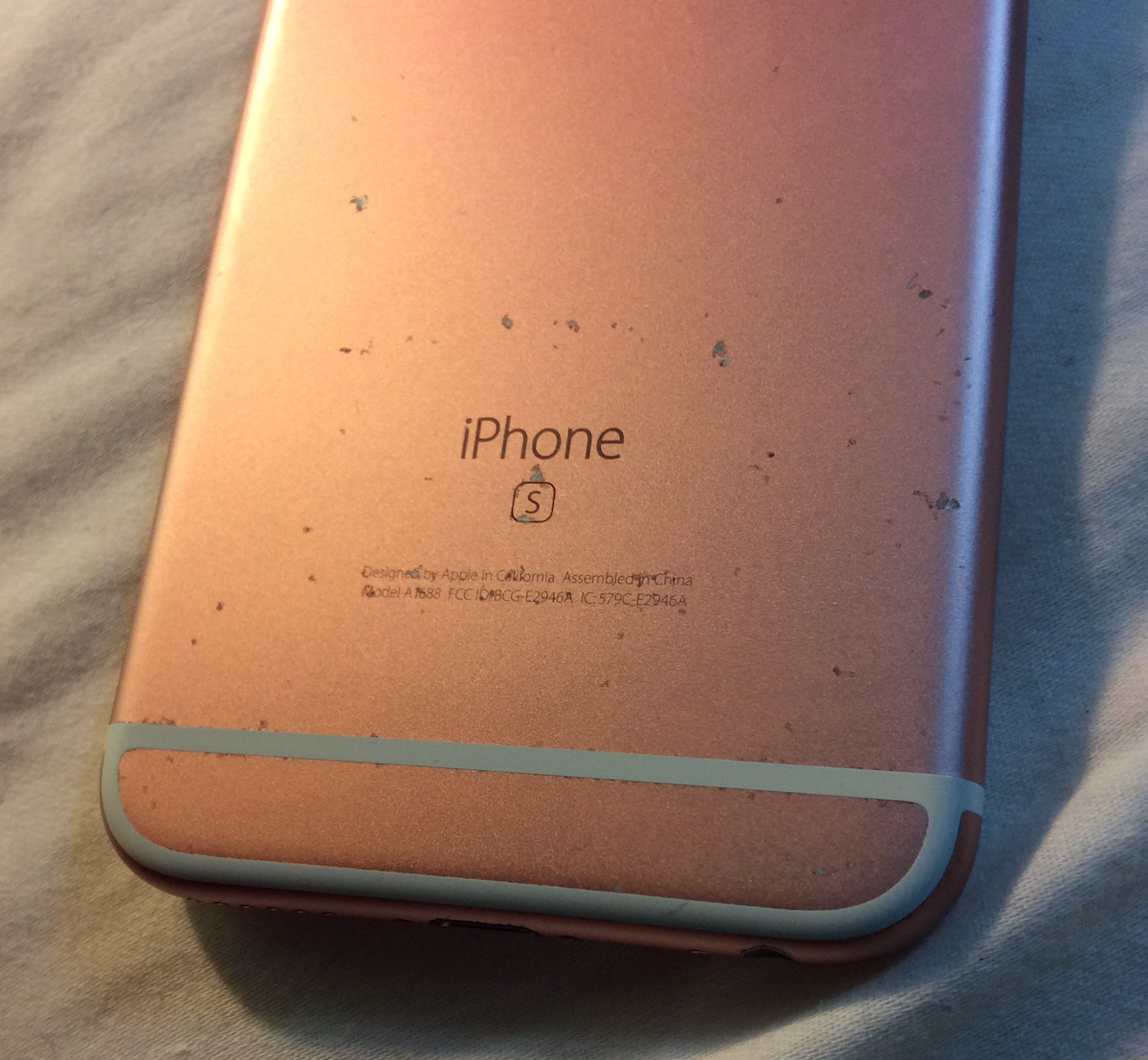

Id say take it back, thats not normal. Is it under warranty?
What model and what colour?
6S Plus Space Gray 64 Gb Unlocked sim free. Purchased around la ca.
It is very minor. A few marks around the lightening port. And especially surrounding the screws like so many others experience.
I just noticed it a week or two ago. It was fine for at least a few months.
I am absolutely positive I did not scratch it inadvertently. The chipping around the screw is dispositive as I could not have reached that area.
