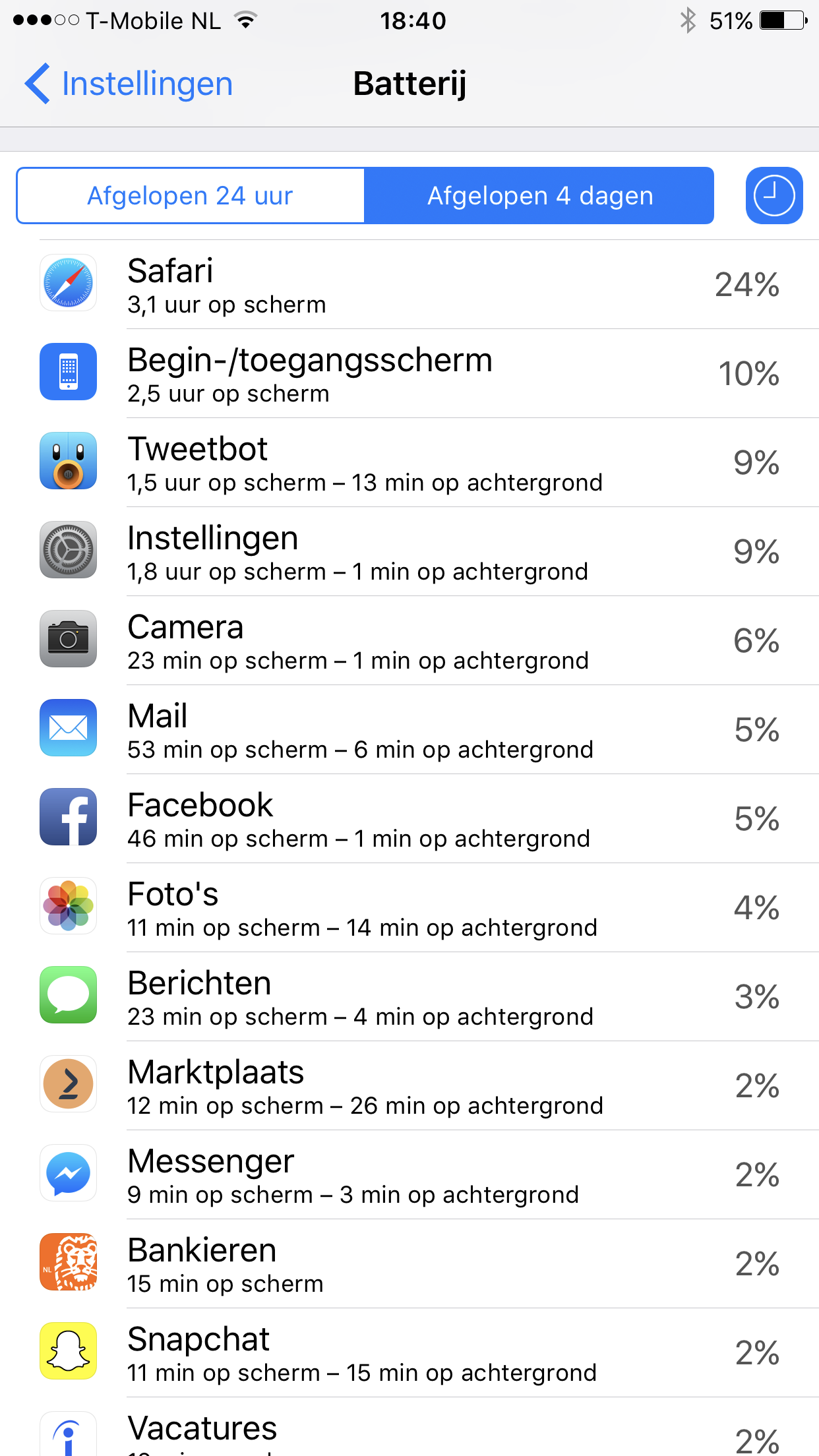

View attachment 661851 In 4 days I the lock screen used 2,5 hours of battery life. This doesn't look normal. Any suggestions what can be going wrong?
I looked down at my iPhone a few days ago, and noticed that the screen was on even though I'd locked it when I put it down. It was as dim as it could be, and barely visible, but it was on. I left it a minute to see if it went off by itself, but it didn't.
I also showed 17 mins of lock screen time which was unusual. Maybe a software issue keeping the screen on sometimes when it shouldn't.

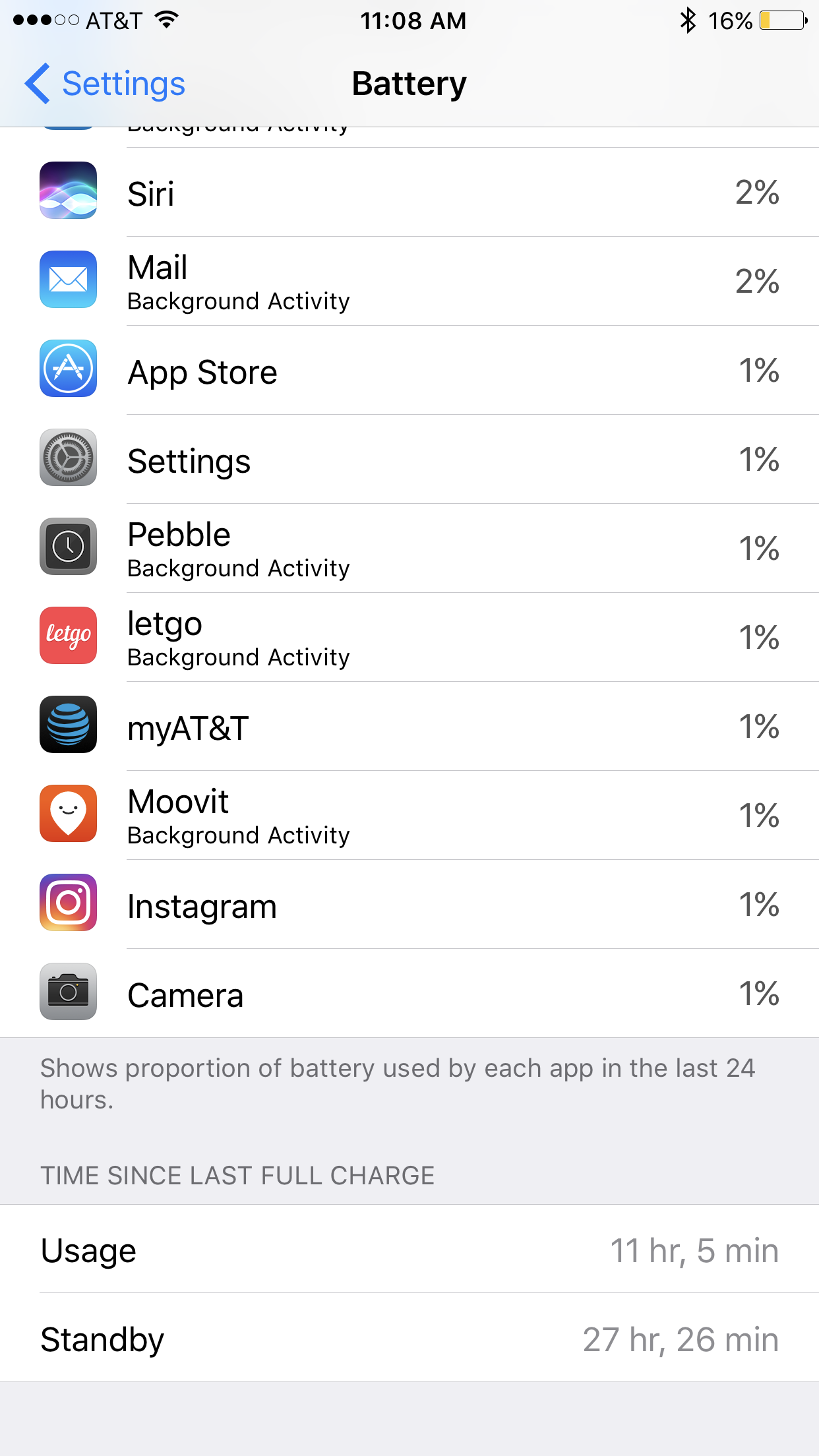

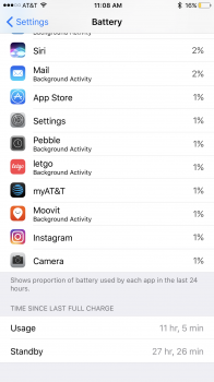

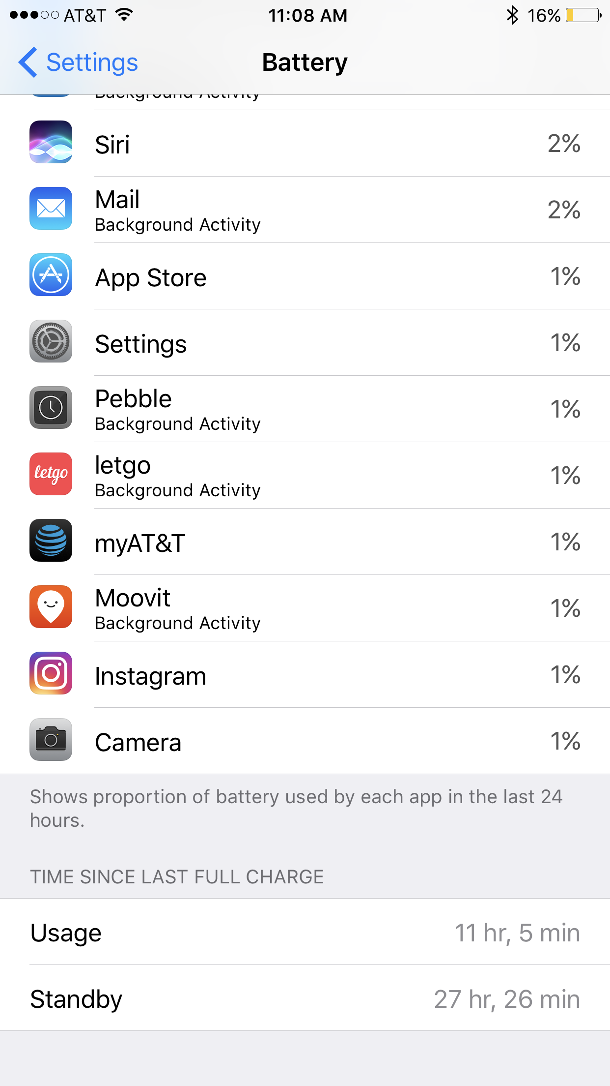

This is light to medium use. Getting better once you really calibrate the battery, meaning a couple of full charged
Please tell me what you consider to be not "very, very lightly used"?
Using the phone throughout the day for various tasks with battery implications, outside of opening up safari every once in a while to check a web site. The original poster's battery life is indicative of a phone that spent the majority of its time with the screen off throughout the standby period, and when it was turned on, it was for very very light tasks. Don't get me wrong, the life is great, but is not a great representation of what most members of this forum will get due to heavier usage.
I'll post mine at the end of the day if I remember.
