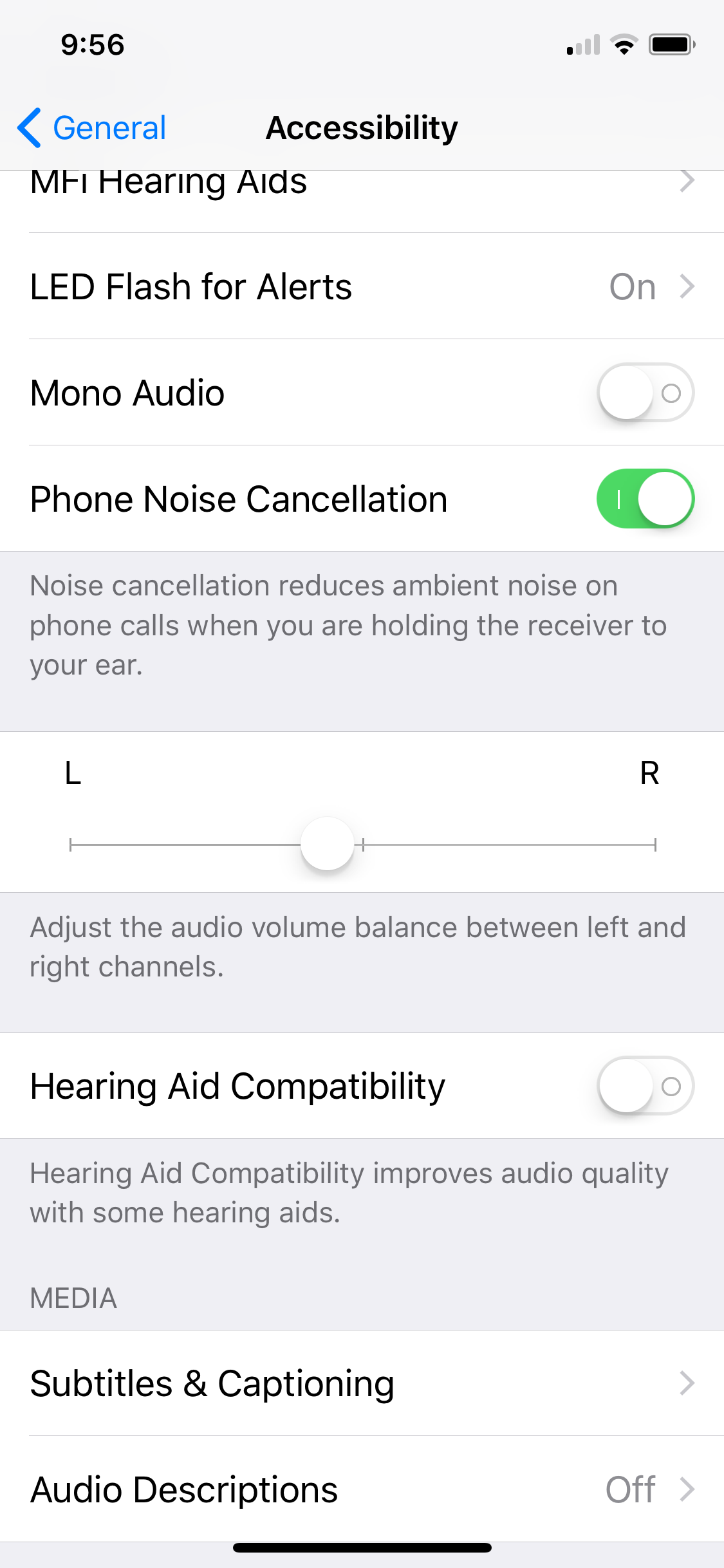

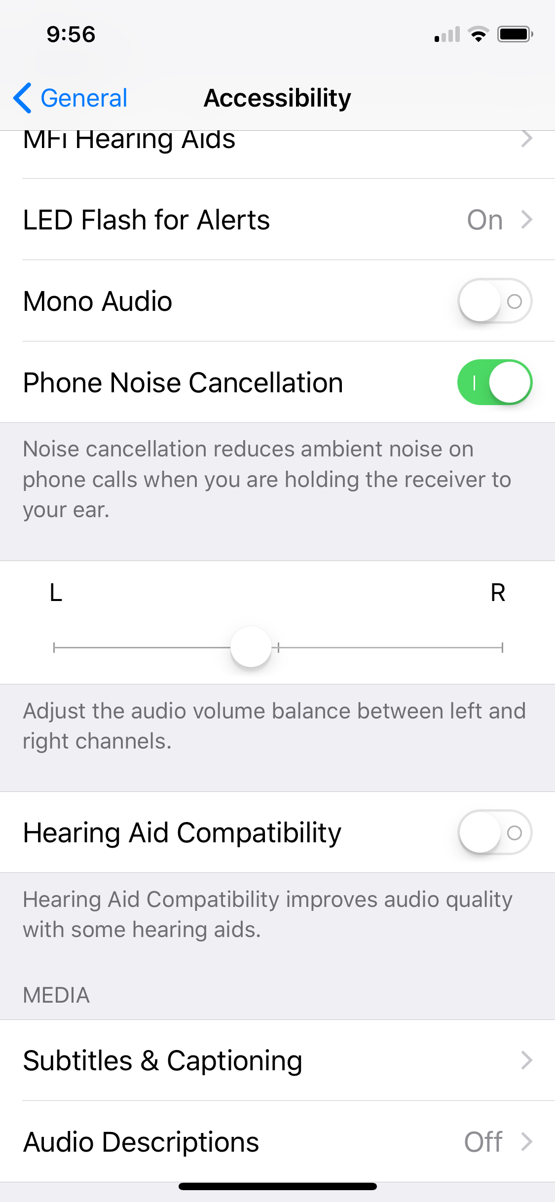

I've just created an account to post, mine has been having the same issue and I tried to get a replacement yet they refused as apparently all units have the same problem so I managed to practically fix it by adjusting the volume balance slightly to the left as shown in the screenshot, I hardly ever hear that crackling sound at the moment, hopefully apple acknowledge this issue soon and roll out an update.
Reactions: geekiemac
The only problem with that is that when you turn your phone to landscape mode it will swap speakers if you rotate the phone counter-clockwise . So then you will be essentially be channeling more sound through the worse speaker.
I don’t think this is something they can fix via software. It’s a physical issue. The only software fix would be change the maximum volume of the phone.
[doublepost=1511723707][/doublepost]
Yeah it's obviously still there, yet if you rotate the phone clockwise it's gone and on portrait mode as well, apple would probably reduce the max volume on the earpiece speaker as a fix to the problem
