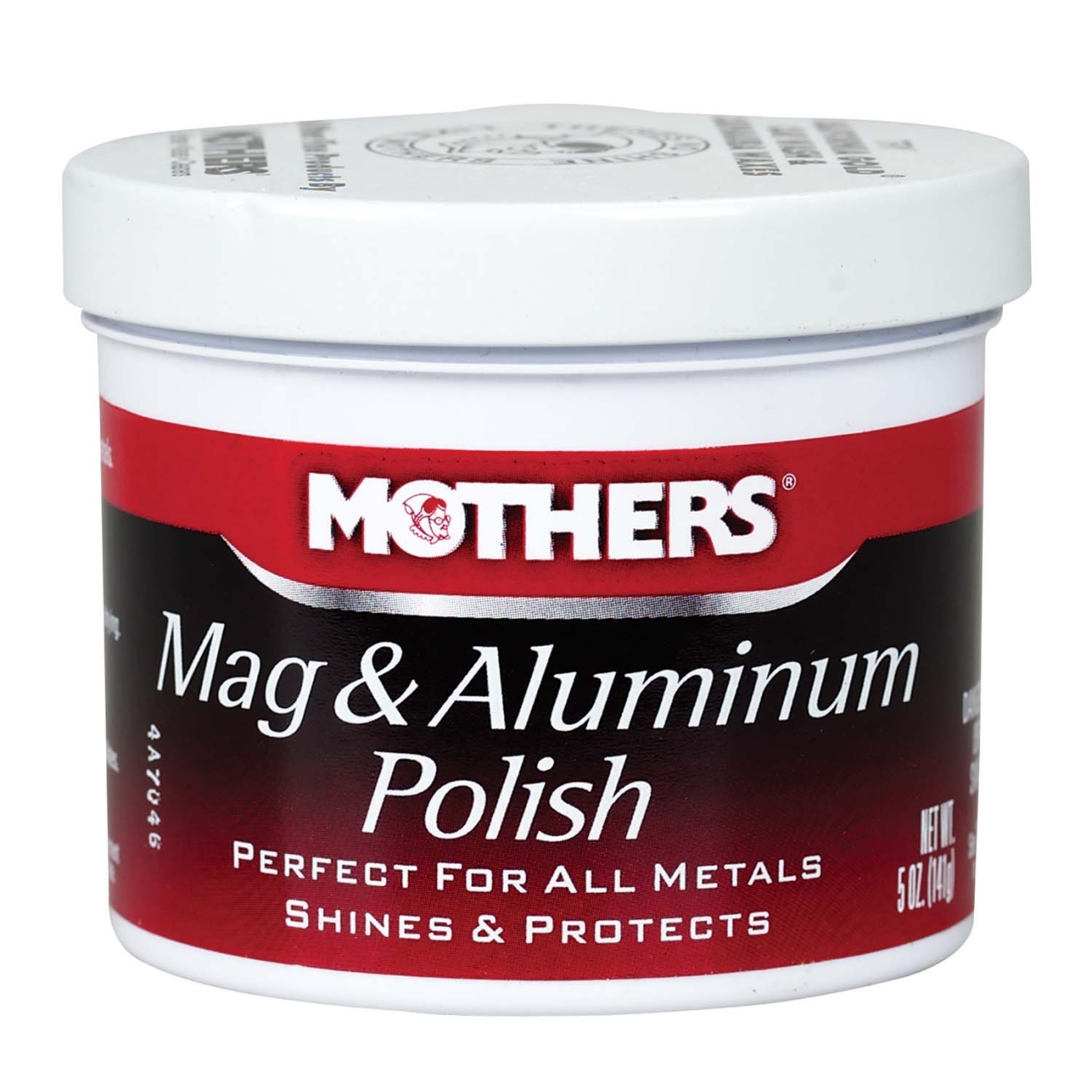

I fixed mine today!
I bought this Mothers Mag & Aluminum Polish at the store today to remove some scratches from a drop, as well as the scratches that have accumulated on my series 1 watch. Then decided to try to get rid of my “rough” edge too.
I put blue tape on the front and back glass, just to be safe, so only the stainless steel was exposed. Then I dabbed a tiny bit of polish onto a microfiber cloth, and used my fingernail to run the cloth back and forth along the edge of the steel (top edge right before the seal is where mine was rough). Now it is super smooth! Also worked perfectly for the scratches. I am very pleased.

I fixed mine today!
Do not!!! I repeat DO NOT do this with the black model.

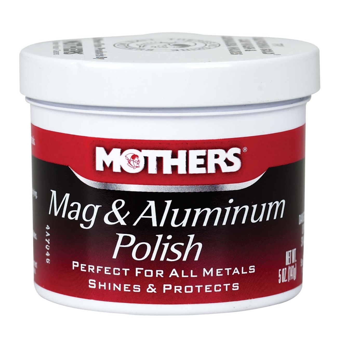

I fixed mine today!
Nice! And one of my favorite car detailing products (though modern cars have very little to polish any longer ... it does a good job on my exhaust tips)
Any before and after pics? (obv. assuming you have another camera 😀)
