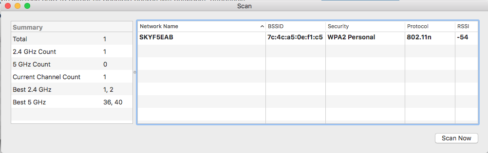

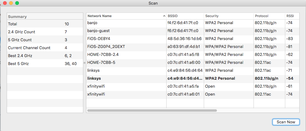

    Are you using a USB3 device near the computer?
    Does this issue only happen on power? (not on battery)
    Have you tried using a different power cord?
    If you run the Wifi Diagnostic Scan, what signal strength and ideal channels are you getting?
    Which channels are you currently using?
    Are you running 2.4, 5, or both?
  3. dedzyyy thread starter macrumors newbie
    dedzyyy
    Joined:
    Feb 5, 2017
    #3
    I think all 3 USB ports on a late 2011 are USB 2 - I am using a Cubase dongle and occasionally an external hard drive.
    It happens with the power disconnected, but not really as much.
    I've not tried a different power cord yet, but I'll try and borrow the mrs' cord sometime soon.
  4. ZapNZs macrumors 68020
    ZapNZs
    Joined:
    Jan 23, 2017
    #4
    My Early 2011 is all USB 2 (I wasn't sure if Late added 3 or not), but if I am using another USB 3 device close by, like my SP3, and actively using USB 3, I've noticed that some of the USB3 accessories will interfere with my 2.4 GHz signal, but I've only really noticed this in areas with more Wifi clutter.
    It might be worth trying a different power cord. I've read on forums that some people have had rogue issues with the power adapter itself interfering with the signal.
    I highly doubt this is it, but given it would take only 10 seconds to try if you have not already, are you using the 3-prong cord that adds the dedicated grounding? Sometimes I can feel a strange sensation on my palms when using only the 2-prong and I've wondered in the past if that could interfere with other operations?
  5. dedzyyy thread starter macrumors newbie
    dedzyyy
    Joined:
    Feb 5, 2017
    #5
    I've sometimes felt a minuscule electric pulse come from he Mac body from time to time.
    As you can see from my screen shot, there's not really much wifi clutter. Both my neighbours are super old and have no internet.
    I've also got a firewire audio interface near the power port. Could that make any difference??
