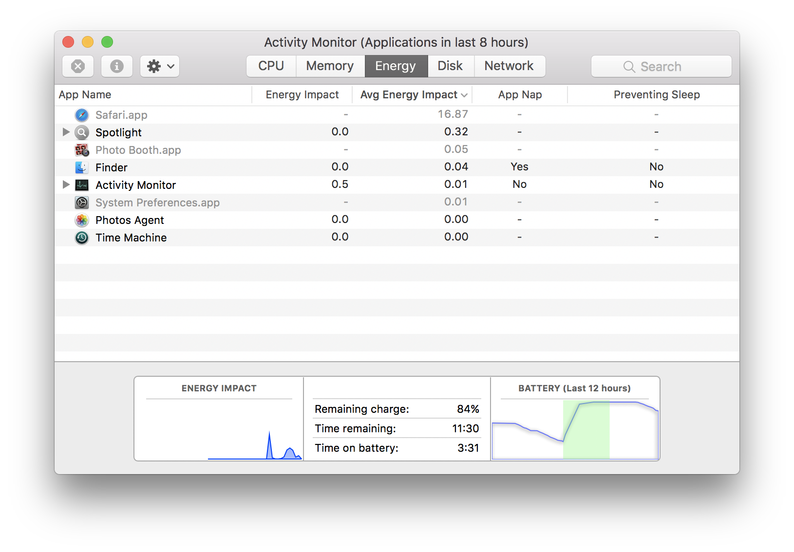

After a week of using this MacBook Pro, I have a better estimate of battery life. Casual users can expect 12 hours on a full charge.

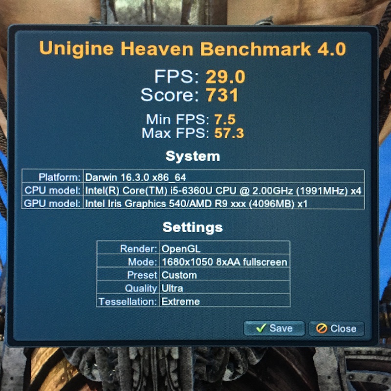

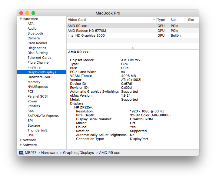

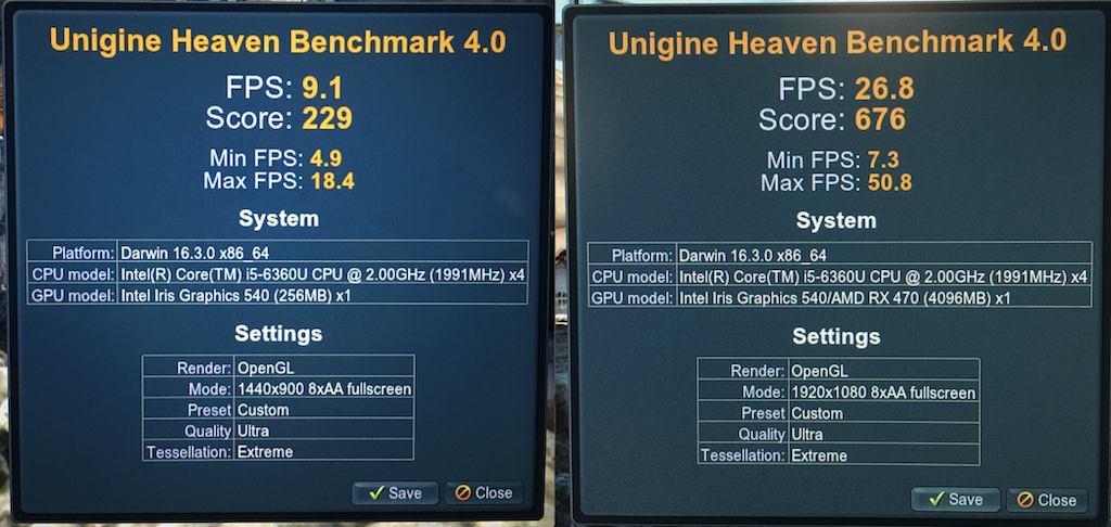

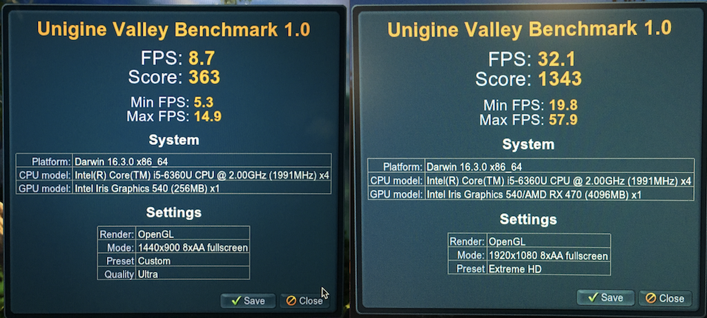

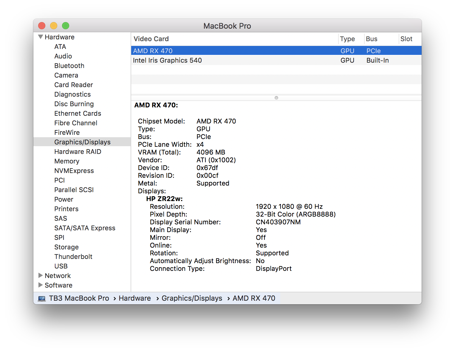

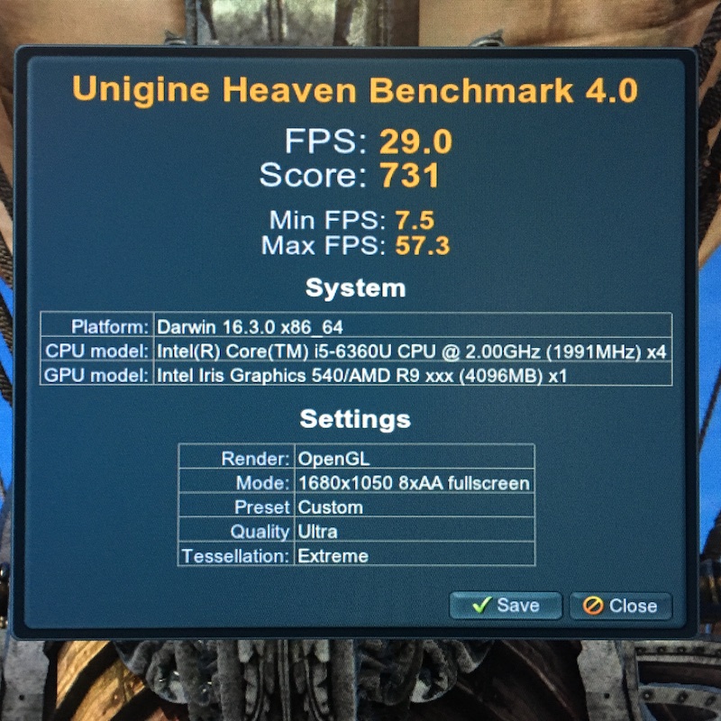

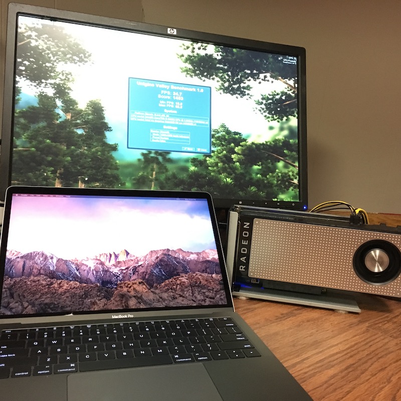

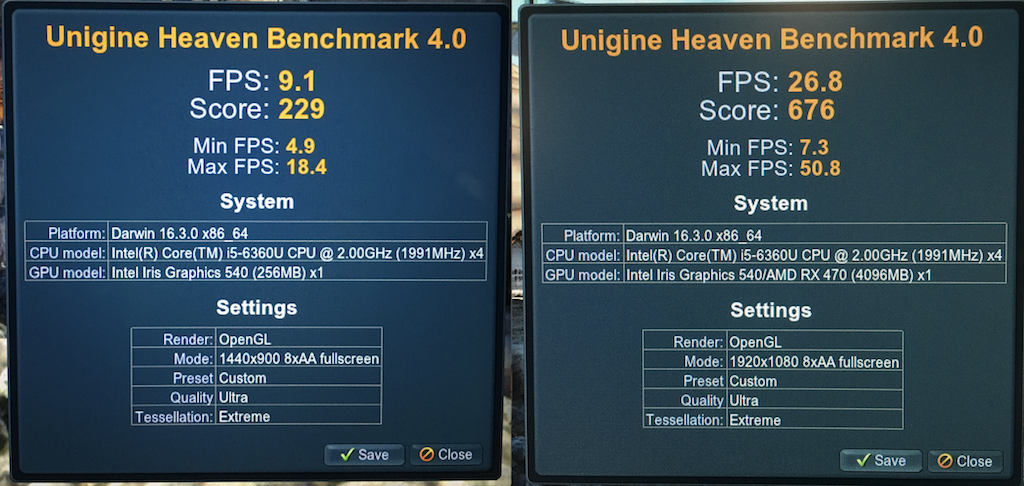

Apple may be listening after all. I upgraded my Late 2016 MacBook Pro to 10.12.2 Beta 2 tonight and eGPU is working better. It now has Metal Support and Acceleration.
The MBP's internal screen scales to 1440 x 900 when I ran Unigine fullscreen so these are not exactly the same resolutions. You can tell the eGPU boosts performance significantly. Also, OpenCL is not working right when the eGPU is attached. Therefore I had to take screen caps with my phone.

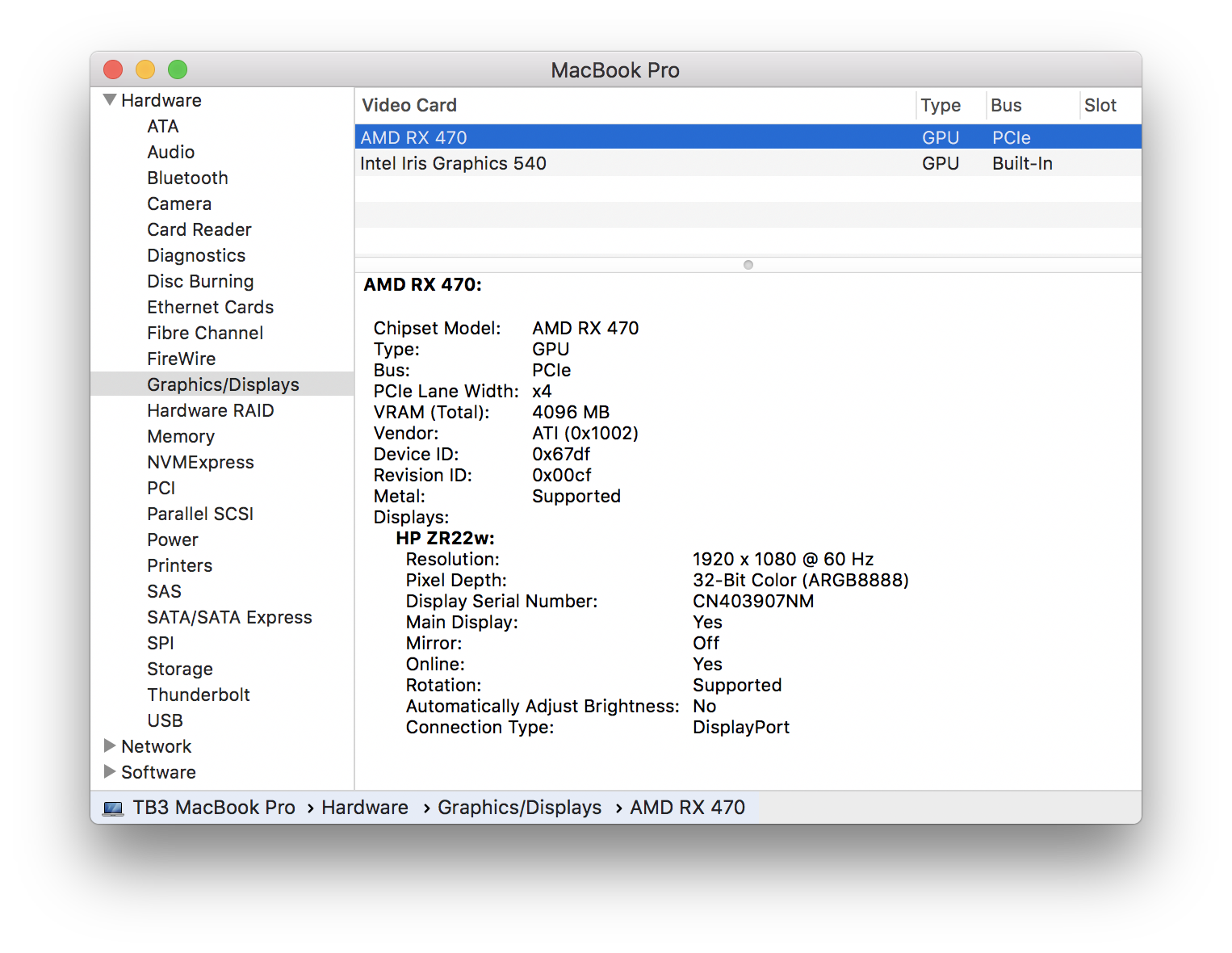

That would be absolutely amazing if true..... Also false advertising on Apple's part. Maybe this could just be an oversight in the hardware browser and the TB3 ports do indeed run at 40gb/s but its just reporting 20? Maybe? I would want to believe that over apple crippling the base model further but who knows anymore....
https://thunderbolttechnology.net/sites/default/files/Thunderbolt3_TechBrief_FINAL.pdf
I hope this clears things up a bit, with thunderbolt 3 you are getting 4 20-Gbps physical links, which means a throughput of 80-Gbps in total. Of course it is bi-directional, so you get 40 in and 40 out, at max. So imagine this is a highway, you are getting more lanes instead of higher speed limit when going from thunderbolt 2 to thunderbolt 3.

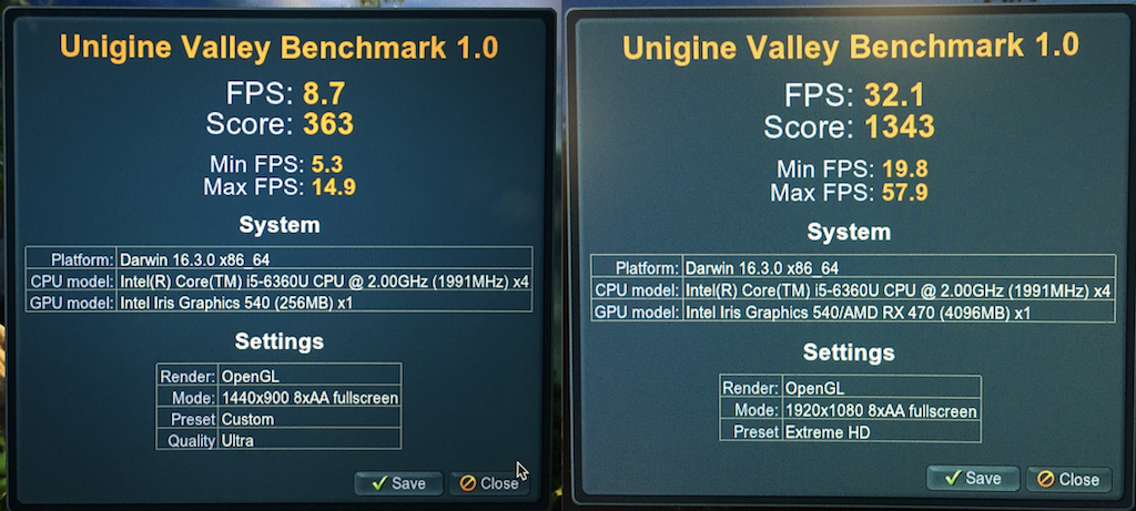

There definitely could be uncertainty because of that. What we definitely need is to see how OS X reports the TB3 bandwidth on both 13" and 15" toucher models. I'm almost 100% sure that at least 15" has true full-speed TB3 ports and if they still show as 20Gb/s x1 link, then it's probably a notation issue

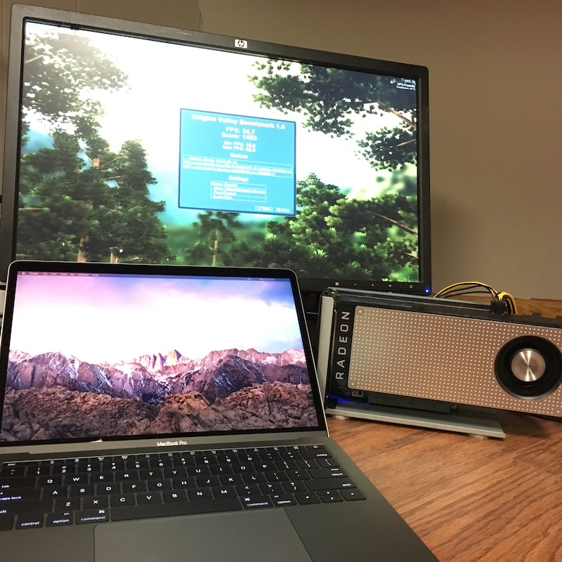

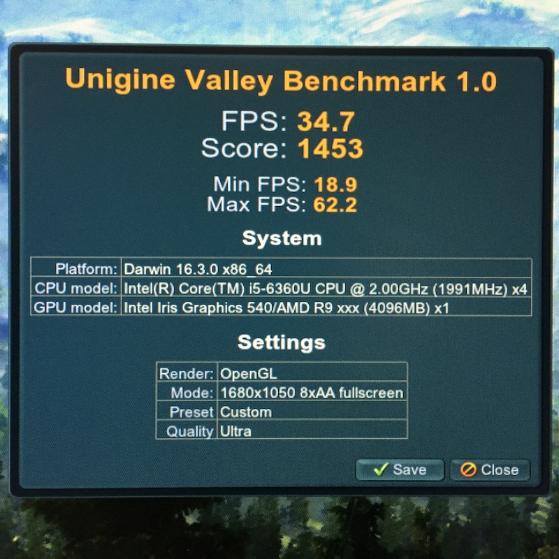

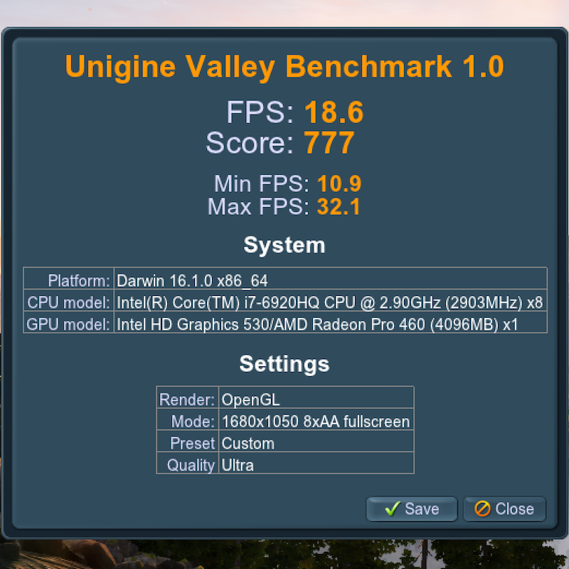

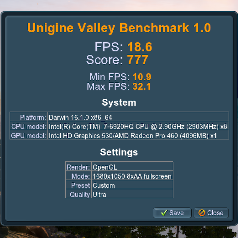

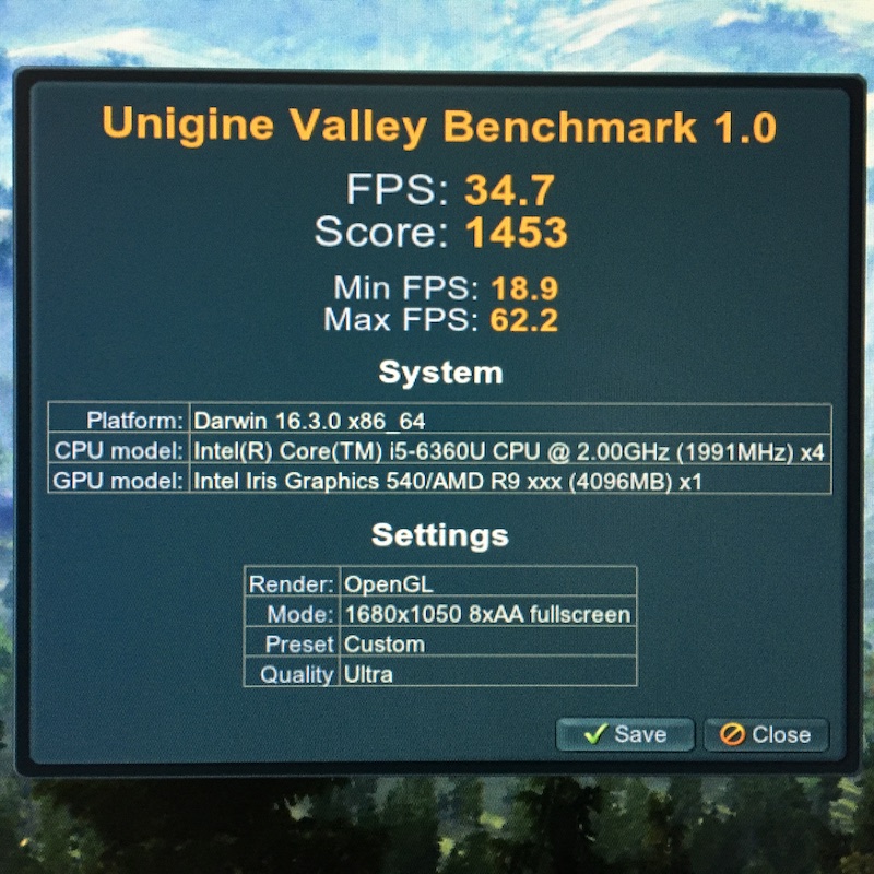

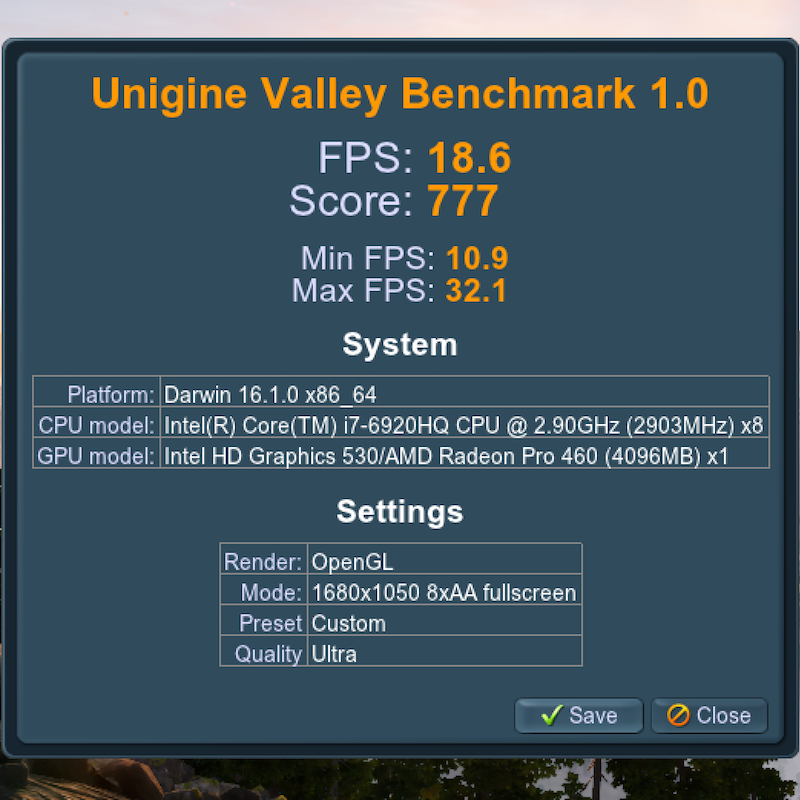

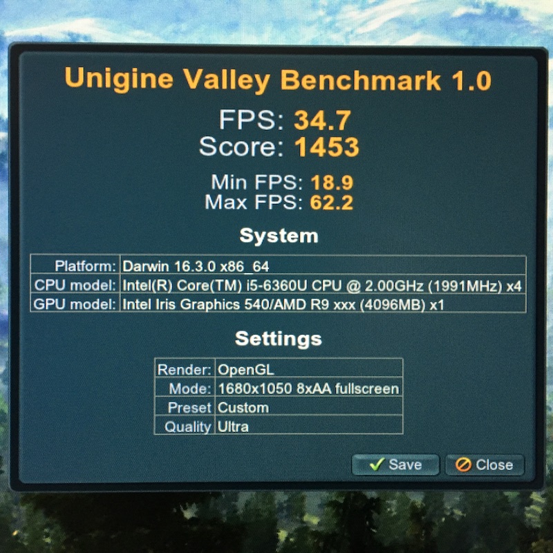

A huge thanks to @fs454 who was updating us all day with benchmarks of Radeon Pro 460 in his 15" MBP. The 15" retina screen scales things to 1680x1050 so I ran Unigine at this resolution to compare.
View attachment 672317 View attachment 672318
View attachment 672319 View attachment 672320
