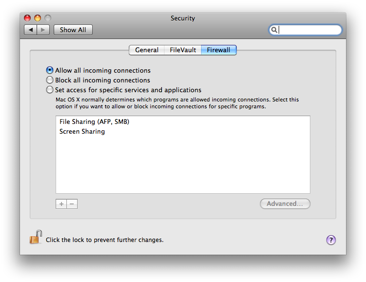

Everyone try this...
Turn off the OS X firewall.
System Prefs > Security > Firewall - Allow all incoming connections.
Sleep your Mac and rewake it (this seems to force it to rescan for shared resources). Worked for me.
Will look in to it further tomorrow, for now it's bed time...
edit: So long as File Sharing (AFP, SMB) is in the bottom option, this seems to work as well, and would be the preferred one to select since it keeps your firewall enabled.
How did you even get File Sharing (AFP, SMB) into that? I clicked the + an typed File Sharing in and I am not sure what to select. I don't even see it.
Open the sharing preferences in system preferences then select file sharing.
