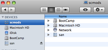

Well... The 10.5.1 upgrade did not fix the nfs volumes not being shown on sidebar, but... workaround is to drag the icon of the nfs volume to sidebar and it will appear there every time you mount the drive.
This doesnt work for me. Any more info?
Ignore that - works now 😀
