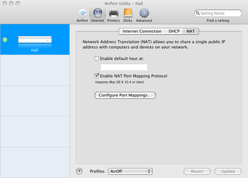

I think I may have narrowed this bug down to being a wifi problem. For me, Leopard is absolutely unable to find my shares (unless I manually mount them using smb) when I'm connected to my network with Airport. Curiously, connecting to the network via ethernet makes the shares pop up instantly.
If your using an AEBS make sure it has NAT port mapping protocol selected.
Soon as I did this poof!.All my shares appeared.

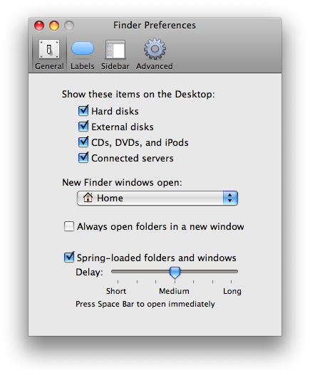

Short answer: Try relaunching finder. Go to finder preferences and show mounted drives on desktop. Long winded details follow...

I connected to a share with cmd-k like I always did before, but I could not see the mounted share anywhere. So I had to set finder to show network shares on the desktop (see picture). Did that and they now show on the desktop although they still don't in the sidebar. The really odd thing is in the open/save dialog it works as intended.
Also, if you don't want to do that cmd-up arrow thing to see mounted shares then while in finder preferences go to sidebar and have it show 'computer' in the sidebar, it's the same thing.
*update:
The shares showing up in open/save dialogs was confusing me, so I relaunched finder (cmd-option-esc, choose finder, hit relaunch) and now the shares show up included the mounted computer. I still personally don't like how it shows things so I still just click on the shared folder that shows up on the desktop
