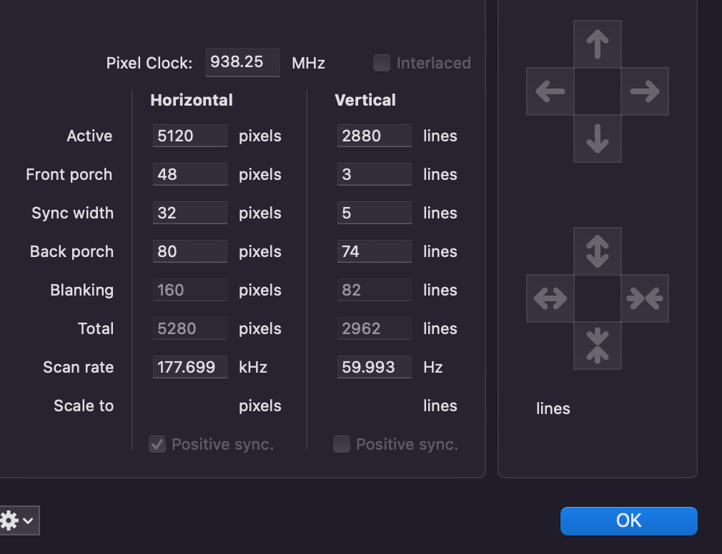

It says you are using a 5120x2880 framebuffer and outputting 3840x2160 60Hz. That's probably the best you're going to get using an HDMI to DisplayPort adapter.
But it doesn't look like you're using an HDMI adapter in this AGDCDiagnose output because I see DisplayPort DPCD registers. But the EDID seems to be greatly modified so you might be using an HDMI adapter? I am confused. How exactly is the display connected in this AGDCDiagnose output? What Computer, GPU, adapters, cables? It may be that the HDMI port is controlled by a DisplayPort to HDMI adapter. That would explain the presence of DPCD.

The AllRez output show the following:
Code:
allrez      - 2560x1440@59.999Hz                       HiDPI (5120x2880) scaled to 3840x2160.
allrez_4096 - 4096x2304@59.116Hz 138.628kHz 590.000MHz low-resolution (not HiDPI)
The DetailedTimingInformation doesn't include encodings, bpc, colorimetry, or dynamicrange, probably because it's an older AMD GPU - this is just like the lack of the same info in the AGDCDiagnose. In both cases you are using 10bpc framebuffer but we don't know what the output pixel format/depth is.
kConnectionColorDepthsSupported says RGB 6bpc is supported, but that's unlikely, or it's true for the display, but not for the graphics driver. I'm not sure why it doesn't mention any other RGB bpc values. Does the display look like it's being limited to 262144 colors (view a gradient and verify there are 256 different shades instead of just 64 - I suppose you need to make sure to not use an app that uses dithering or it may be that macOS does dithering automatically)? As far as I know, macOS doesn't support 6bpc.
In the allrez_4096 case, there is also a 4096x2304@59.999Hz 142.198kHz 593.820MHz timing. Does that one work as well or does the 593.820MHz pixel clock exceed what is accepted by the LG UltraFine 5K? I believe the limit is somewhere under 600MHz so 593.820MHz might be getting too close.
In both cases, all the scaled modes appear to be based on 3840x2160. If you like 4096x2304 in the allrez_4096 case, then you should change the "Scaled resolutions base" in the Display Information tab for the display in SwitchResX.
Are you having any issues with this new 4096x2304 mode? Is it acceptable? Have your eyes stopped hurting?

Set the "Scaled resolutions base" as I suggested to 4096x2304. Then use HiDPI modes that will draw larger text, such as 3008x1692 or 2560x1440. The HiDPI modes will scale down to the scaled resolution base which is 4096x2304.
You didn't answer my question about the other 4096x2304 timing - if it works or not or why it exists.
Additionally, I attached the results of allrez on other MBP(2018). The laptop is currently being set to 3008x1692 HiDPI. Could you also analyze this file?
The EDID changed slightly. It seems each source of the KVM has a different "Source physical address". It may be that the source of the KVM is switchable using software, possibly using DDC/CI (MCCS) but the AllRez utility doesn't know how to do DDC/CI properly in this setup. This is a common issue with DisplayPort to HDMI adapters. Have you tried any DDC/CI software that works?
The GPU in the MBP 2018 is Intel. kConnectionColorDepthsSupported doesn't exist at all here. Another reason why it might not be useful info.
The DetailedTimingInformation does have pixel format information: encodings(RGB,) bpc(8,) colorimetry(NativeRGB,) dynamicrange(SDR,)
which is as expected. HDMI doesn't have enough bandwidth to do RGB 10bpc at 4K.
You didn't add a 4096x2304 custom timing on the MBP 2018. Each source of the KVM needs the custom timing if you want to use that timing with that source.
IOFBTimingRange is interesting. For AMD, you can create timings up to 16K x 16K. With this Intel GPU, the limit is 8K x 3K. For your old AMD, it doesn't say anything about what encodings, bpc, colorimetry, or dynamicrange values are supported (consistent with other info in the AllRez output mentioned previously). For the Intel GPU, that info does exist: encodings(RGB,444,422,420,) bpc(8,10,) colorimetry(NativeRGB,sRGB,DCIP3,BT709,BT2020,) dynamicrange(SDR,HDR10,DolbyTunnelMode,TraditionalGammaHDR,TraditionalGammaSDR,). I think Intel is limited to DisplayPort 1.2 which shouldn't be able to do HDR or 4:2:0 but I guess it's just a simple software switch to enable them. In other words, they don't require hardware features to use.
The mode for the Intel is 3008x1692@59.999Hz 133.317kHz 533.270MHz (HiDPI) scaled to 3384x2160. You'll probably want to create a 4096x2304 custom timing and set that as the scaled resolution base so that the 3008x1692 HiDPI mode (and all the other scaled modes) is scaled to 4096x2304 instead.
