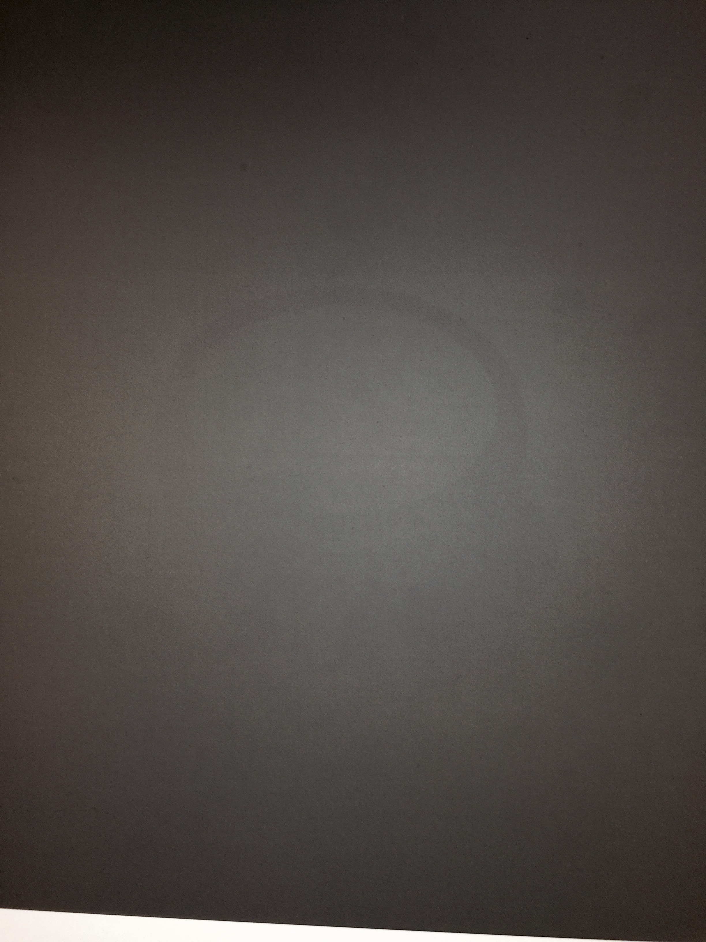

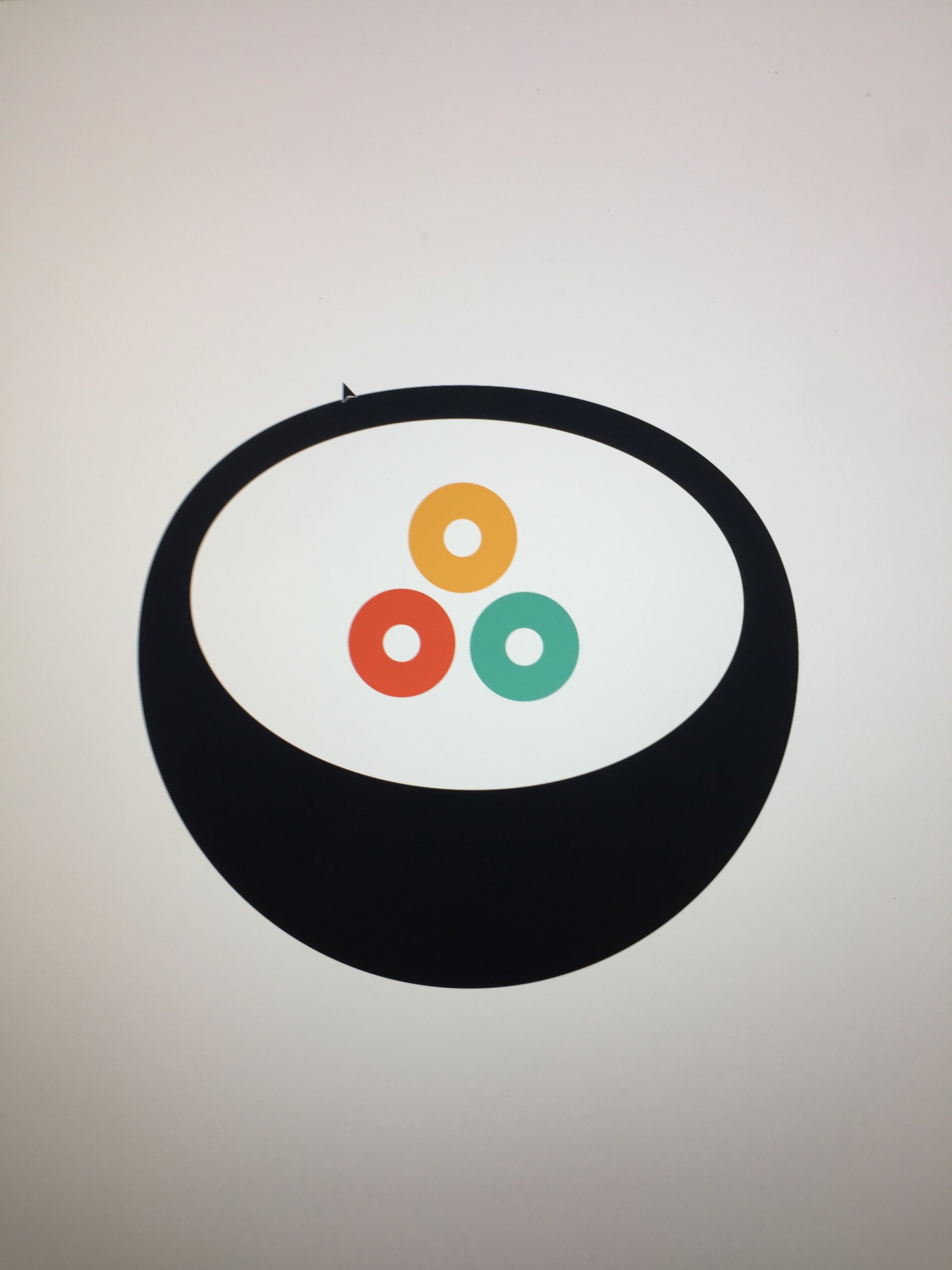

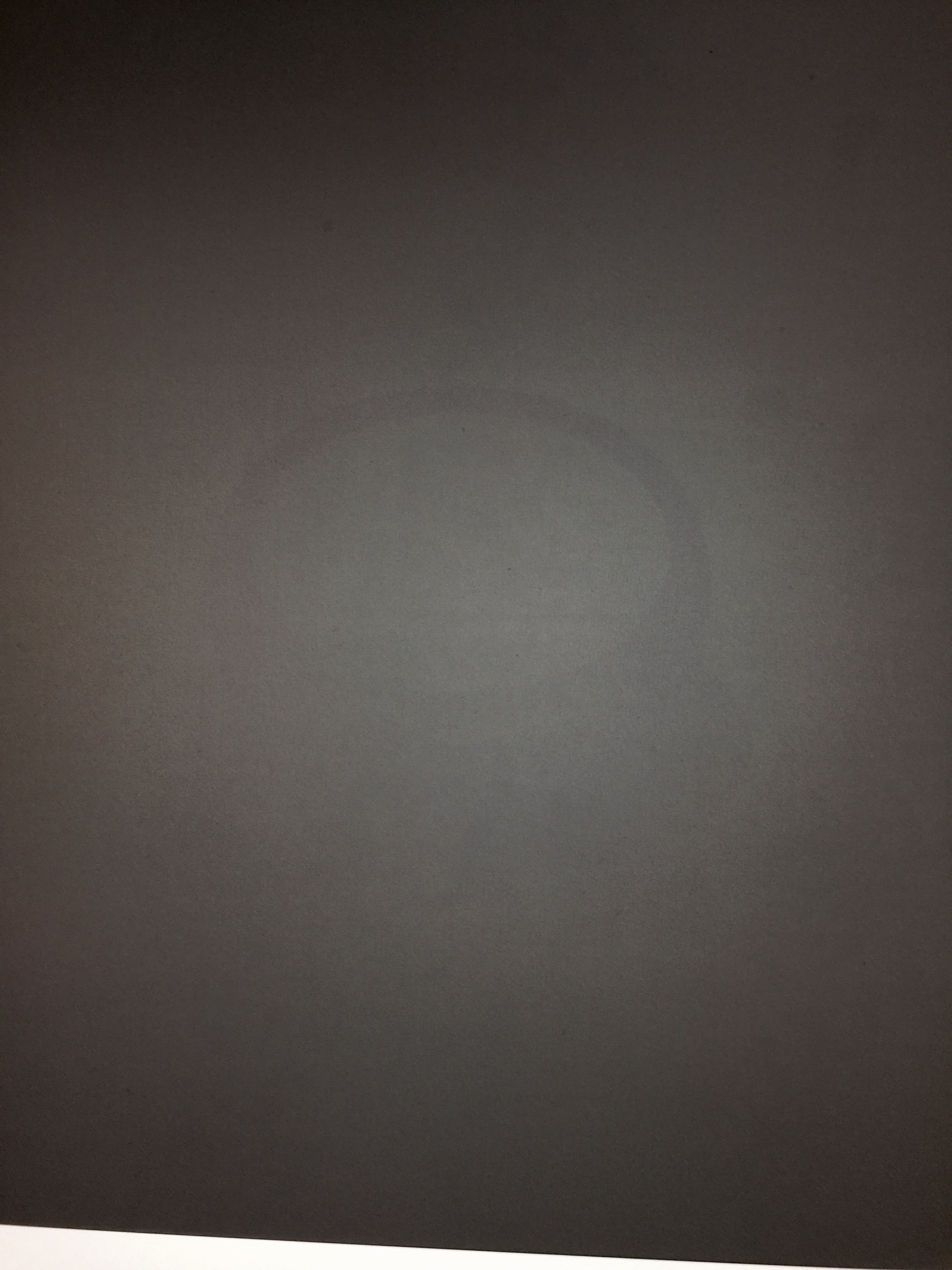

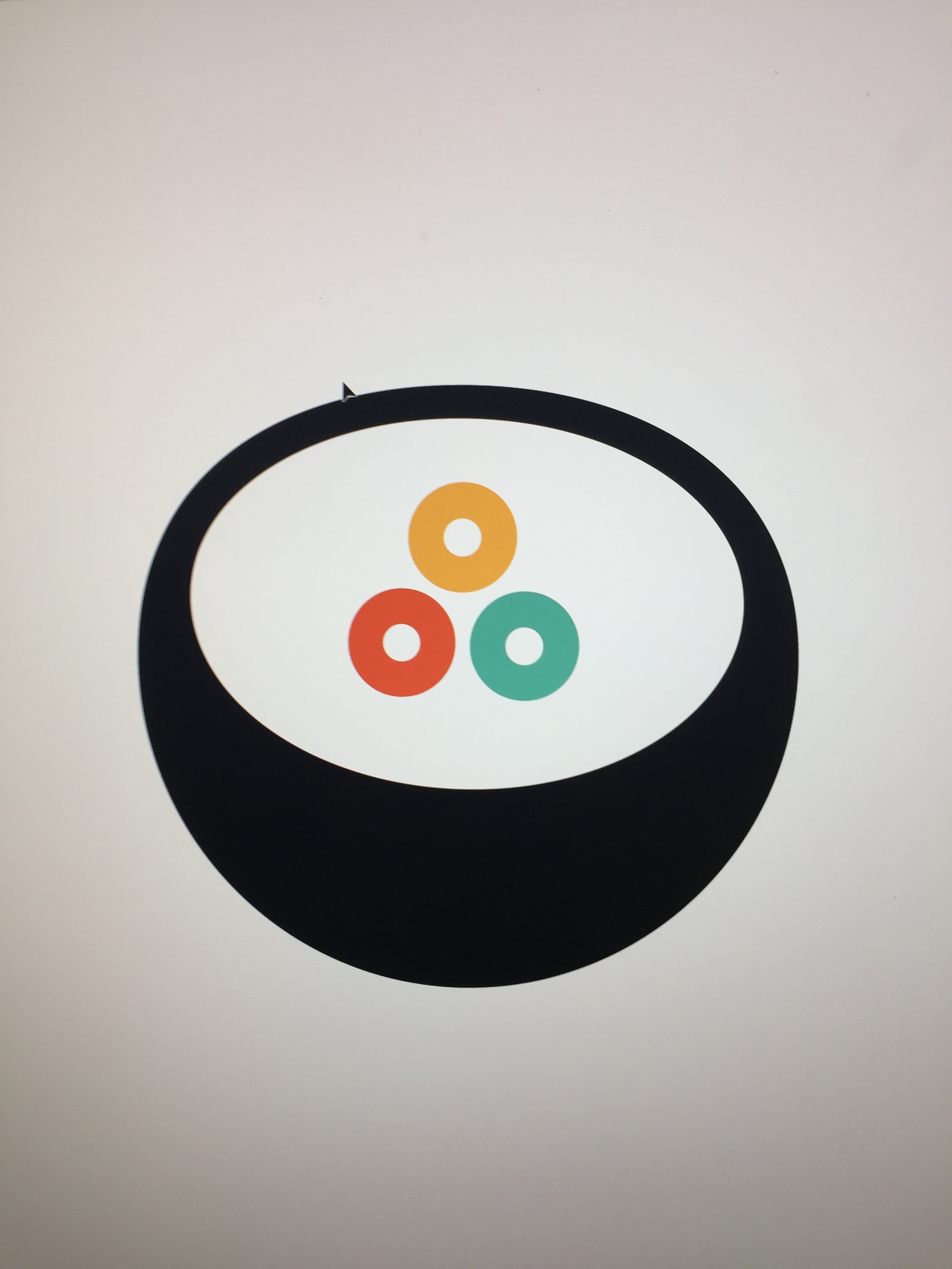

I have a very strange phenomenon, I have a macbook pro 2016 connected to the 5k lg, and especially after using adobe photoshop and illustrator I have this weird image persistence that fades away over the Course of a few minutes, sometimes it even takes a restart to get rid of those ghost images.... :-/. the first one is the persistent image of the design... does anyone have same issues ??
cheers from Cologne
torsten s.
I thin some one on here already predicted this would happen with this very panel. That is ghosting / image retention.
So if it is not IR it is shielding if it is not shielding it is bad software. wow
