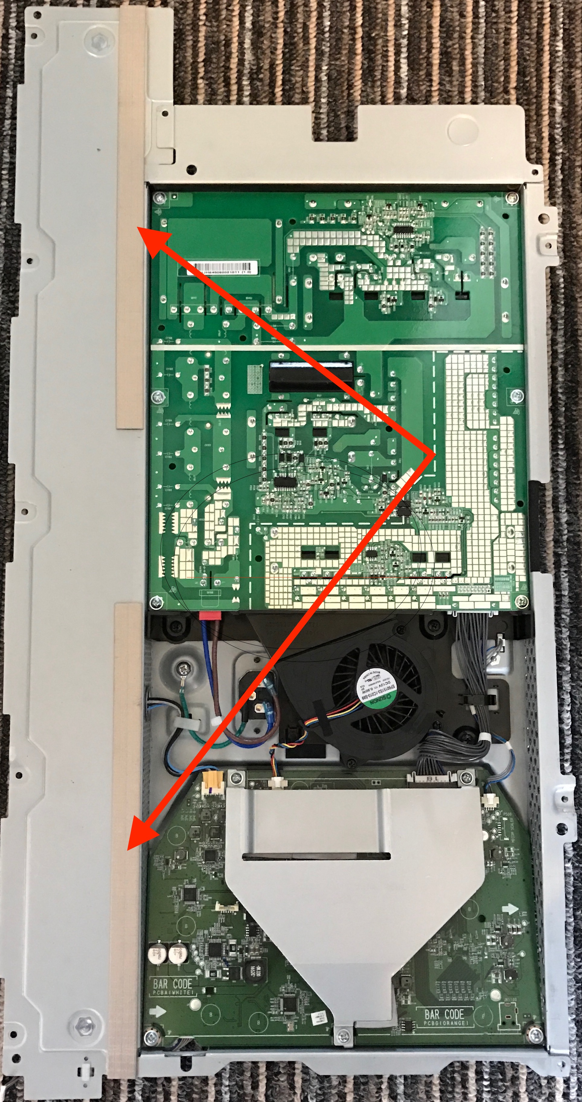

Got mine back from LG. The fix was 2 gaskets (part # MDS6492205) ... does that mean the display shielding fix? Curious what the service report said for the rest of you.
So far things are working normally but I'll report back otherwise.
Thanks for the update - I'd love to know what these gaskets look like but I'll stop short of asking you to disassemble your display 🙂
I wonder if this is them...

Hm, interesting. could be... if it is, I'm curious as to how that would fix anything (doesn't look to be electrical related.. just padding on the mounting hardware? maybe cooling related)
Regardless, things seem to be working for me so far, I've been using it for work the past two hours and no issues.
I might try to take a look around when i get some time soon, as I think the hardware is easily accessible behind the VESA mount
Hm, interesting. could be... if it is, I'm curious as to how that would fix anything (doesn't look to be electrical related.. just padding on the mounting hardware?)
I can understand why you would say that but actually EMI gaskets are made of highly conductive wire mesh amongst other things and have a thin foam sandwich to ensure that the conductive mesh follows the very fine contours of the two metal plates being brought together. It's tempting to conclude that two metal plates bolted together in 5 places might not require anything else to seal the gap but at the wavelengths of 5GHz WiFi signals, even tiny gaps in the metal are relevant.
If I were you I wouldn't try to disassemble your display and you'll find that removing the VESA mount doesn't achieve much other than expose some more screws. Even if you remove those screws you will have a hard time separating the plastic bezel from the rear casing as it is held together in numerous places by plastic clips which require the combination of guitar picks, old credit cards and a lot of patience to remove!

Ah, I see now -- thanks for that explanation, makes a lot more sense!
