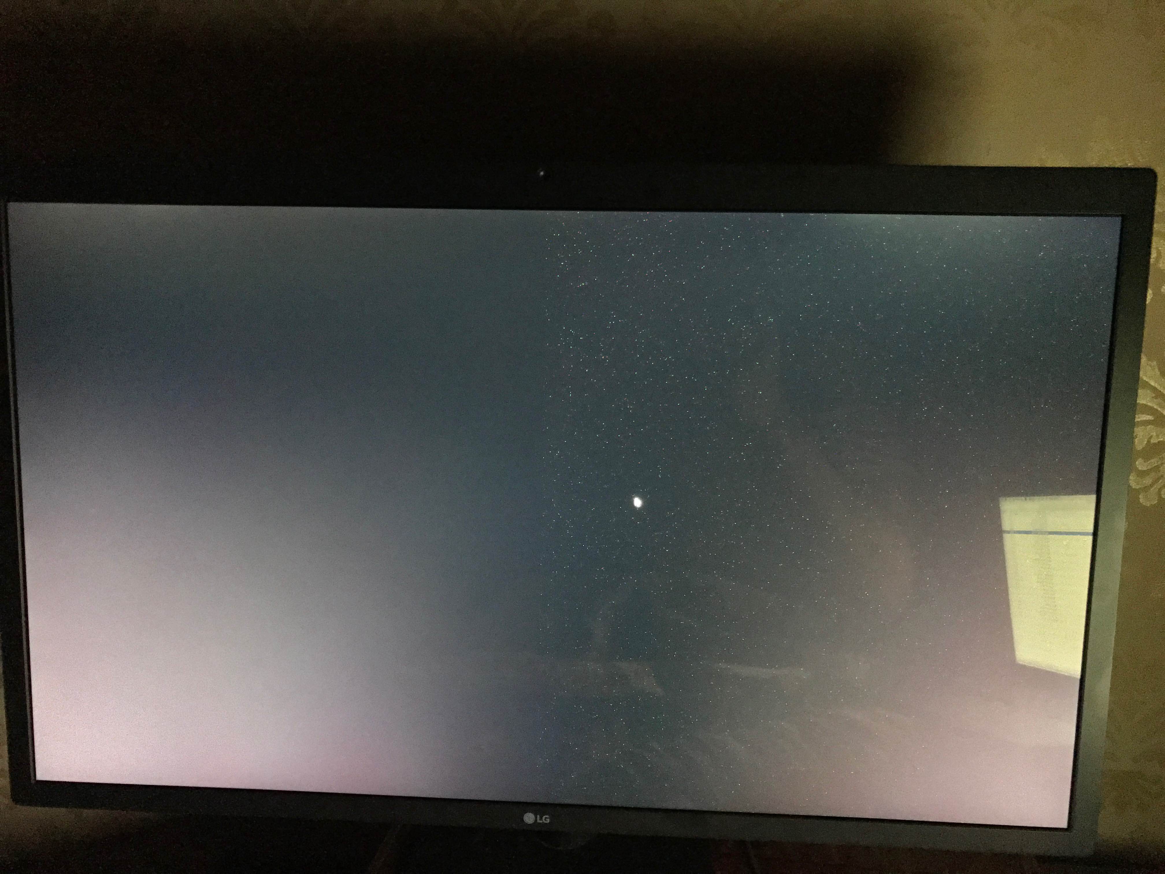

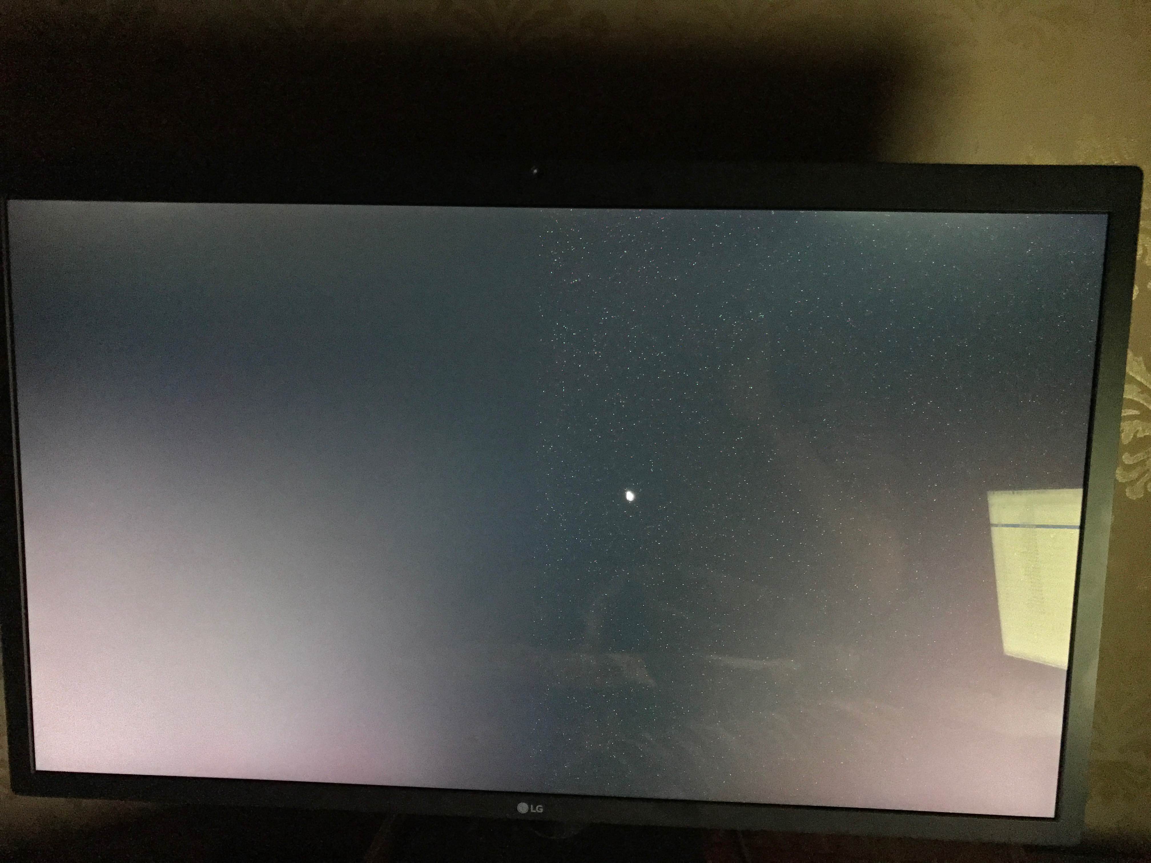

Im facing an issue with my LG UltraFine 5k which i bought on the 12th of January, the issue is the Pixel flickering on the entire right half of the display (It's like random pixels are flashing red, green, blue and white. Mostly noticeable on black backgrounds.) and it is continuous and it is been happing over a month now. I attached a picture of it, does any one faced this issue or have an idea how to fix it. I already bought a new thunderbolt 3 cable and try it instated of the one came with the display but no changes.
Seems unlikely it would be the cable. The fact that is only happening on half of the screen might point to a problem with the graphics card since 2 streams are being sent. Is there any way you can test on a different monitor?

Try some testing on other systems if possible.
Send for fixing if still occurring.
I tried another monitor a Samsung through HDMI Cable and it's work just fine.

Thanks for mentioning that i tried to connect my brother's MacBook 15 inch w/ touch bar and still the flickering is going on. seems the problem with my monitor, i will contact LG support to sort this matter.
