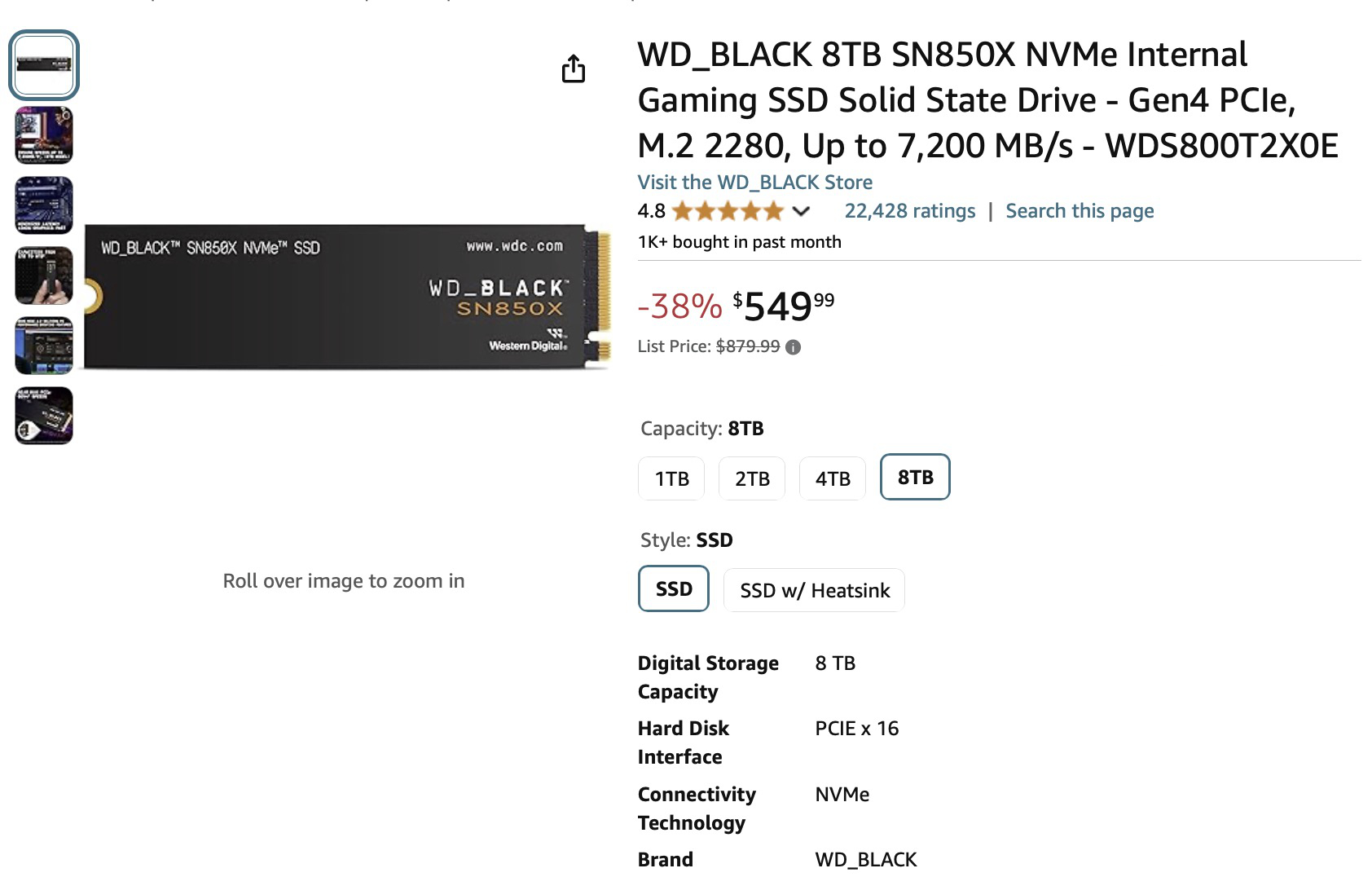

That was quick, out of Stock now...
@Fishrrman I have checked the link for the Sabrent also, and the WD SN850X is the most compatible for Mac...not only 450 Bucks less... so you have some bucks left for a Thunderbolt Case as well...

wow price difference between the WD and Sabrent is crazy! The sabrent is about 6000TBW vs 4800 for the WD but the WD has higher IOPS and speeds
Good to know for the future. Especially regarding compatibility with Mac!
