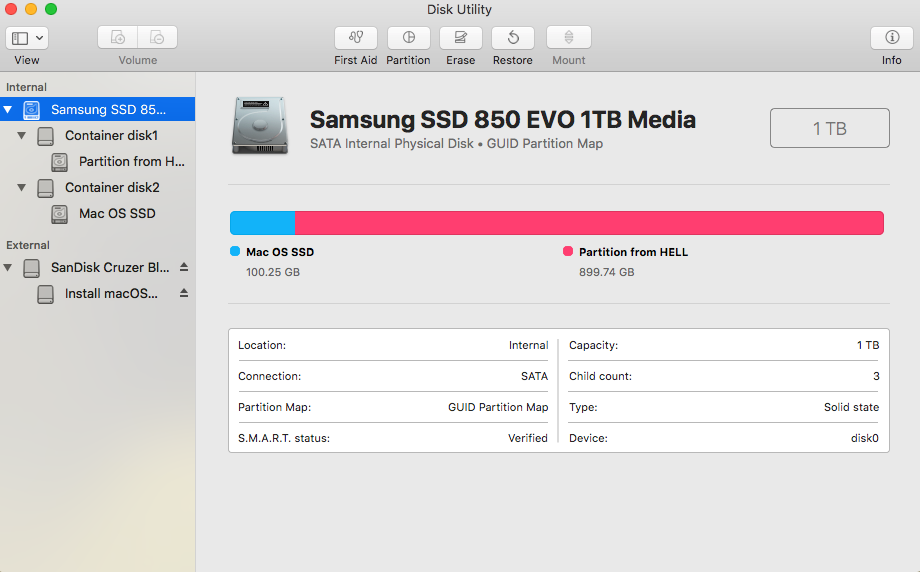

I bought a Mac Mini 2012 (i7 2.3GHz/16GB/1TB) with 1TB SSD as the sole drive. The Mac Mini I got came without any OS but the seller was kind enough to send me High Sierra on USB and I installed it. At install, I noticed the 1TB SSD was partitioned into 100GB and 900GB sections. (Pics below)
Continuing on (with PC thinking...) I ran the High Sierra install successfully and have an operational Mac Mini, that is, until I tried to download all the extra content for Logic Pro X. Logic Pro X sound library is large! Logic Pro X wants to live on my 'system drive' (100GB) but 100GB is not big enough, so I've gone through many, many forums reading on how to fix this issue.
I'm new to, and a little intimidated by Apple, SSD re-partitioning, or SSD formatting and am hesitant for fear of making a small problem into a much larger one. I've read an awful lot on APFS, SSDs, OS installs and I'm frankly overwhelmed at this point. I've already erased the 900GB partition but can see no pie graph with which to change the size of any partition. Maybe I'm barking up the wrong tree?

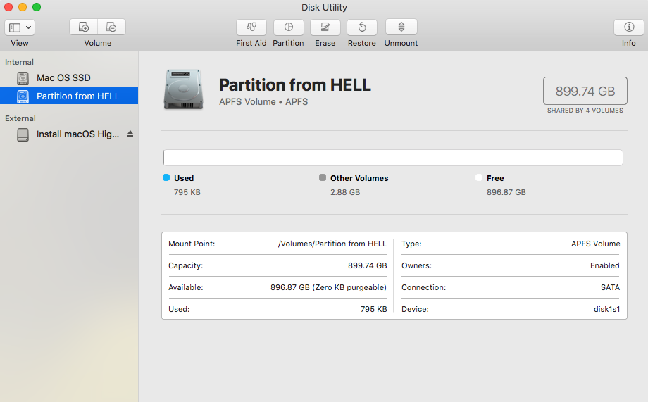

It appears I was a little challenged by the UI layout and could not see the " - " displayed for delete partition functions.
With my wired Apple keyboard I've firstly 'erased' the 2nd partition, 'erase' is something I had done a few times.
Secondly I've used the Volume " - " function to 'delete' that 2nd partition.
In the spirit of not going crazy with Disk Utility as you rightly point out, I'm again a bit stuck.

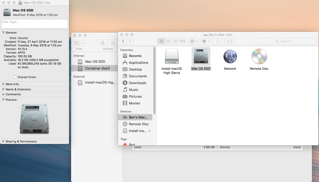

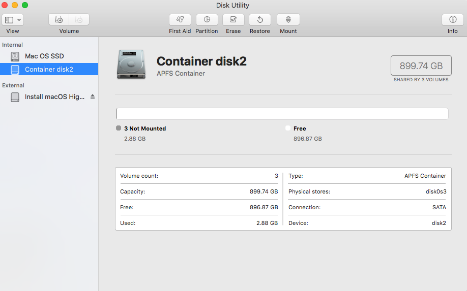

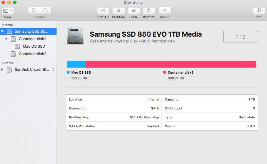

What I'm left with appear to be 2 'containers' now, 100GB and 900GB respectively.
I can't find any reference to containers in anything I've read.
Is this SSD still partitioned?
Surely I've missed something. I'm a little baffled by this, but so close.
There must be another step I'm missing to get this drive to show as a single 1TB SSD...
i have read about resizing the first partition in the pie graph, but making this 2nd 'container' disappear first...
There may be some clues in the final pic, not sure.
I can see container 2 is not mounted and that I now have a 100GB system drive, but don't know where to go from here.
Any help greatly appreciated and thanks again for your reply campyguy.

Thanks for the laughs, don't be frustrated or self-deprecating - the fairly new Logical Volume bit is pretty new to most of us and IMO a bit of a work in progress. And, the HS version of Disk Utility completely changed its look and revised its feature set and re-added functions that had been removed from the El Capitan and Sierra versions of the Utility app, with "volumes" being easier to access with APFS.
Simply put the hard drive can be left with one "volume", and viewed (figuratively) as a single partition. The drive can then be "divided" (figuratively) into either "partitions" or "volumes/containers". The former - a partition - is what older people like myself think of immediately, and in HS a partition can be formatted in a Mac or Win FS format. A volume/container is similar, in vein, to a partition in that it can be initially sized and formatted in one of the four APFS formats but not in NTFS or exFAT (AFAIK, that is).
The main advantage of using containers is that APFS can/will dynamically allocate storage needs, pretty much hands-off as opposed to needing a disk utility to change partition sizes.
From your screen shots I can't determine whether the "container disk2" container is a partition or a dynamic container. If I were you, I'd use the macOS Recovery option to start over, using the Recovery's Disk Utility to nuke the drive and start over, then install HS. I have a bunch of 2012 Mini Servers that all have single or dual Sammy 850 Pro SSDs, and I always start with macOS Recovery - using Option-Command-R on my personal unit and the 3 that already have HS/APFS installed. I've used macOS Recovery several times and it's stupid simple to use.
Looking more into the advantages of APFS and multiple volumes/containers, one bit I like is the ability to encrypt a container independent of the other containers - storing sensitive data in that container makes sense, in a good way. I'm accustomed to carrying two portable SSDs that need my thumbprint and a couple of Yubikeys, all stashed in a safe mounted in my Benz, I'm not ready to give this feature a try just yet. I'll be around this weekend, keep us posted! Cheers!

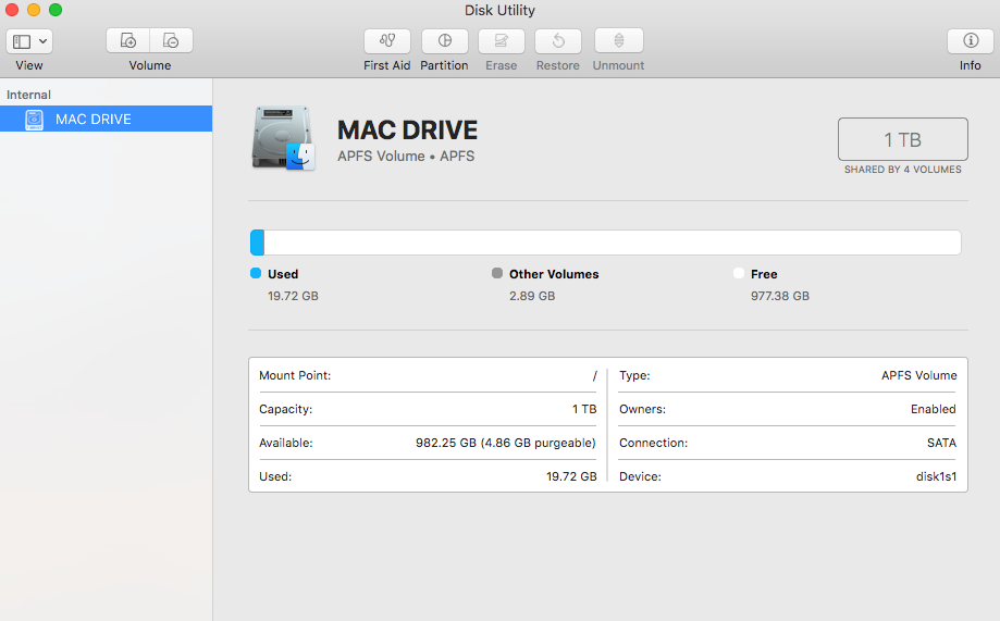

A pic's worth a thousand words....
Cheers, Ben.
