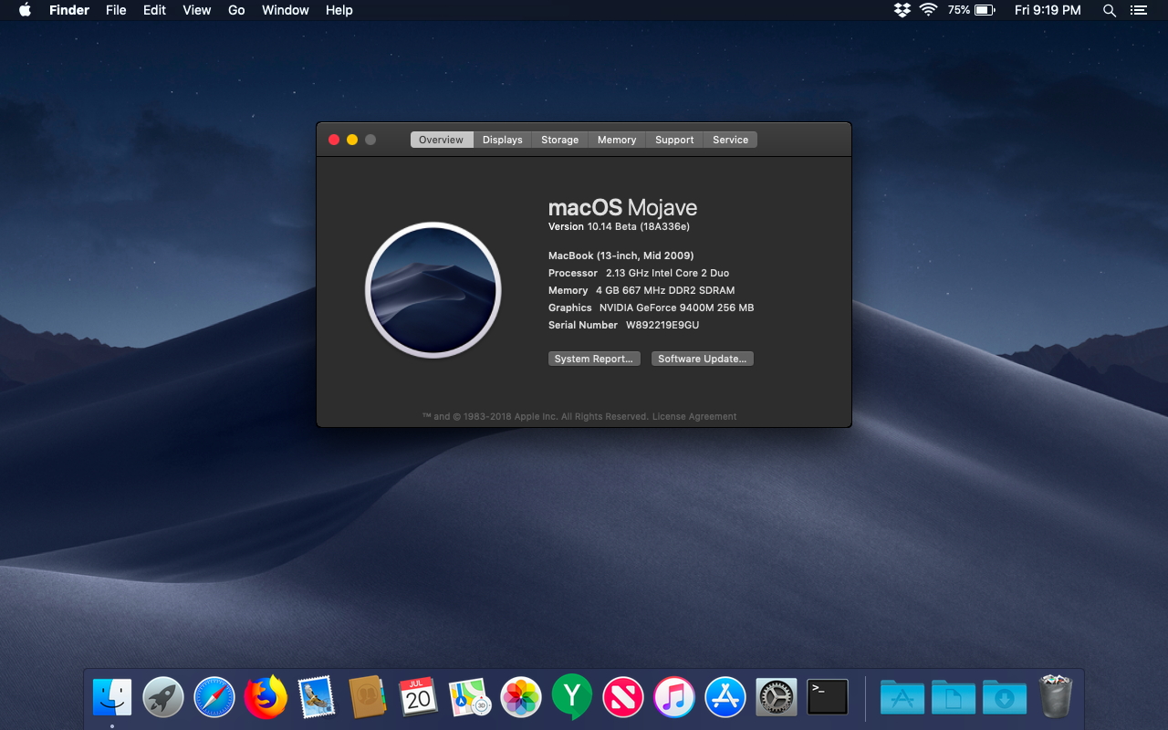

Checking in with a successful install on my MacBook 5,2! Slight graphical artifacting on window shadows, but perfectly ignorable. APFS didn't seem to be working either. Didn't look into it, just switched back to HFS.
Same situation with my 5,5 Macbook Pro, artifacting with my GeForce 9400m 256mb and APFS doesn't work, everything worked fine for the installation part but, I just got the white screen after. The APFS volume is not being detected by the maschine.

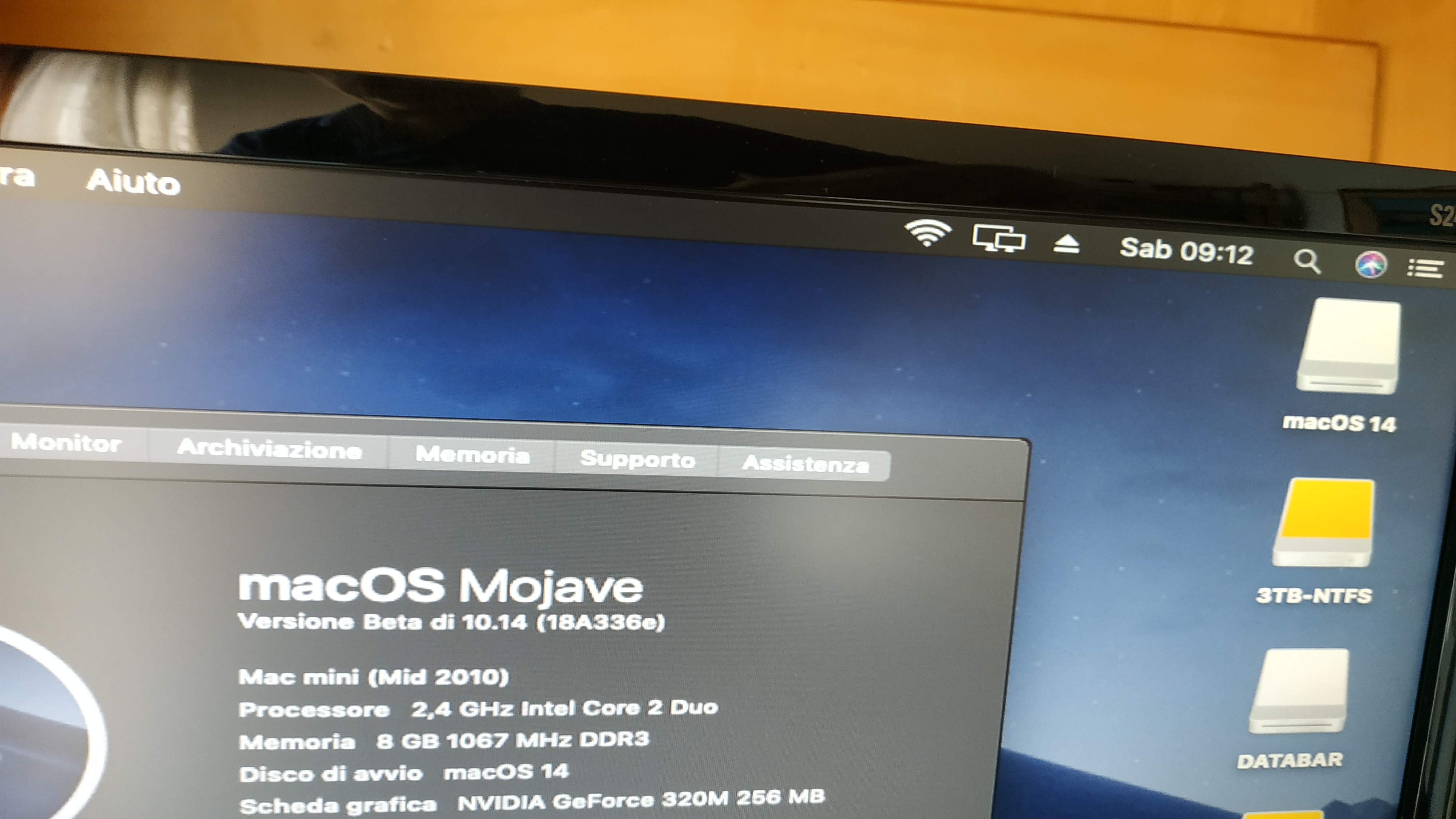

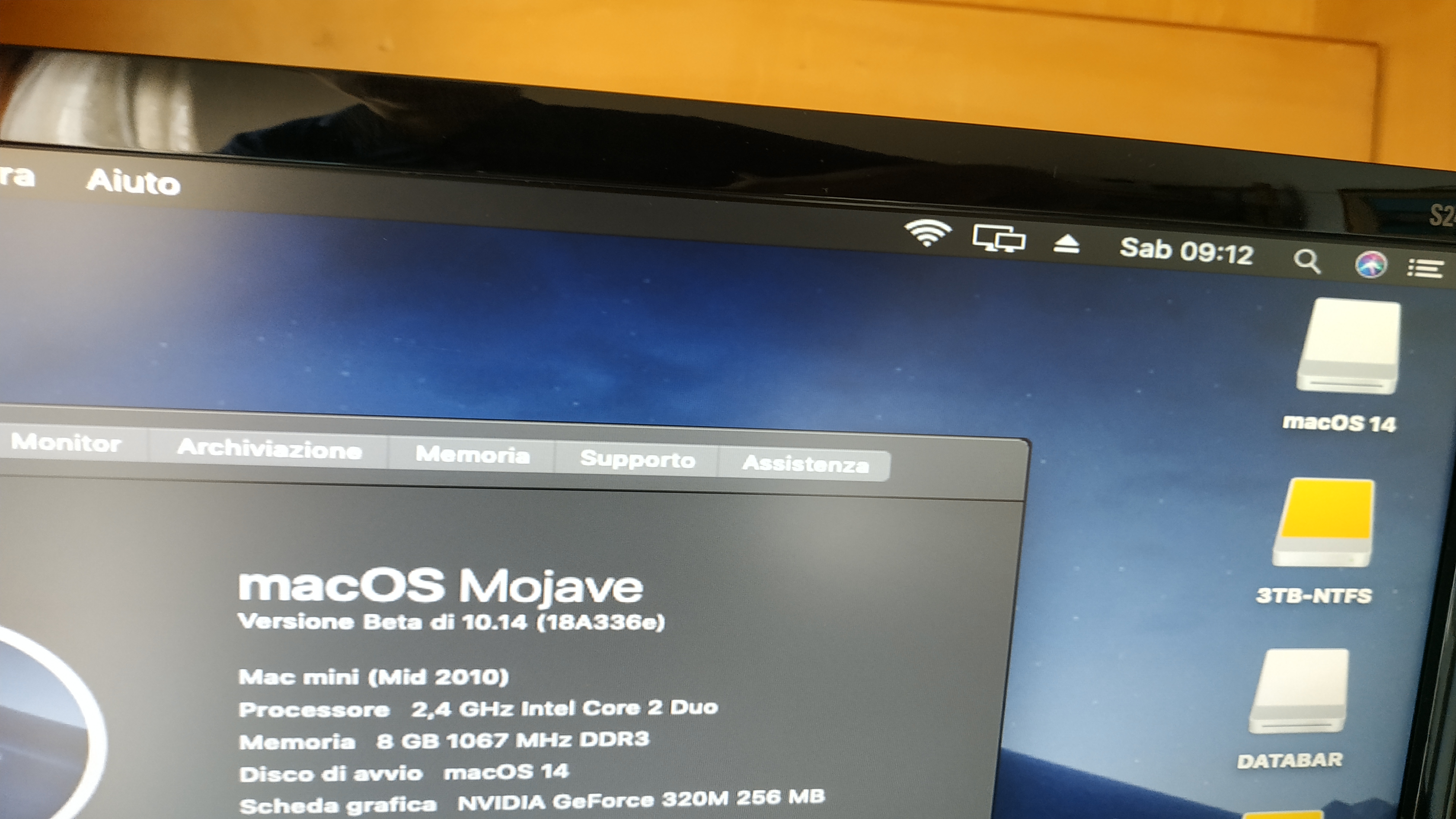

I have just completely reinstalled macOS Mojave beta 4 using patcher b12. Now my Macmini 2010 (macmini4,1) is very fast (before there was big vertical moving bands on screen and was slow) I think acceleration is active, but still I can only use 1024x768 resolution. Do you think is could be because I use a VGA adapter instead of HDMI connection? With Hight Sierra it works fine 1920x1080 @60 Hz.
