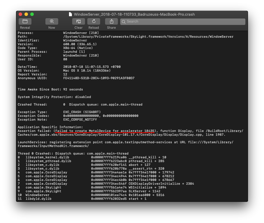

Congrats for Tesla users, that aren't Metal capable graphics.. but luckily (forced) Mojave-Supported #LoL
I hope, you won't get a same issue as my Fermi graphics since Beta 2 upto 4. Let's have fun together. 🙂
And if you try to replace /S/L/PF/Skylight.framework from Mojave beta 2 or High Sierra?
Another attempt could be, maybe it won't work, but try also to replace IOAccelerator from Mojave Beta 1, I notice it is a framework required mainly by Nvidia GPUs and the previous version of this other framework was smaller in size, maybe containing less new Metal coding, it's just a supposition.
I still do have a Mojave beta 2 internally on another supported machine (the one from which I upgraded my external SSD Mojave beta 4 to use on MB7,1), I will upload the previous Frameworks for you, hoping that will fix your Kernel Panic.
edit:
I'd suggest to use the technique I did for telemetry.plugin, try replacing one at once while possibly leave the other untouched. Maybe is only one of them, or both, or no one.
This is a complete untouched /S/L/PrivateFrameworks/Skylight.framework taken from Mojave beta 2. Give it a try.
Maybe also a previous Mojave beta2 /S/L/Framework/InputMethodKit.framework could be required to luckily fix Legacy Nvidia Fermi Metal API requirements.
I would exclude CoreDisplay.framework since even on a working Mojave beta 4 booted from MB7,1 Nvidia Tesla, I still get many CGXDisplayDriverInitialize errors in Console app, but it's working fine anyway.
But maybe also replacing CoreDisplay.framework could be a good attempt.
Also waiting for an ASentientBot's opinion would be very useful since he fixed the QE/CI on Legacy Nvidia Tesla.
