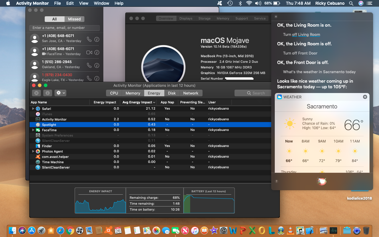

Hi guys, right now my MBP 7,1 running very well but I've always want to add Handoff/Instant Hotspot/AirDrop features, are these my best choices that will work with Mojave B4 (Iogear GBU521 , GMYLE bluetooth Broadcom BCM20702, Asus BT-400). Thanks.
