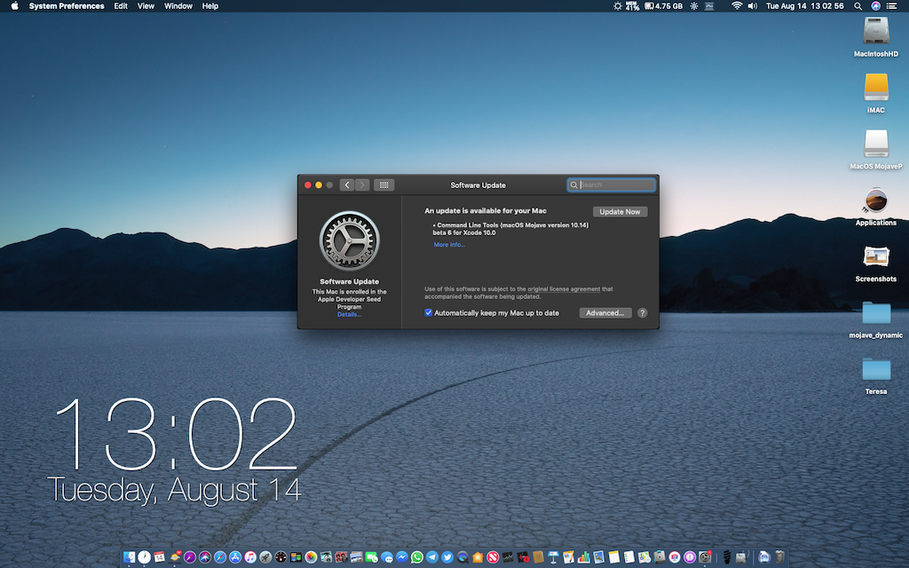

Well I can say that this software update issues was a well hidden Apple gotcha but we are a good team on this forum we figured it out 🙂
[doublepost=1534277183][/doublepost]here is further proof the the software update works as it should 🙂
a beauty and I love that full screen clock...

the desktop clock is from a app called Live wallpaper by squidmelon it has some themes but I use the metro theme as you can change the default wallpaper 🙂
