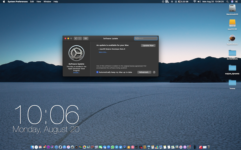

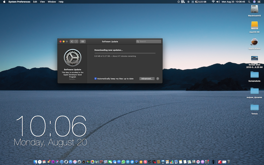

macOS Developers beta is out 14018

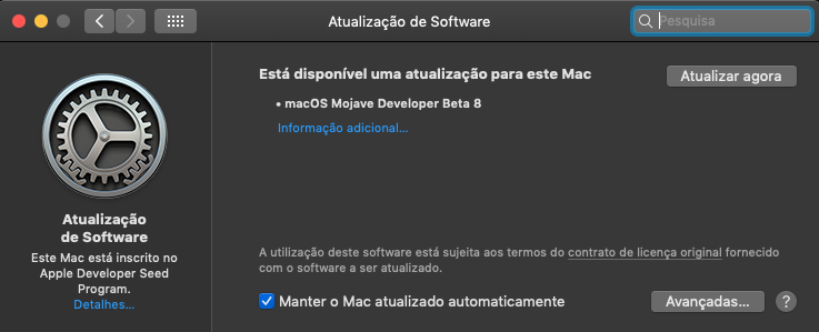

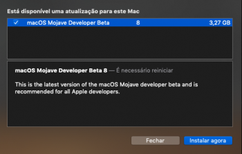

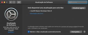

Changed to APFS file system and I just received the update... Nice!

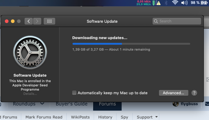

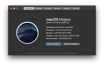

I am in Europe with a MBP 2011 and just received the update. Downloading...
Installing now. It's just 3 GB. I'm excited if it works this time..
Reactions: TimothyR734

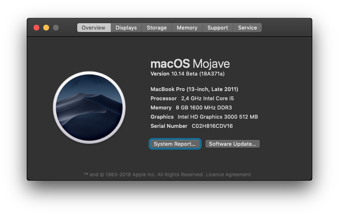

Worked like a charm this time..
[doublepost=1534787218][/doublepost]Oh, glitches remain the same btw..
