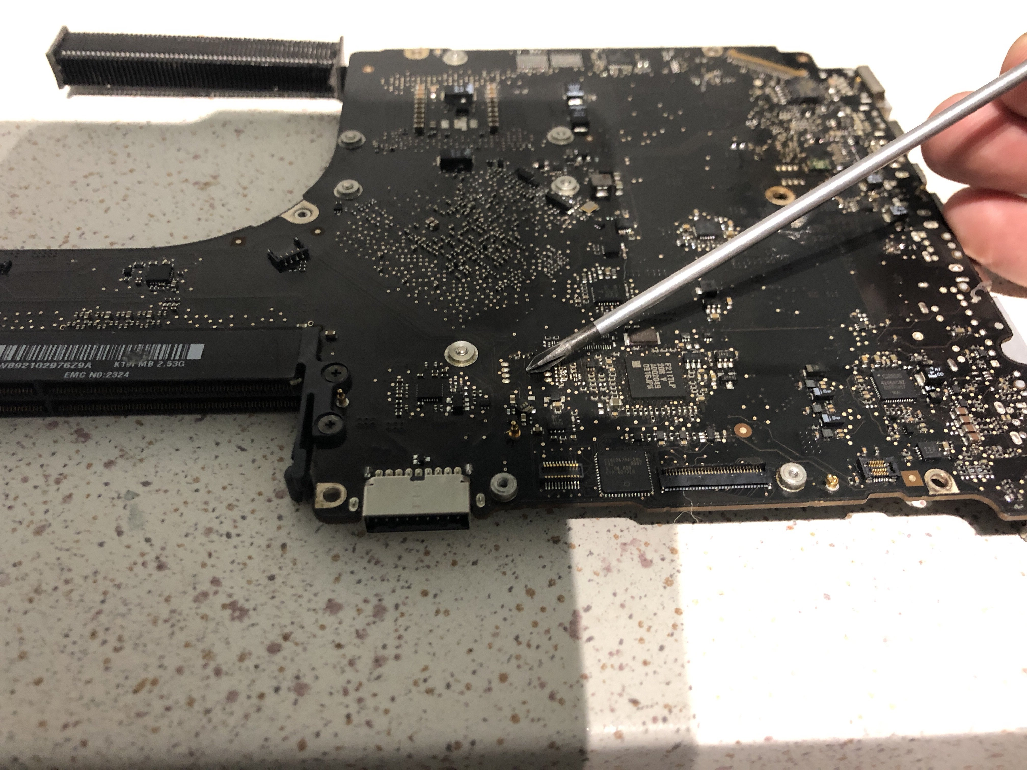

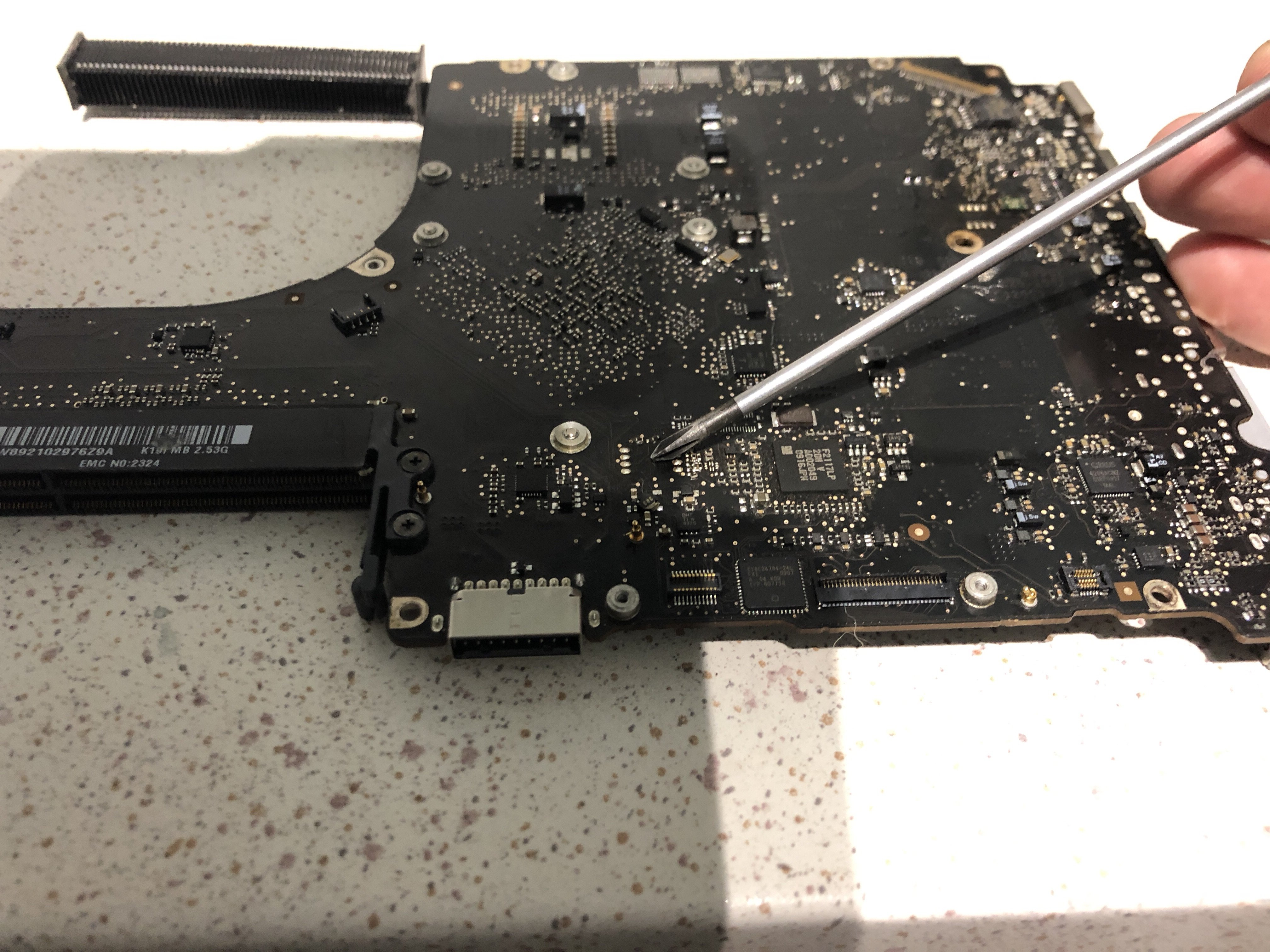

You're right. I was just checking on his board and it is the same as mine A1286 (i posted previously) so the only way is for @videotape74 to open his box. Can you give him some tips on where it would be located - I think it's located on the reverse side but not sure.
Edit: I think flipping the board may only be valid for macbook's. macbook pro eeproms should be located on the top right? the diagram worked for me so I never opened my laptop.

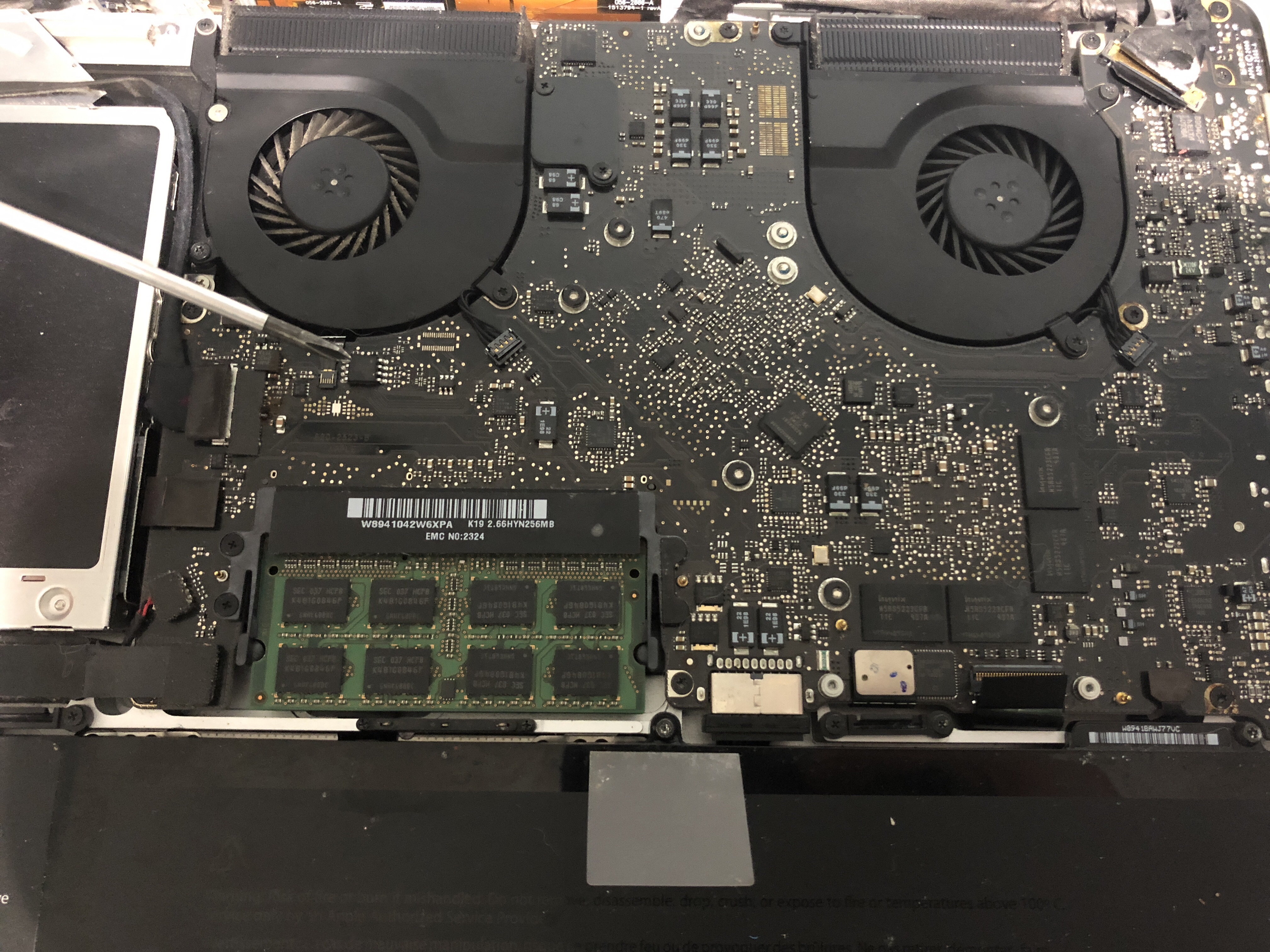

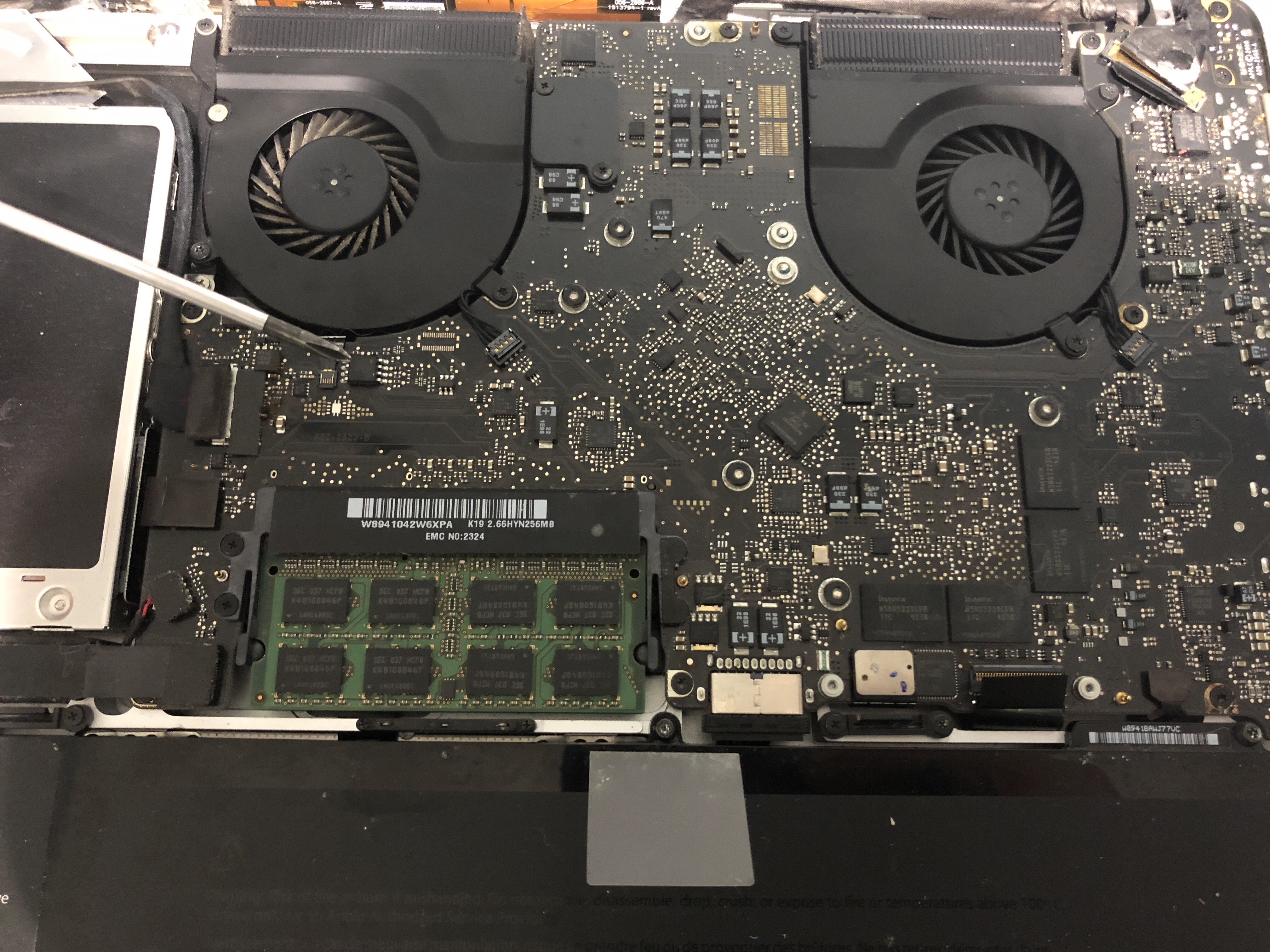

I’ve opened mine . You don’t have to remove the logic board . Least I don’t think so or I’ve been looking at the wrong thing in which case whoops
Reactions: TimothyR734
That’s a 5,3
[doublepost=1534713038][/doublepost]5,5 is that board . I’m open to correction
[doublepost=1534713115][/doublepost]The twin fans is 5,3 the single fan is 5,5

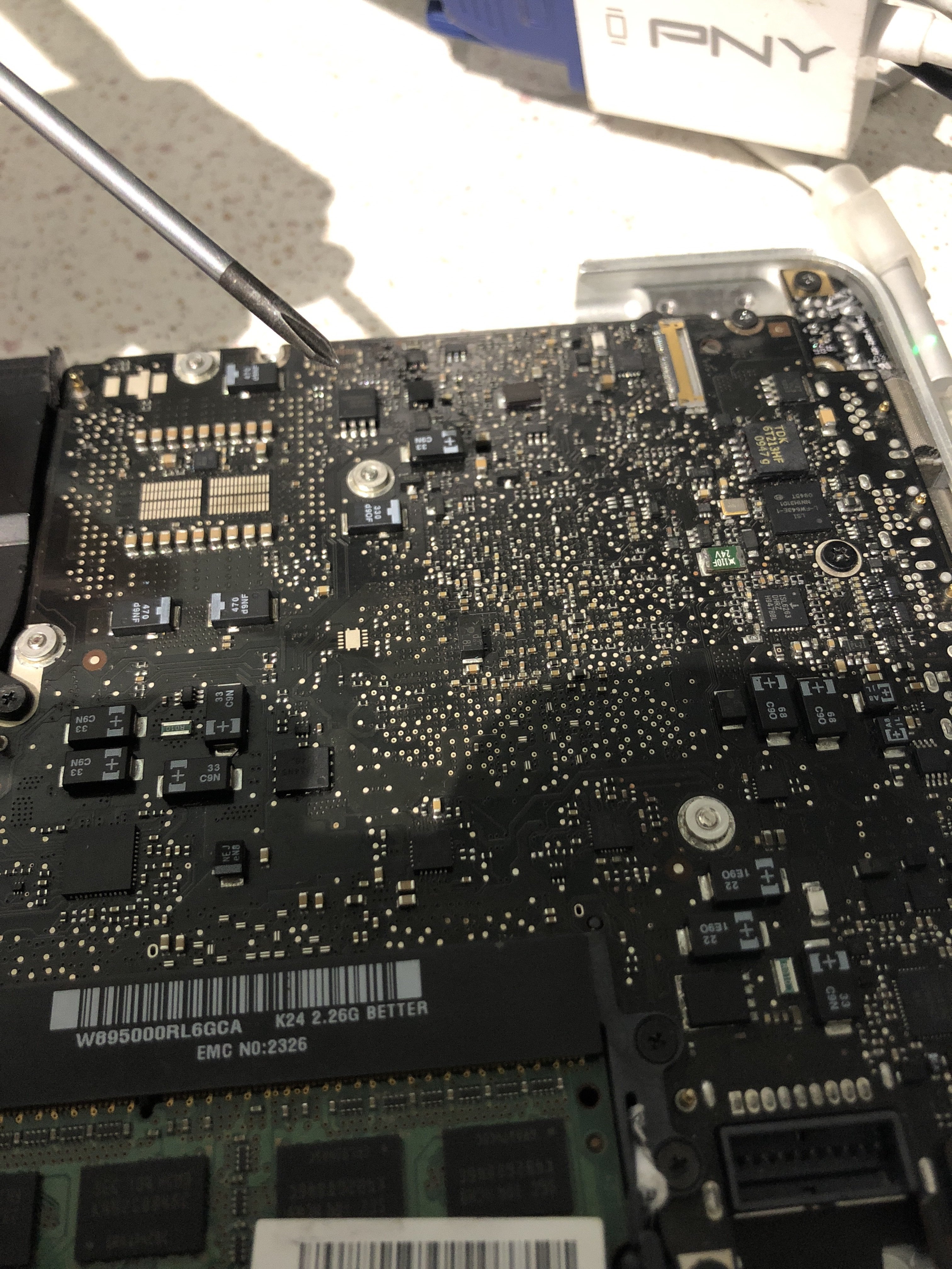

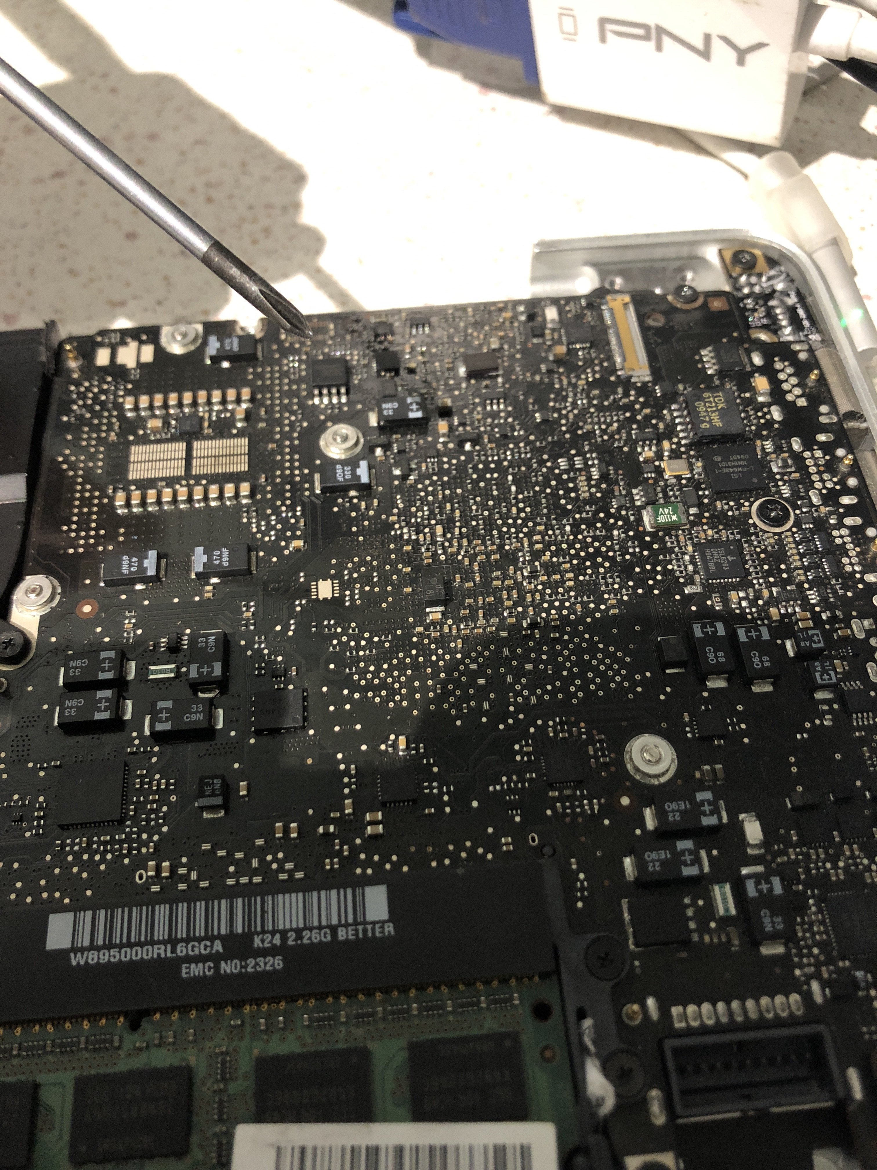

The board on its own was a 2009 2.53 ghz which I think was a 5,4 . It had the 25L3205d chip but it’s best to check . I’d another 2009 that had different one .
