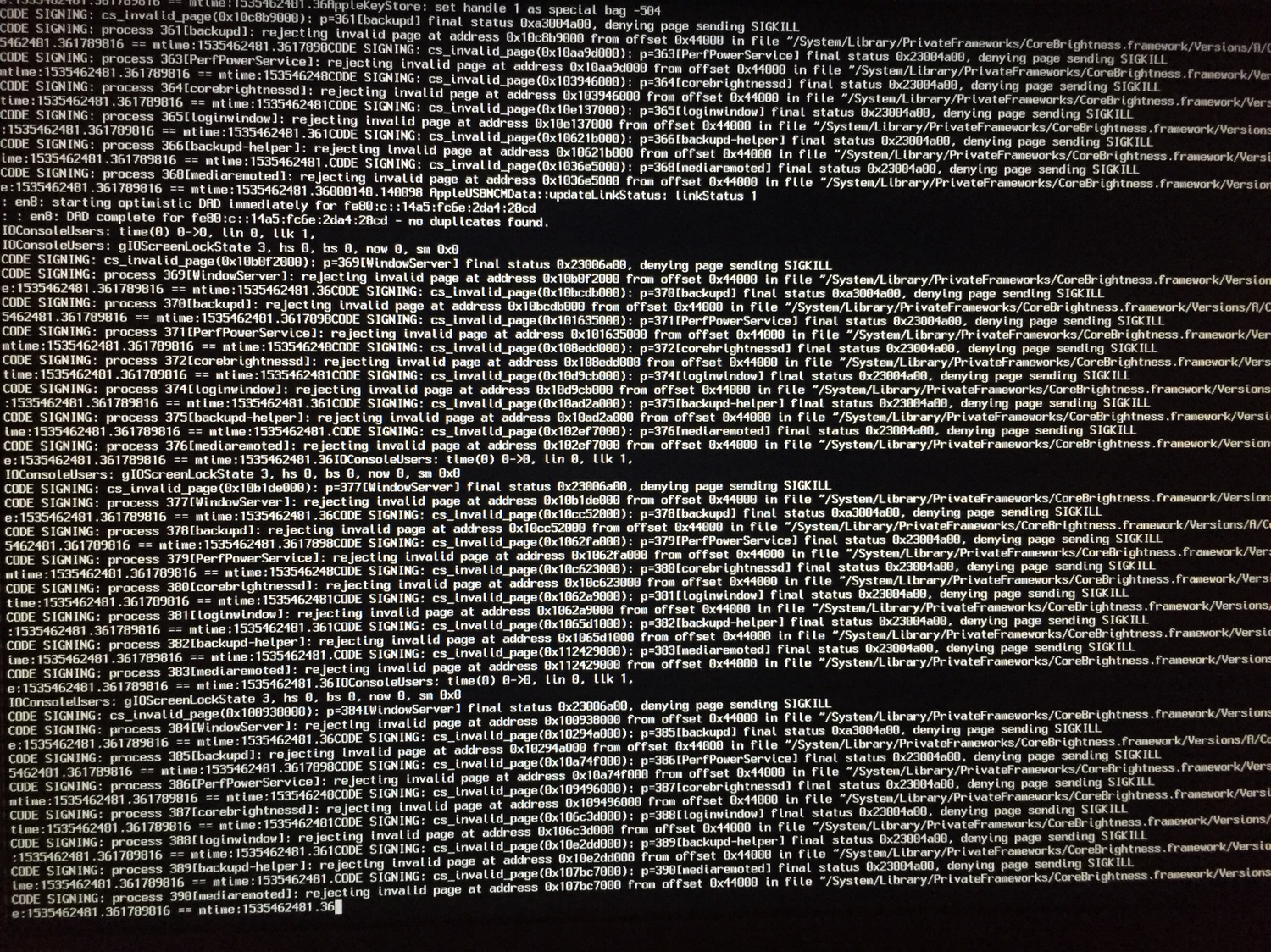

... after reinstall night shift, what can i do?
Boot from your main Mojave volume disk (NOT Recovery or USB Installer) in single user mode holding CMD+S after power-on and try these steps:
[Probably since your main disk is Encrypted you should authenticate at the FileVault 2 pre-boot login/password before enter in single user mode, anyway after power-on keep holding CMD+S until you see a grey login page]
fsck -fy
mount -uw /
rm -R /System/Library/PrivateFrameworks/CoreBrightness.framework/Versions/A/CoreBrightness
cp -R /Users/YourUsername/CoreBrightness-backup/CoreBrightness.framework/Versions/A/ /System/Library/PrivateFrameworks/CoreBrightness.framework/Versions/A/
reboot
in this way you should boot Mojave at least in GUI mode, from there replace through Finder only this file I attached: NS Patched CoreBrightness binary exec
fsck -fy
mount -uw /
reboot

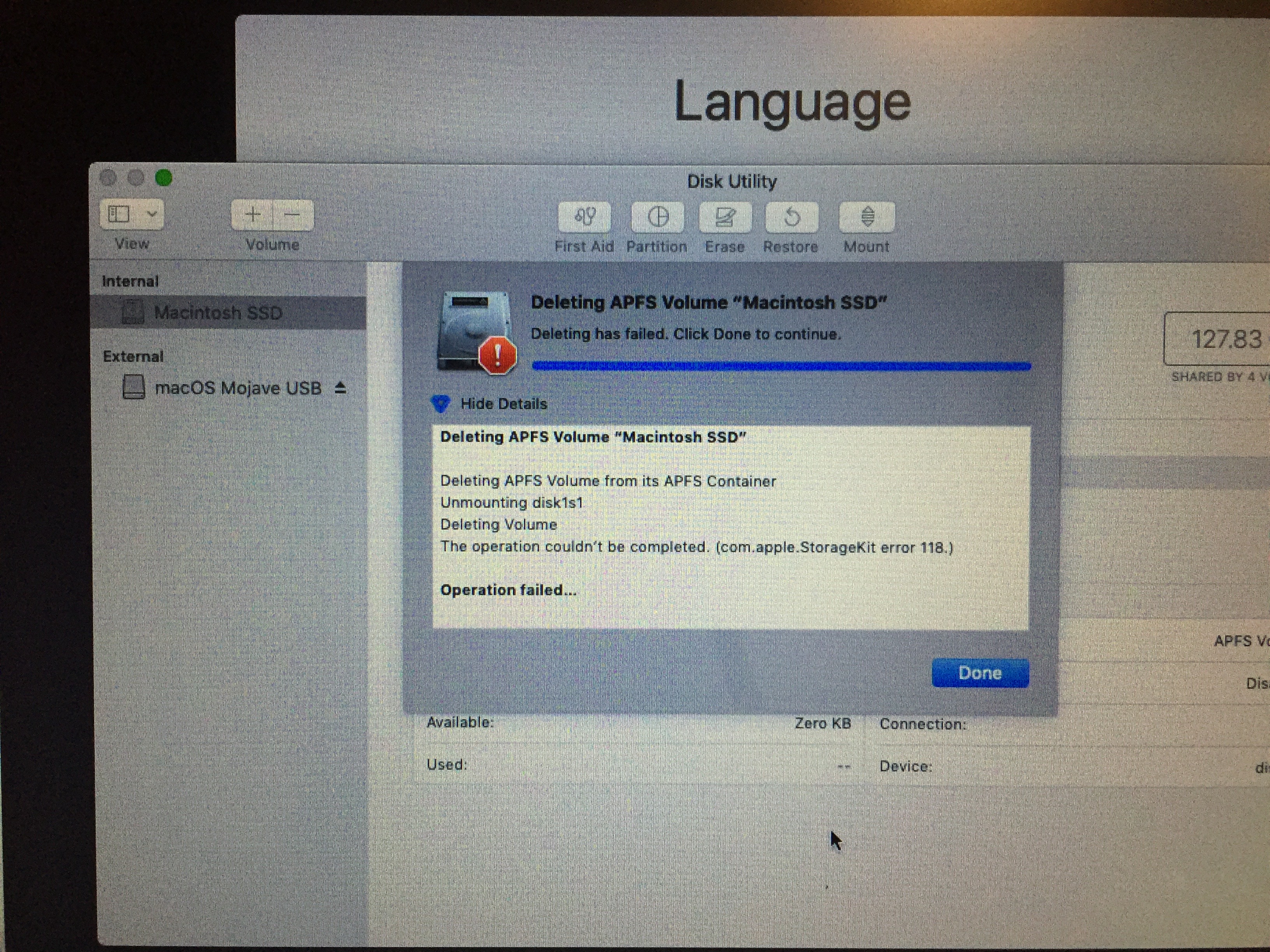

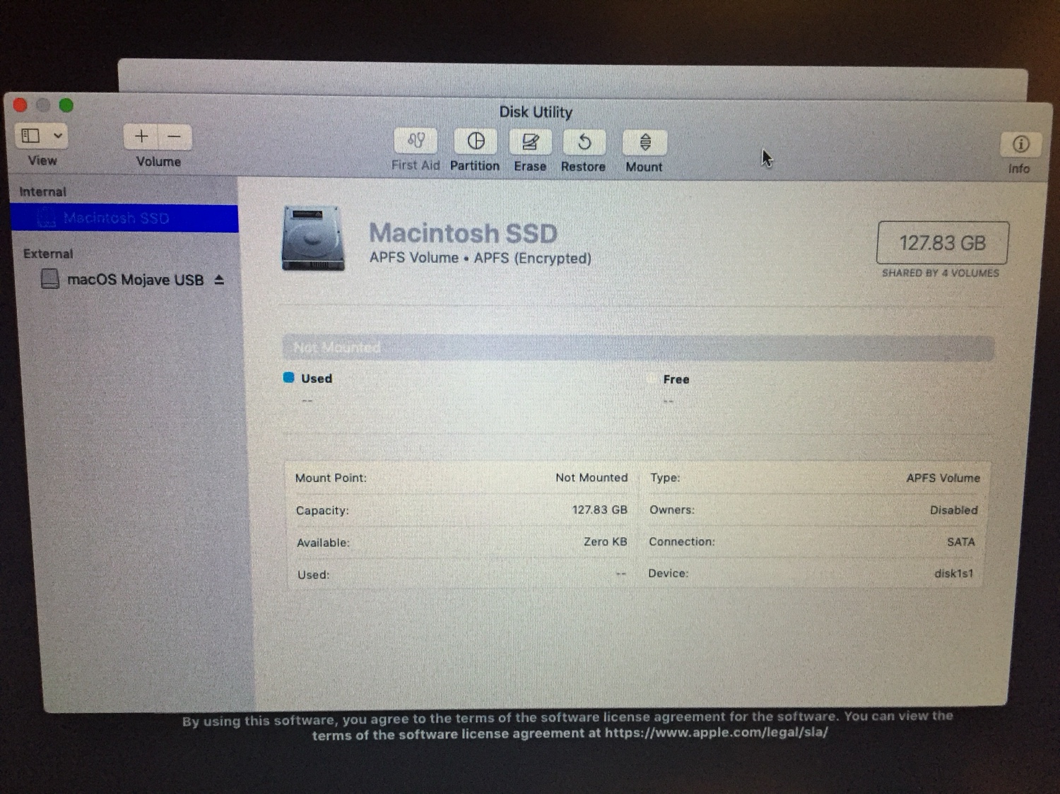

Thanks! You are amazing 🙂 It works great 🙂
One more question, how to format my drive in the future? APFS (encrypted) and when I do not have a password for FileVault2? (Deleting has fail)
