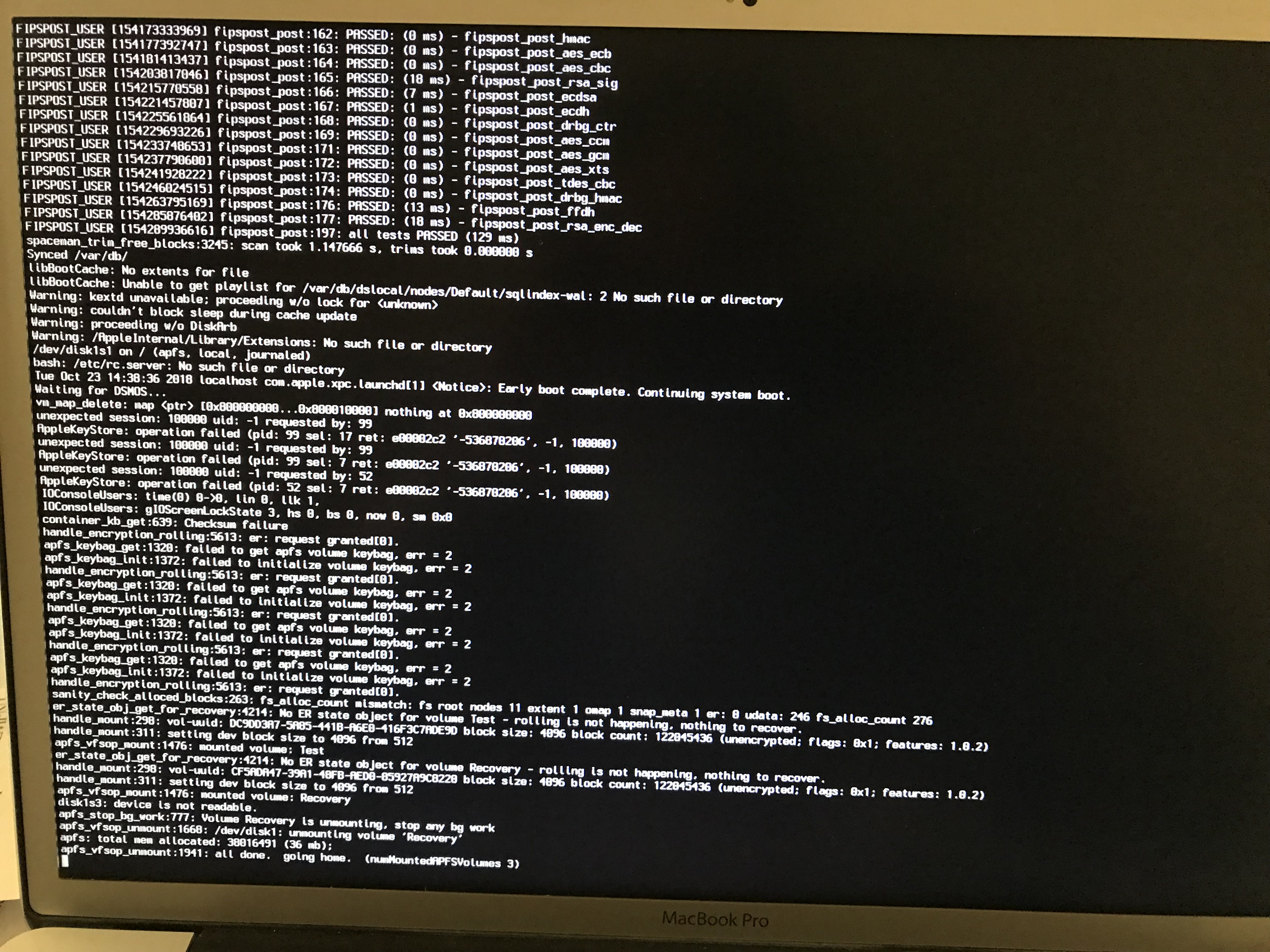

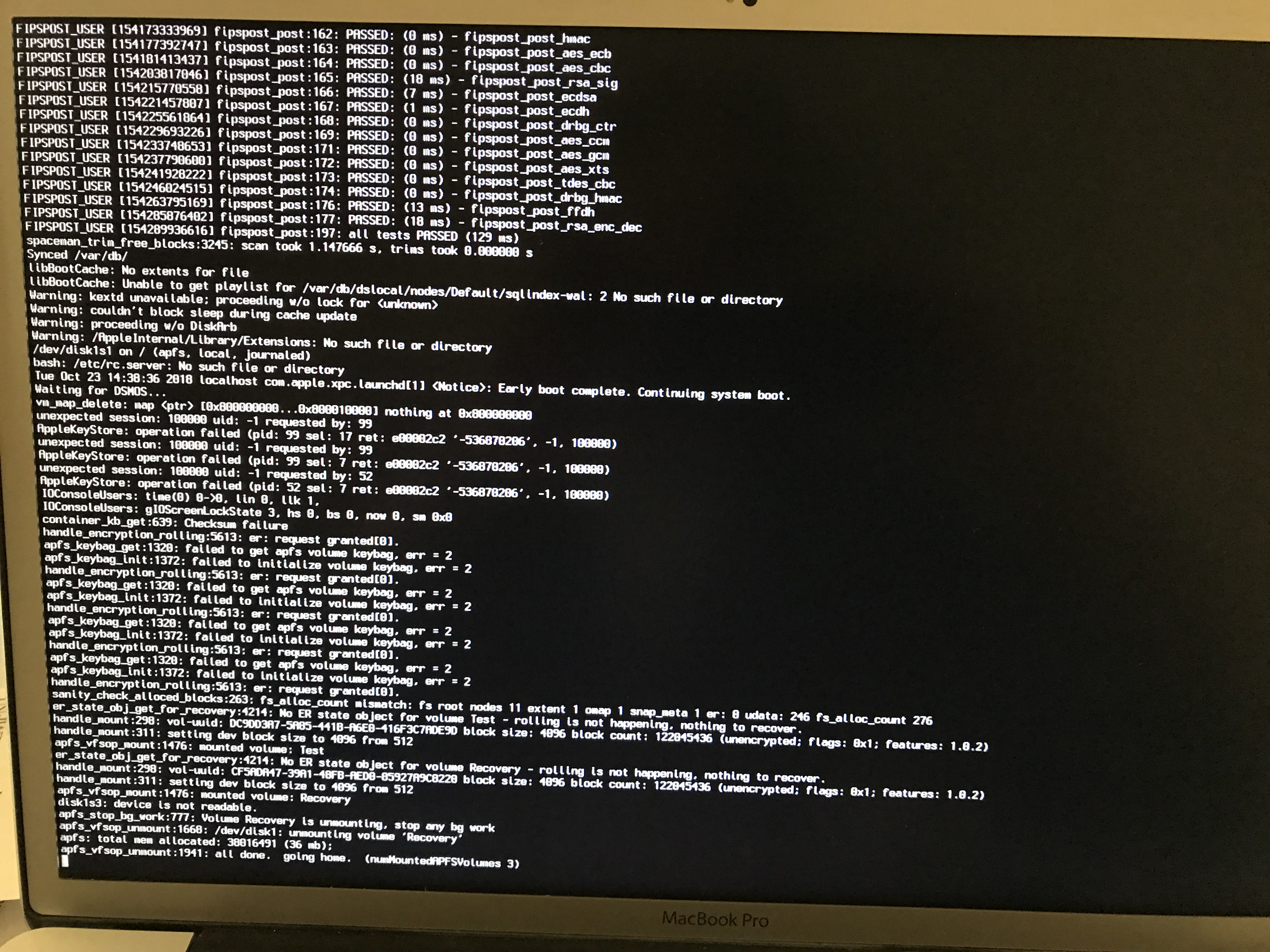

MacBook Pro 5,2 - 17 inch, C2D - hybrid Segate Momentus HDD, formated in APFS. Running 10.14, original release.
Attempted to update 10.14 with each Mojave beta release, but to no avail. I did apply dosdude1's patches.
Betas 1 - 3 updates resulted in boot-loop; no discernible fix worked, other than reinstalling the system.
Betas 4 - 5 updates, would proceed to "full" progress bar, but would stall at that point.
I managed to boot into the Single User Mode, after an attempt at beta 5 install, and took a photo of the screen when progress in beta 5 installation stalled. See attached file. Examining the trace reveals, that "initial boot" completes, but progress stalls at APFS handling routines (?)
Reactions: TimothyR734

Looks like something got corrupted (checksum error), maybe try:
- Recovery mode, Disk Utility, First Aid
or
- Single user mode, fsck -fy

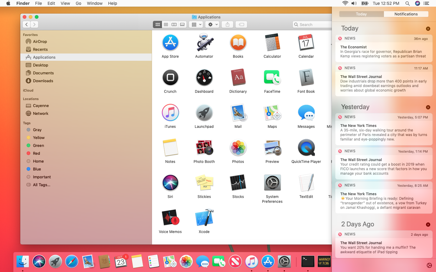

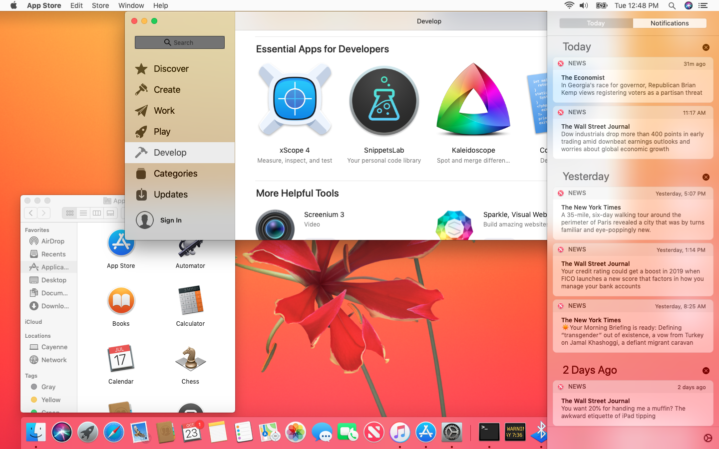

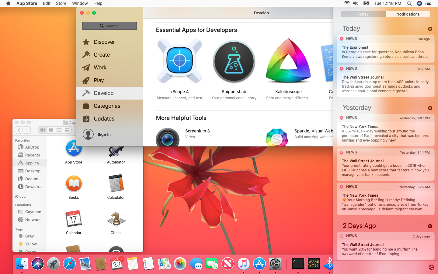

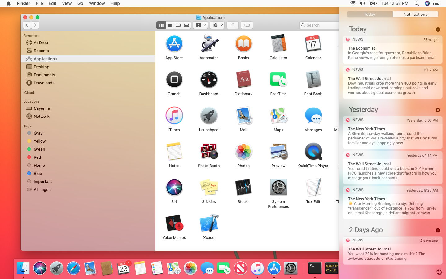

All - Mojave Hybrid Mode v1.0 is released (for Mojave GM)
The screenshots should be self explanatory, but this is a "fix" for our broken Mojave Light Mode. Search back for my original posts on this. You will find it here with notes and instructions. Read them carefully.
Lots of good people collaborated on this. So a special shout out to these collaborators :
@testheit @arqueox @TimothyR734 @ASentientBot @0403979 @webg3 and others...
View attachment 797799 View attachment 797800
Many more screenshots and details are available in the repo.
This is still an active project, so updates and support for upcoming Mojave updates will be coming soon. Open an Issue if you have a problem.
More documentation and a cleaner "scripted" installation will be available when time permits. Other ways of distributing are being explored.
NOTE: For the moment it is assumed that you know what you're doing and are fairly comfortable with the Terminal command line. If you are not, proceed with caution and ask for help: there are plenty of us who tested this to help.
Nothing here will brick your machine if you follow guidelines and make some quick backups (again - read instructions carefully) Ultimately, it always pays to know how to do things manually...
Do not use if you have upgraded to a beta - while it may be compatible it is highly unrecommended as each beta needs to be analyzed, patched and released. Going forward I plan on only supporting official Mojave updates, the in-between betas are too hard to track...
Enjoy (from the team)

I just re-read my manual instructions and notes and I think they are pretty clear. Just in case:
To get Hybrid mode appearance in the screenshots:
  • patch HIToolbox in /S*/L*/Frameworks/Carbon.framework/Frameworks/HIToolbox.framework/Versions/Current
  • patch CoreUI in /S*/L*/PrivateFrameworks/CoreUI.framework/Versions/Current
  • Use the GM 18A391 releases for both (the only ones supported even though I have a beta in the repo)
To get Flat mode appearance in the screenshots:
  • patch AppKit in /S*/L*/Frameworks/AppKit.framework/Versions/Current
Simple, I just re-tested the same procedure on my test box and It's all good. If you have issues, post a problem in the repo. Again, don't download the source archives! No need to, it's just github's way of packaging releases.

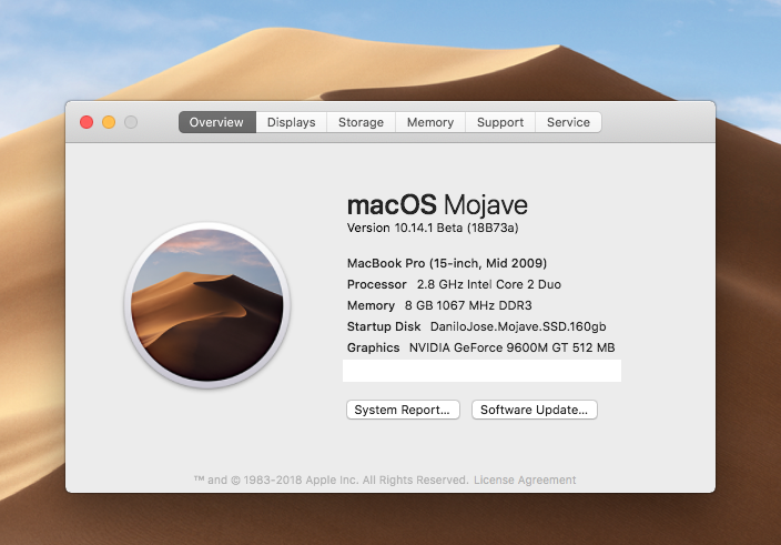

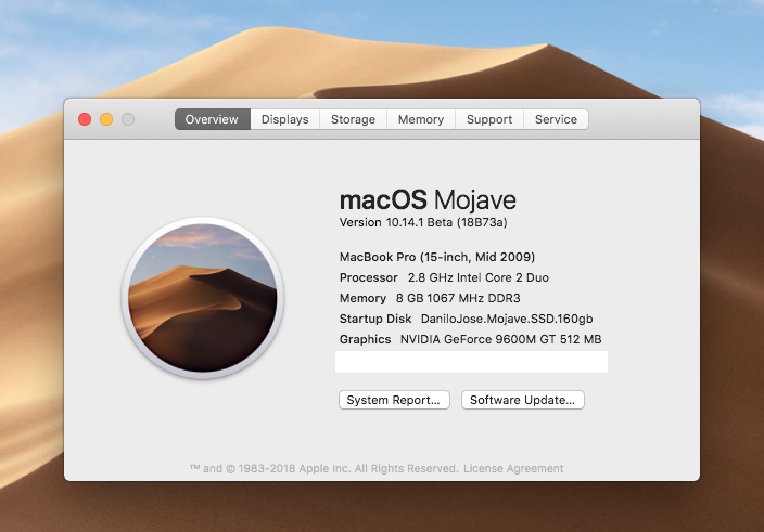

Mojave 10.14.1 beta 5 on my unsupported MacBookPro,5,3.
Successfully updated (OTA) and patched using @dosdude1's mojave patcher app.
Thanks to all who contributed on this thread.

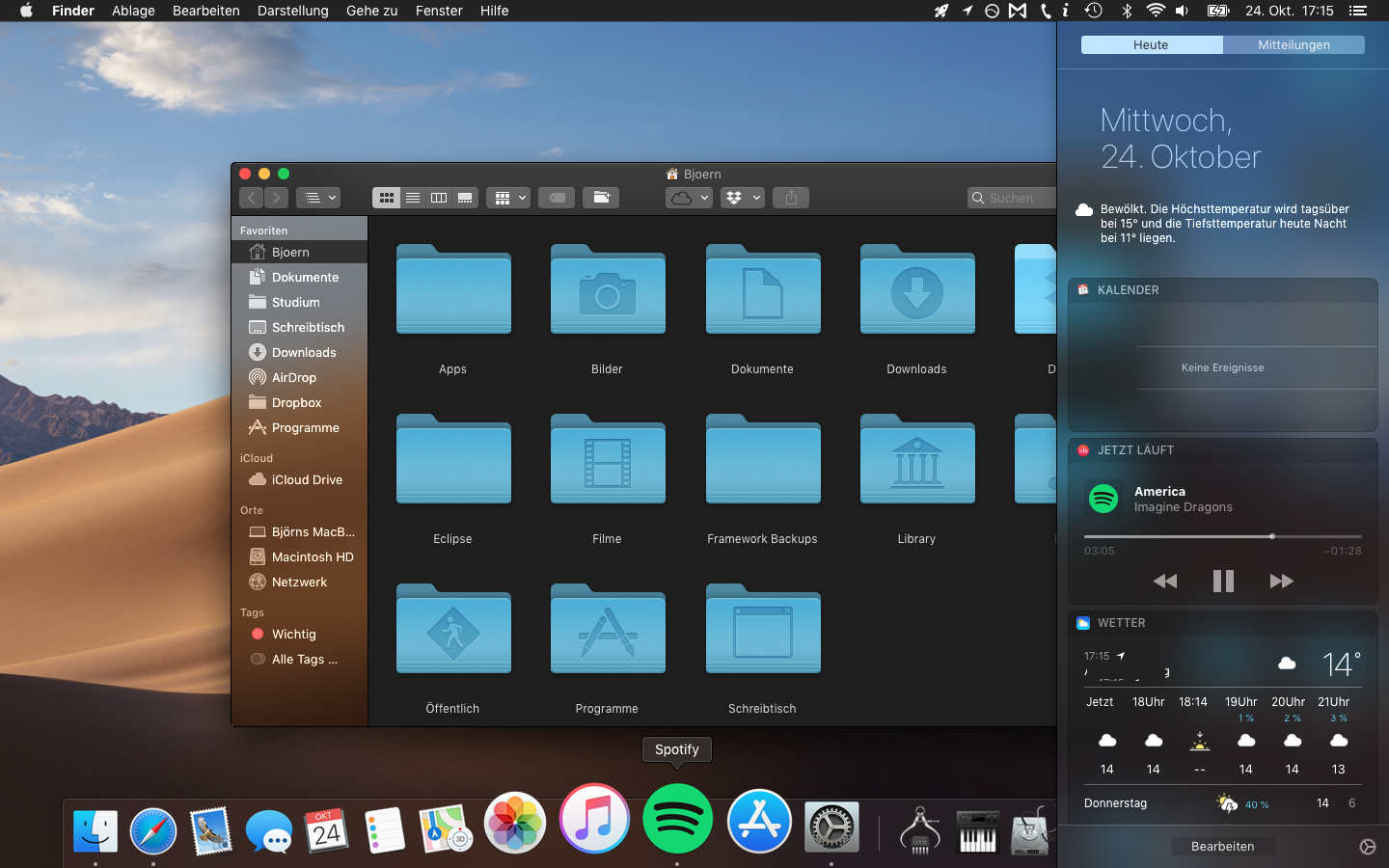

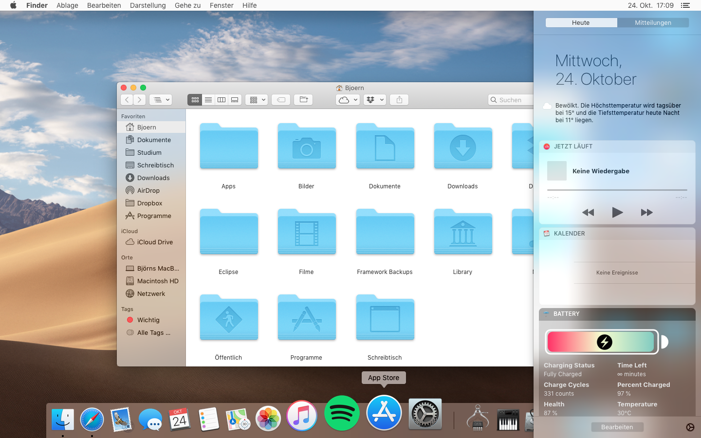

My dock did not stay transparent after a reboot 🙁
Seems as if this simple terminal command is not sufficient and the patch by @pkouame needs to be tested by me instead 😉

@pkouame
Juhu, I think you can add MacBook Pro 6,2 (15“ from 2010 with Intel and Nvidia graphics) to your compatibility list 😎
(Tested: Hybrid (CoreUI + HIToolbox))
Great work!
OMG!! Thanks Bro!!
With this Mod, my iMac Late 2009 become perfect right now!! 😀
I was applied Hybrid with HIToolbar and CoreUI only.
Thanks a lot!!!
